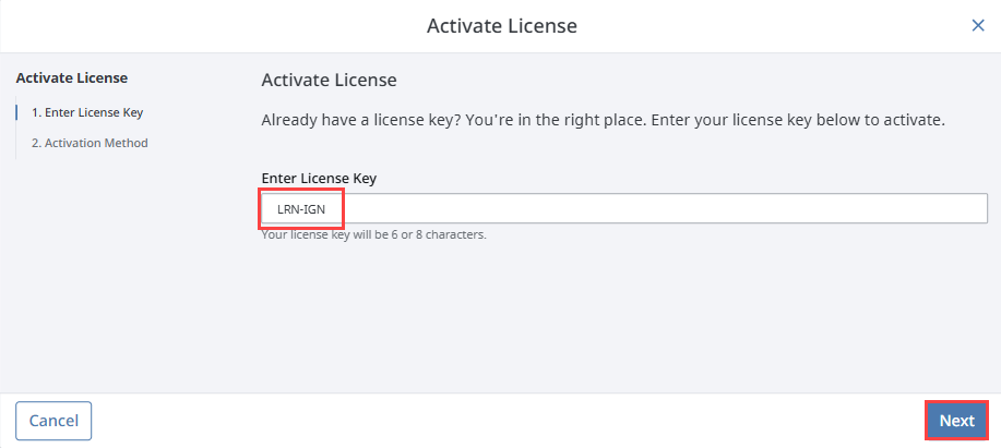

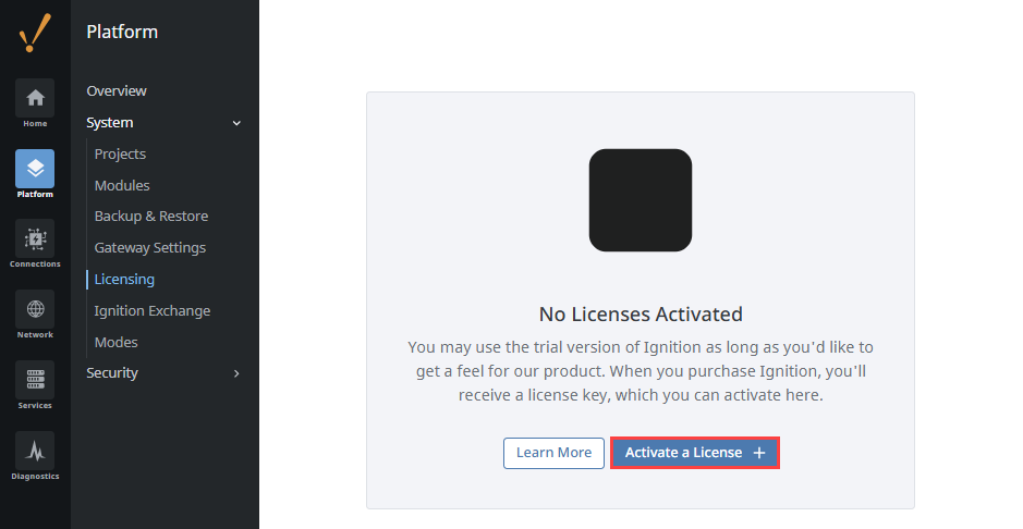

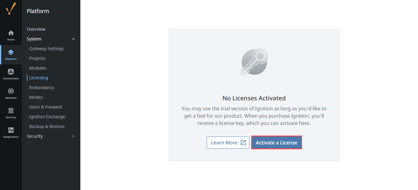

  1. Go to the Gateway Webpage and select the Platform section.
  2. From the menu on the left, select System > Licensing. The Licensing page will appear. If you already have a license key, click the Activate a License + button.
    Online Activation Example Step 2

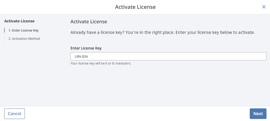

  3. The Activate License form will be displayed. Enter your License Key and click Next.
    Online Activation Example Step 3

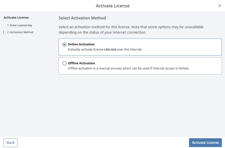

  4. Select Online Activation, then press Activate License.
    Online Activation Example Step 3b
  5. The Licensing page will refresh, and your license will be successfully activated.

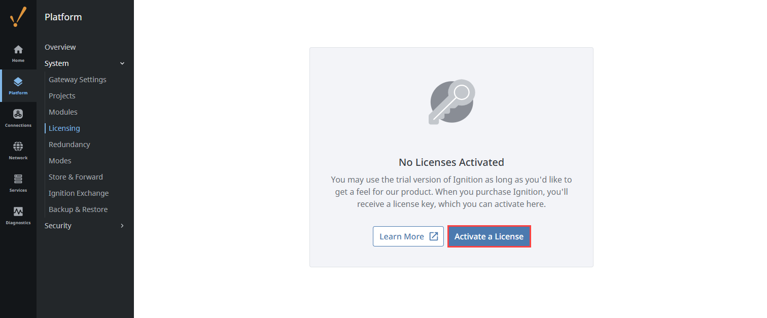

  1. Go to the Platform tab on the Gateway Webpage.
  2. Scroll down to System > Licensing. The Licensing Activation page appears.
  3. Click on Activate a License.

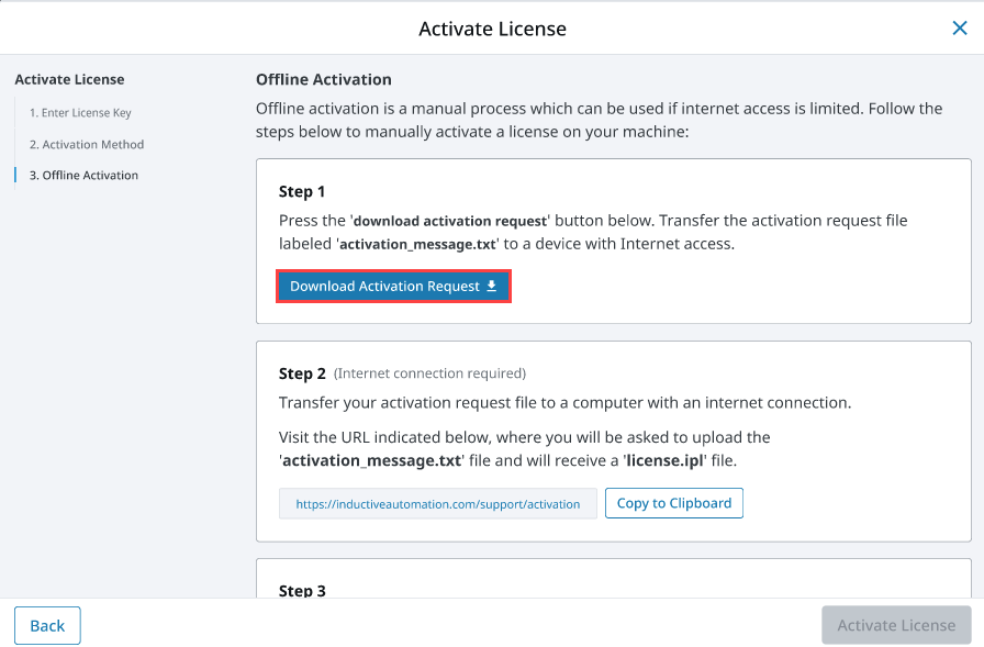

  5. Click the Offline Activation option.
  6. Click the Download Activation Request. An activation request file, called activation_message.txt is generated and downloaded.
    Offline Activation Example Step 6

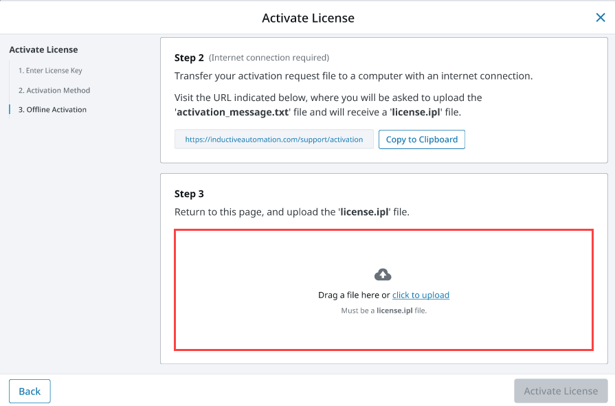

  7. Take the activation_message.txt file to a machine with internet access and go to https://links.inductiveautomation.com/activation.
  8. Click Choose File and select the activation_message.txt file.
    Offline Activation Example Step 8
    note
    Should any trouble occur with the upload process, please contact our Support department.
  9. Once you upload the activation_message.txt file, a license file called license.ipl is generated.
  10. Bring the license.ipl file back to the computer on which you're licensing Ignition. Back on the Offline Activation page, upload the license.ipl file. Then click Activate to finish the process.
    Offline Activation Example Step 10

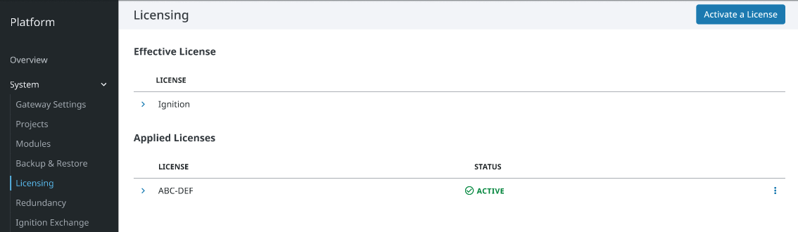

Effective vs Applied Licenses​

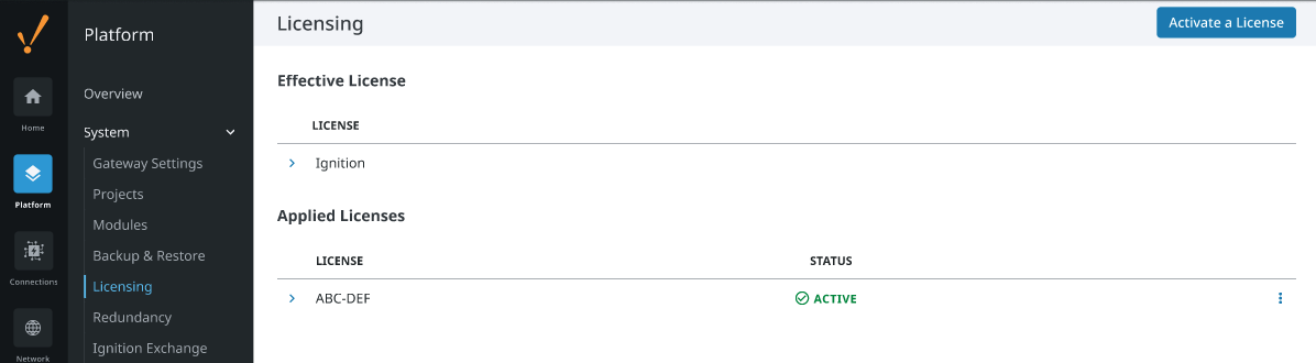

The Licensing page has two sections, which detail different information.
Applied Licenses: Shows all licenses that have been applied to the Gateway. Entries here are typically purchased or given, and have a license key associated with them.
Effective Licenses: Provides a summary of modules active on the Gateway. Modules are active if they're provided by an applied license. This area is the result of potentially multiple licenses across various activation mechanisms. For example, if license A provides module A, and license B provides module B, then Effective Licenses would show that both modules A and B are active on the Gateway. The caveat here is that the modules will only appear if they're installed on the Gateway. In this same scenario with licenses A and B, if module B was not installed, then it will not appear under Effective Licenses.
In addition, the Effective Licenses area may have "synthetic" items that are translated to modules. For example, in the case of Edge Gateways, their Applied Licenses will show products. These products will be translated to modules under the Effective License section.

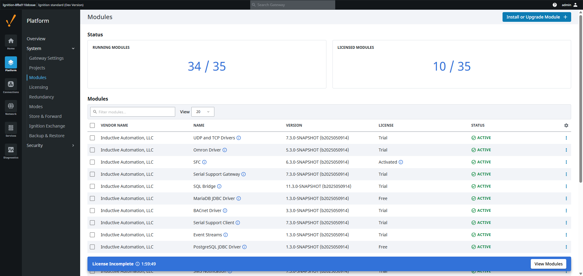

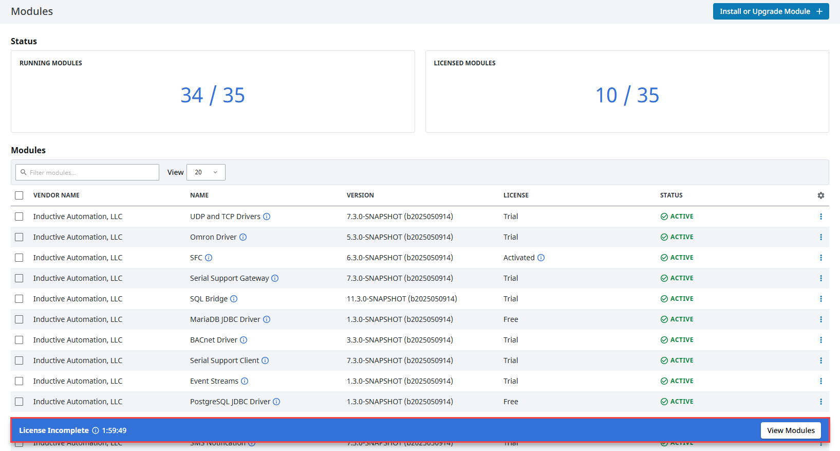

Licensing Modules​
To function properly, each module in your system must be provided by a license that supports the related module's version. Once a module is installed, the module version and license status are displayed in the Platform section on the System > Modules page.
This page lists all of the modules currently running with their license status as either Trial, Activated, or Free mode. If you are licensed for a module you are running, it will run in Activated mode. If you are not licensed for a module you are running, it will run in trial mode until the trial time is expired.
Do not be alarmed by a License Incomplete message on the Modules page. Clicking on the View Modules link within the banner will open an informational message box that will provide context to the warning, such as a module running in trial mode.
License Incomplete
Navigate to the Platform section and click on System > Licensing to reload or update any problematic licenses. Other required module adjustments are covered on the Platform section's Module page.

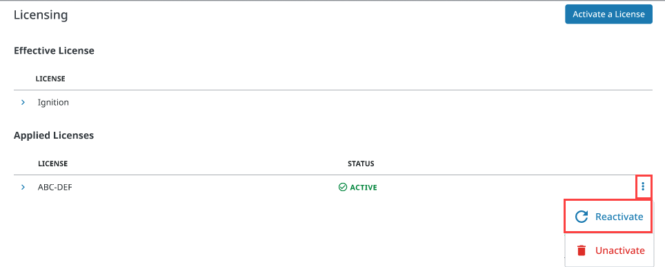

If you added new modules or updated the versions existing modules, then you'll need to update (Reactivate) your license. Licenses are reloaded from the Platform > System > Licensing section on the Gateway webpage. Expand the three dots menu and select Reactivate for the license that was changed, as shown below.
Updating a License - Online License Update
Clicking Reactivate will cause the Gateway to attempt to reach out to our licensing server, and will update shortly after.

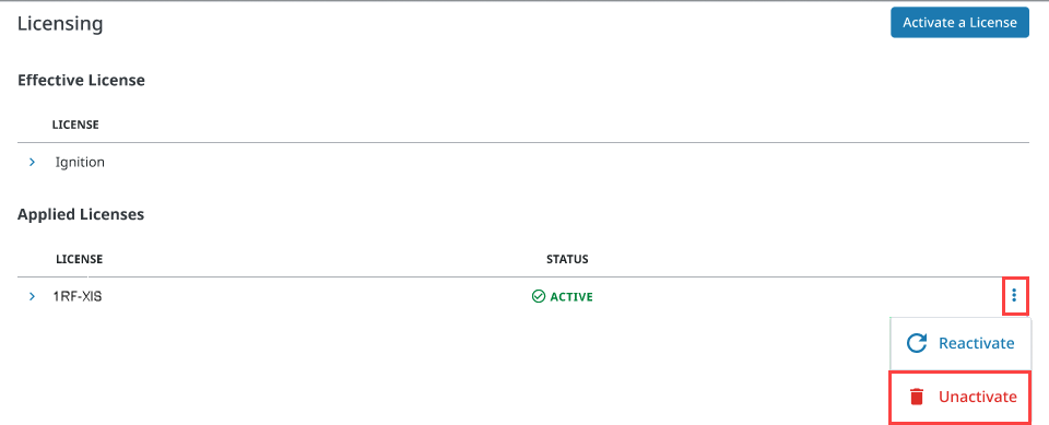

Unactivating a License​
For a given license key, a limited amount of simultaneous activations are allowed at a given time. If you want to activate Ignition on a different server, you must first unactivate it on the current server. You can unactivate the license on one Gateway, and then activate it on a different Gateway if needed. Unactivation occurs immediately over the internet, and makes this license available for activation on another machine.
Online Unactivation​
To unactivate the Gateway, do the following steps:

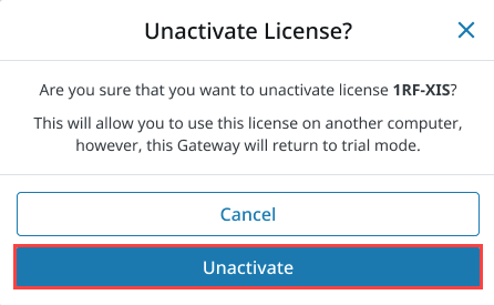

  1. From the Platform section of Gateway, go to System > Licensing. The Licensing page is displayed and you can see the currently installed license key.
  2. Click on the three dots menu and select Unactivate.
    Unactivating a License - Online Unactivation Step 2
  3. An Unactivate License warning will appear asking you to confirm the unactivation. Click Unactivate. It may take a minute or so for the request to finish.
    Unactivating a License - Online Unactivation Step 3
  4. The unactivation request will be sent to Inductive Automation's licensing servers, and the license will again be available for activation on another Gateway.
