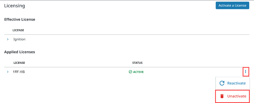

  1. Unactivate your license key from your old Gateway by going to the Platform section > System > Licensing. You will be able to see any licenses that are currently applied.
  2. Expand the three dots menu and select Unactivate for the active license listed under Applied Licenses.
    Part 1a Online Unactivation Step 2

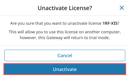

  3. A confirmation popup will appear, asking you to confirm the unactivation. Click Unactivate. It may take a minute or so for the request to finish.
    Part 1a Online Unactivation Step 3

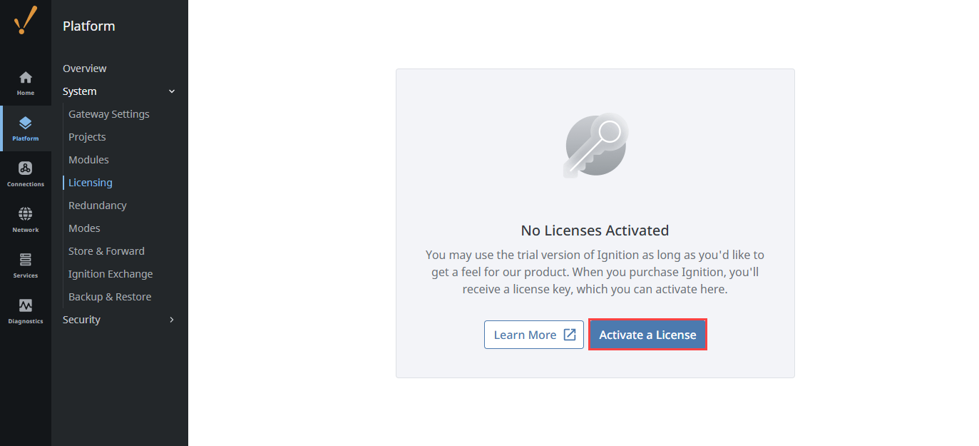

  1. Go to the Gateway webpage and select the Platform section.

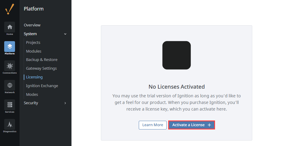

  2. From the menu on the left, select System > Licensing. The Licensing page will appear, from which you will need to click Activate a License +.
    Part 2a Online Activation Step 2

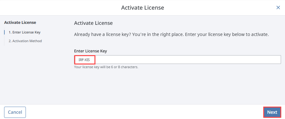

  3. The Activate License form will appear. Enter the license key from the old Gateway and click Next.
    Part 2a Online Activation Step 3

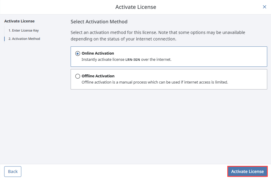

  4. If you are connected to the Internet, select Online Activation and then Activate License.
    Part 2a Online Activation Step 4

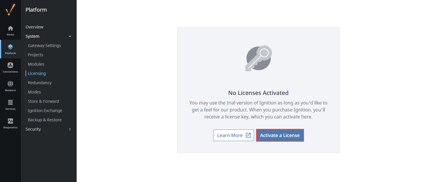

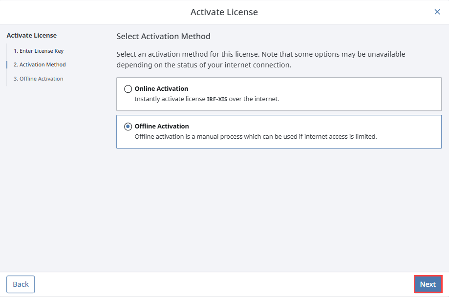

  4. If you are not connected to the Internet, or if you want to activate your Gateway manually, click the Offline Activation option and click Next.
    Part 2b Offline Activation Step 4

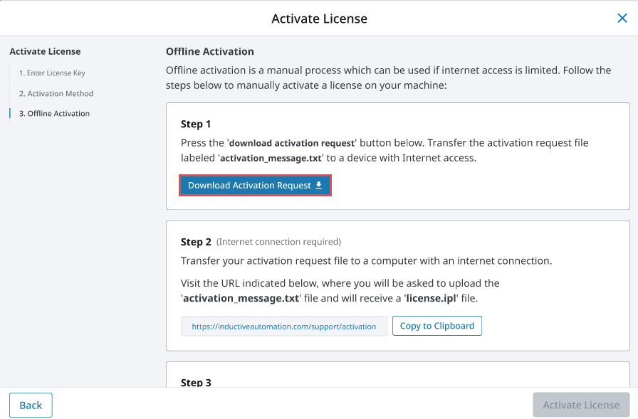

  5. Click the Download Activation Request button. An activation request file, called activation_message.txt will be generated and downloaded.
    Part 2b Offline Activation Step 5

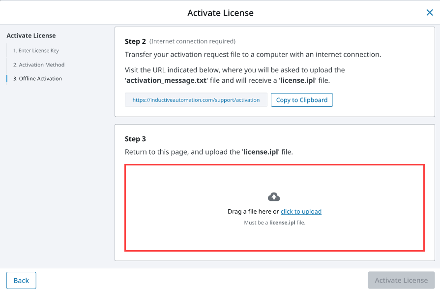

  6. Take the activation_message.txt file to a machine with Internet access and go to https://links.inductiveautomation.com/activation.
  7. Click Choose File and select the activation_message.txt file in the Activate Ignition section.
    Part 2b Offline Activation Step 7
    note
    Should any trouble occur with the upload process, please contact our Support department.
  8. Once you upload the activation_message.txt file, a license file called license.ipl is generated.
  9. Bring the license.ipl file back to the computer on which you're licensing Ignition. Back on the Offline Activation page, upload the license.ipl file. Then, click Activate to finish the process.
    Part 2b Offline Activation Step 9
