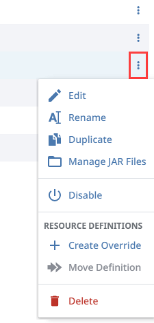

New in 8.3.2

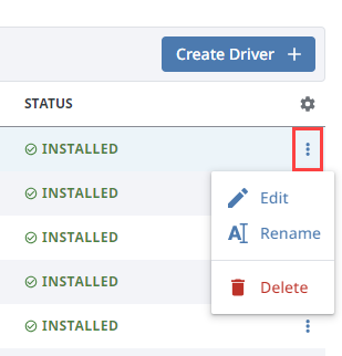

A new menu option, Manage JAR Files, was added in version 8.3.2. This means that although the JAR File(s) property is also included in the tables below, it can only be viewed and edited by selecting the Manage JAR Files option. Note that prior to 8.3.2, the JAR File(s) property is available to view and change in the Edit panel.
Select Delete to remove a JDBC driver from your Gateway.
