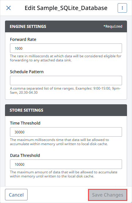

  1. Go to the Platform section on the Gateway Webpage and select System > Store & Forward. Store and Forward metrics for each of your database connections are displayed on the Store and Forward page.
  2. On the engine you want to edit, click the three dots menu and select Edit to access the Edit panel.
  3. Once you make the changes you want, click Save Changes at the bottom of the panel to return back to the Store & Forward Engines page.
Store and Forward Edit Panel
Store and Forward Settings​
The Store and Forward engine settings define how and when data moves through the system.
Engine Settings​
SettingDescription
Forward RateThe rate in milliseconds at which data will be considered eligible for forwarding to any attached data sink. Default is 1,000.
Schedule PatternA comma separated list of time ranges, such as 9:00-15:00, 9pm-5am, or 20.30-04.30.
Store Settings​
These settings apply to the local disk storage cache.
SettingDescription
Time ThresholdThe maximum milliseconds time that data will be allowed to accumulate within memory until written to local disk cache. Default is 30,000.
Data ThresholdThe maximum amount of data that will be allowed to accumulate within memory until written to the local disk cache. Default is 10,000.
Batch SizeThe maximum amount of data that will be batched when forwarding to either the disk cache or any attached data sink. Note: Data can be potentially further batched within the data sink when processing incoming data. Default is 10,000.
