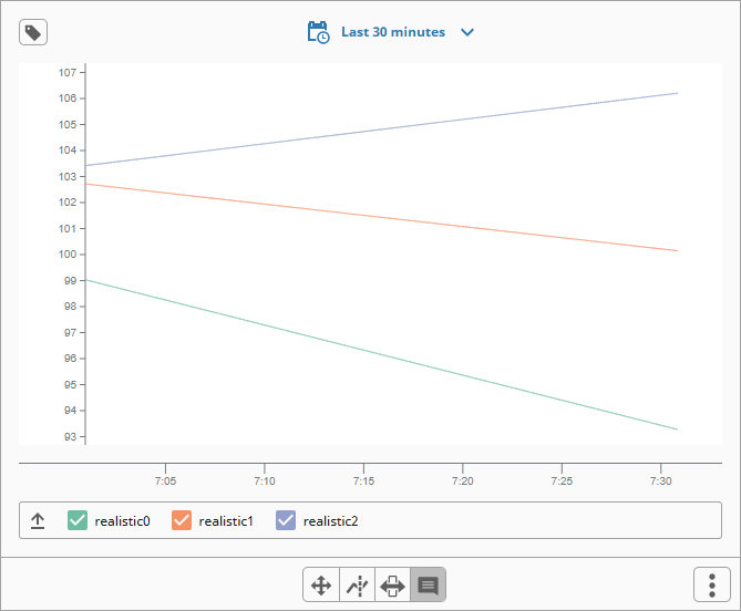

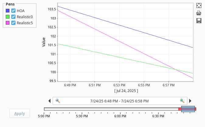

Display Historian Data​
Both Vision and Perspective include Chart components designed for displaying historical tag data. Drag tags directly onto these charts to create pens. They support features like multiple axes, moving averages, subplots, and runtime controls for adjusting trends.
