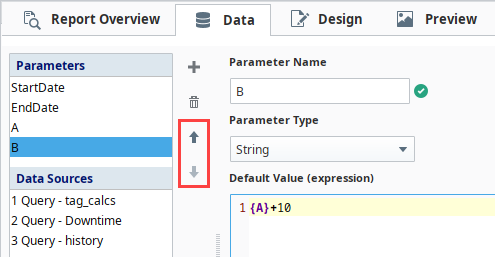

Order Matters​
The list order under the Parameters and Data Sources is important. In some cases, a parameter or data source will have the capability to reference the results of another type, such as a parameter referencing the value of another parameter. Parameters and data sources may only reference data listed vertically above them in the list. In short, the bottom-most data source may reference all other parameters and data sources, while the top-most parameter may not reference any other parameter or data source.
To reorder the lists, use the up and down arrow icons.
