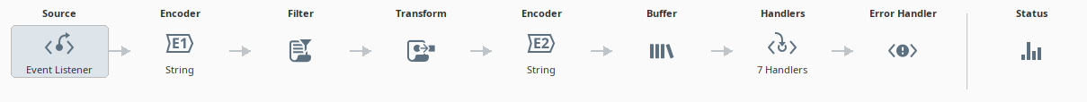

Event Stream Stages​
Event streams are made up of several parts, called stages. While some of these stages are optional, such as the Filter and Transform stages, they will help your event stream get the result you want.
Event Stream Stages

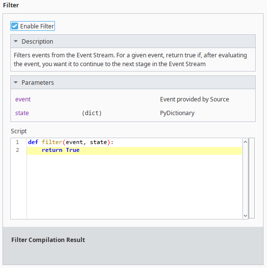

Filter​
The filter stage is an optional script that takes the event payload as an argument and returns a boolean. If the script returns false, the event is ignored and not passed down the event stream to the next stage.
The filter script takes two arguments (event and state), both of which can be further broken down.
ArgumentData TypeSubargument
eventPyDictionary
  • data - The data from the event object, as a PyObject.
  • metadata - The metadata from the event object, as a PyDictionary.
statePyDictionary
  • lastEvent - The last event seen by the filter, which may or may not have been dropped.
  • lastEmittedEvent - The last event that returned True from the filter function.
Users can also add their own keys or values to PyDictionary if they want to store some state between filter calls.
Filter Stage

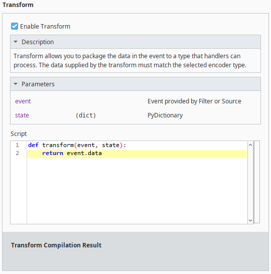

Transform​
The transform stage is an optional script that takes the event payload from the source (or the filter script if returned True) as an argument and returns a different object. This new object is then used as the event payload going forward in the event stream.
Similar to the filter script, the transform script takes two arguments (event and state), both of which can be further broken down:
  • event (PyDictionary)
    • data (PyObject) - The data from the event object.
    • metadata (PyDictionary) - The metadata from the event object.
  • state (PyDictionary)
Users can also add their own keys or values to PyDictionary if they want to store some state between transform calls.
The transform stage can often function as data preparation. Users can manipulate the data into the form they want, making it ready for the handler stage to do something with the data.
Transform Stage

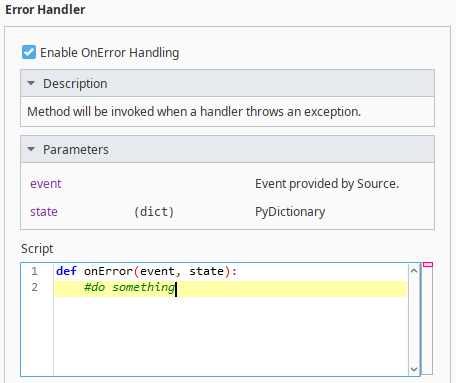

Error Handler​
The error handler is the final stage of the event stream and acts as a final catch-all for any potential issues or errors that were not caught by each individual handler's failure handling logic. This stage is invoked when a handler throws an exception and the individual handler's failure handling is set to ABORT. You can define what you want to do with a given error using the scripting area.
Error Handler Stage

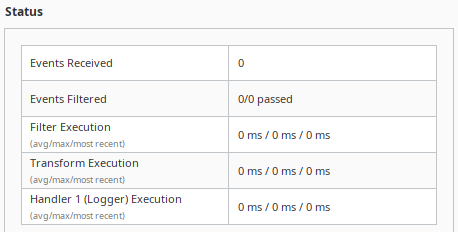

Checking Event Stream Status​
To the right of the event stream stages is the Status panel. You can check information such as how many events were received, how many events were filtered, and throughputs for various executions and handlers. The table below describes each status metric.
MetricDescription
Events ReceivedThe number of events received by the event stream.
Events FilteredThe number of events that have passed through the filter.
Filter ExecutionThe amount of time an event takes to go through the filter stage. Throughputs measured include the average time of an event, maximum amount of time for a given event, and the time for the most recent event.
Transform ExecutionThe amount of time an event takes to go through the transform stage. Throughputs measured include the average time of an event, maximum amount of time for a given event, and the time for the most recent event.
Handler ExecutionThe amount of time an event takes to go through the specified handler. Additional rows will be added when new handlers are created. Throughputs measured include the average time of an event, maximum amount of time for a given event, and the time for the most recent event.
Event Stream Status Panel
