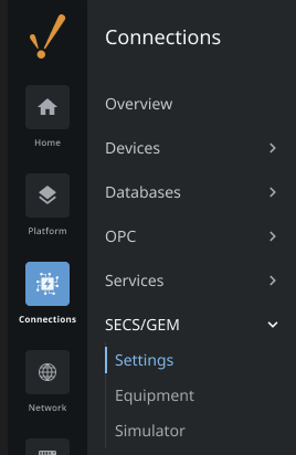

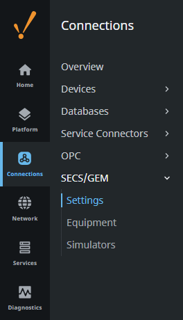

Once the module is installed, a new header is available under the Connections section of the Gateway Webpage that allows you to configure connections to the equipment, or set up simulators that are used for testing.
