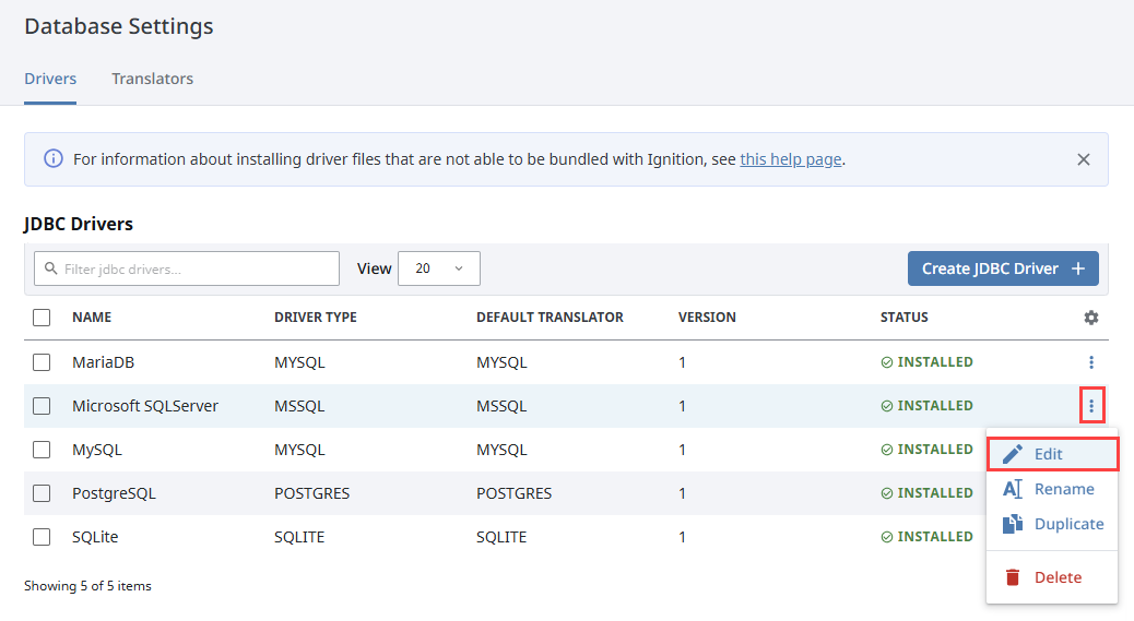

Depending on the database connection you are trying to establish, custom configurations may be required. These adjustments can be made by locating the driver on the Connections > Databases > Settings page of your Gateway. Click the three-dot menu icon for the driver and select Edit to begin making changes.

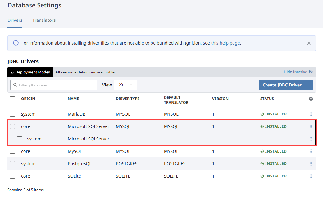

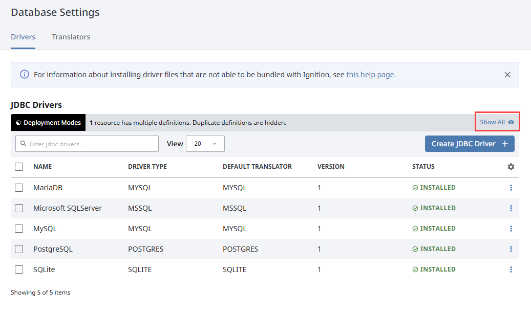

Any changes made will override the module configurations as long as the driver name is still the default name. This happens because the modules inject the driver files at the system level, while driver changes made on the Gateway are placed as core resources. If any of your drivers have been modified, a message box will appear above the drivers list stating the number of drivers with multiple definitions. Click the Show All option to show the duplicates.
The expanded list shows the results of modifying the MSSQL JDBC driver. It now has definitions on the core and system level, with the core definition as the primary option.
