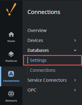

  1. On the Gateway Webpage Connections section, click on Databases > Settings.
    The Database Settings page is displayed.

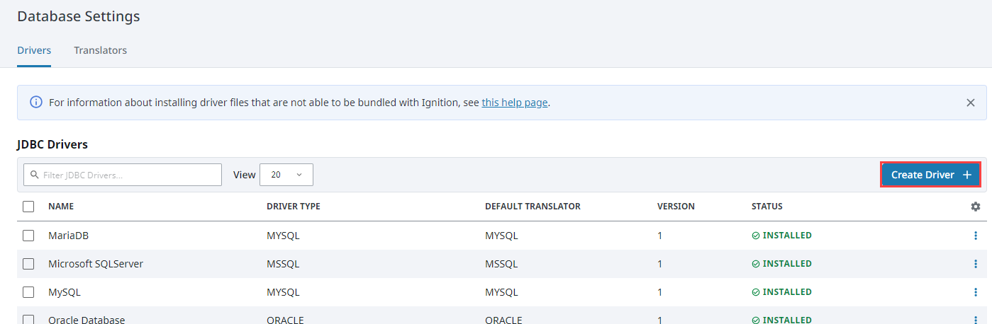

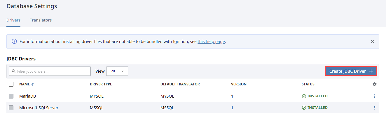

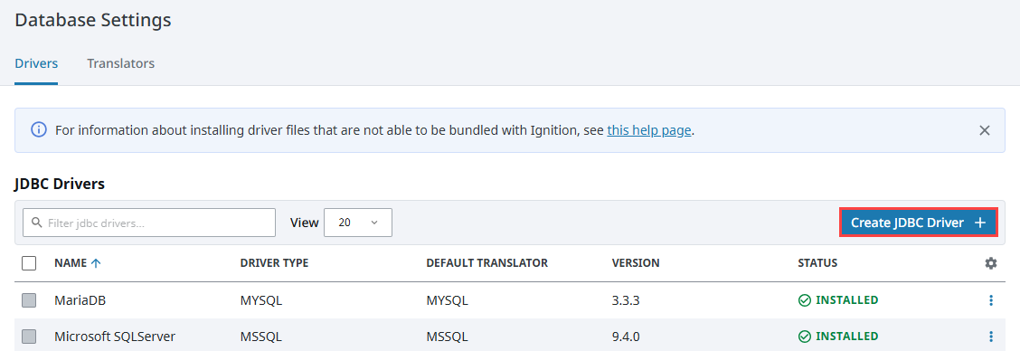

  2. On the Drivers tab, click on Create JDBC Driver + at the top right of the JDBC Drivers list.

  2. Once you have the new driver, head to your Ignition Gateway's Connections section, click on Databases > Settings.
  3. The Database Settings page will open and display the currently configured JDBC drivers. Click the three dots menu icon and select Manage JAR Files for the driver you need to upgrade.
