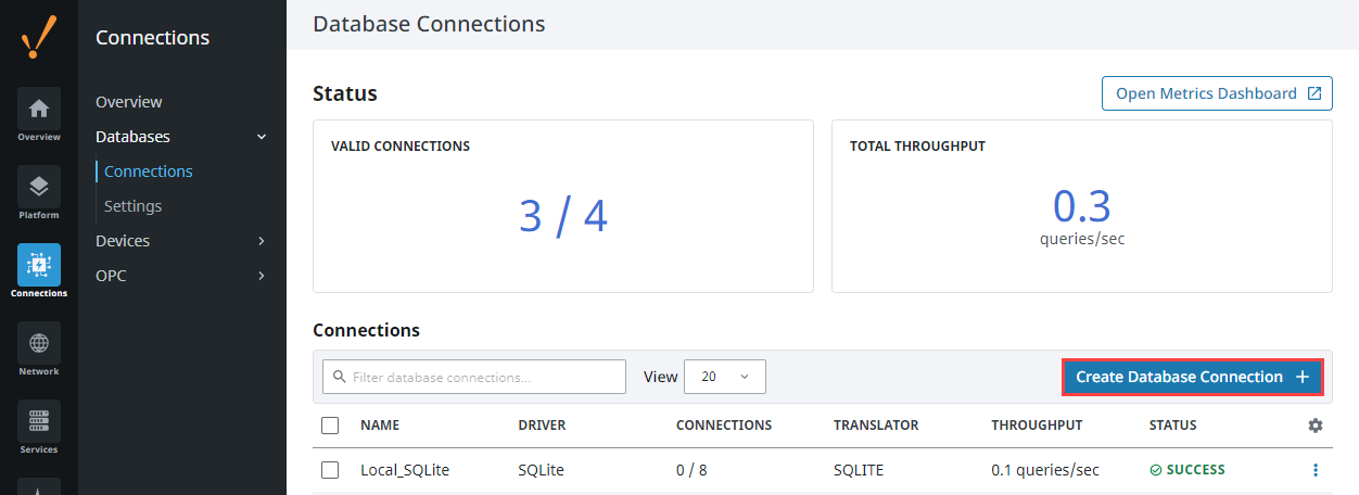

  1. On the Gateway Webpage, go to the Connections section.
  2. Select Databases > Connections.
  3. The Database Connections page is displayed. Click on Create Database Connection +.

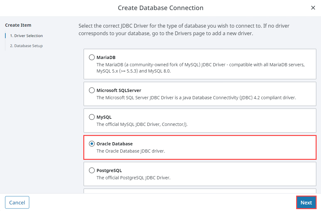

  4. Select the Oracle Database JDBC driver and click Next.

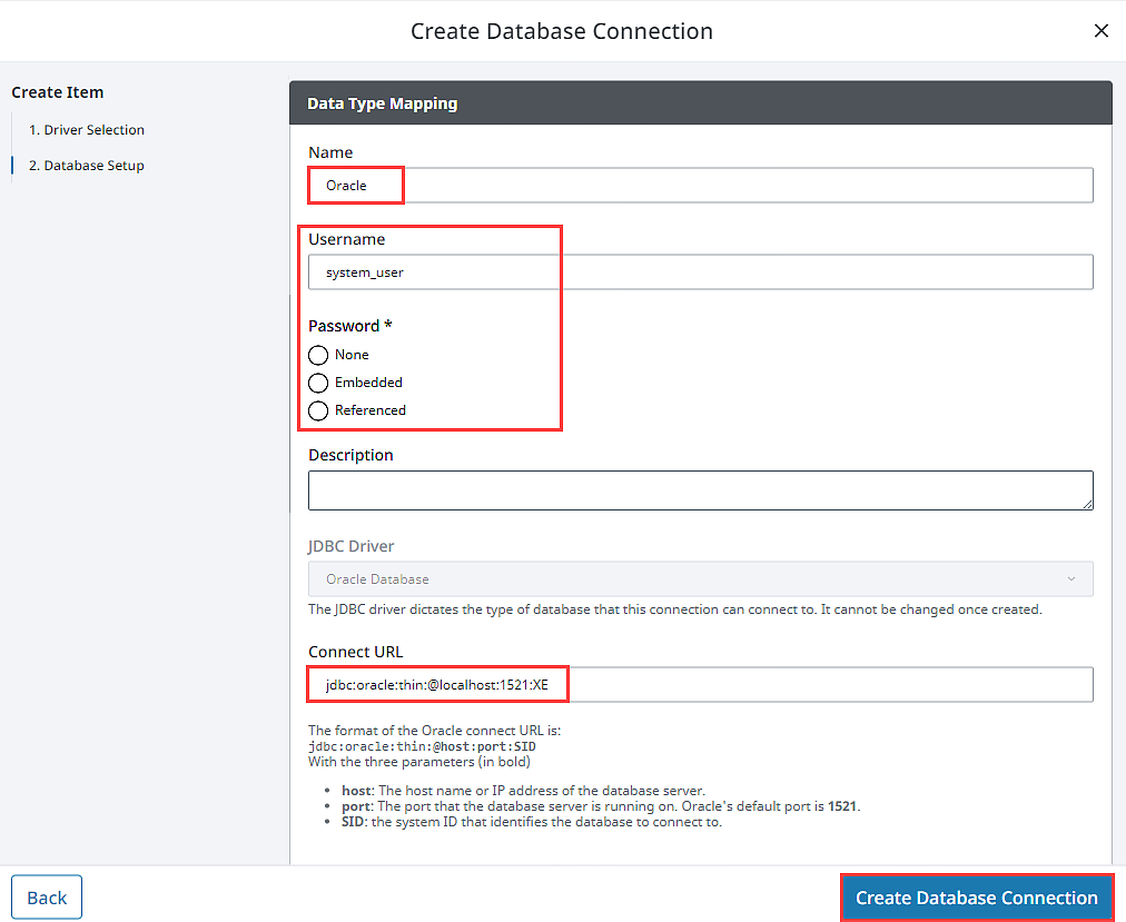

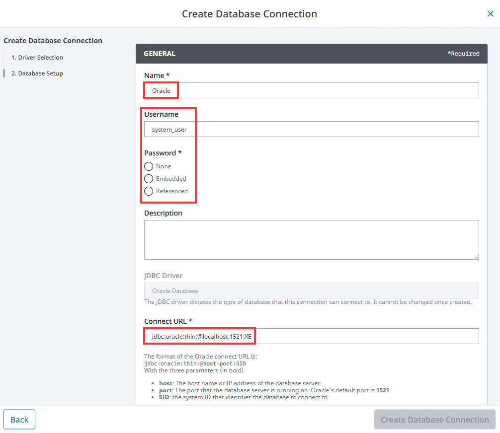

  5. Enter the following information:
    • Name: The name of the database connection. Other features in Ignition will reference this connection by the name specified here.
    • Connect URL: A URL that describes where on the network the database is, as well as information about which schema to connect to. The initial value should look something like the following: jdbc:oracle:thin:@localhost:1521:XE However, you may need to make some changes. If we examine the key pieces of the URL, it would look like this: jdbc:oracle:thin://1:2:3 Where:
      • 1 = The IP Address or hostname of the computer/sever that the database is installed on.
      • 2 = The port that the database is running on. The default is 1521, but this could have been changed during installation, or sometime afterwards. When in doubt, ask the person that installed the database.
      • 3 = The System ID for the database. More information on the System ID can be found in Oracle's documentation.
    • Username: The username that the Gateway will use to connect to the database.
    • Password: The password for the user specified in the Username property.
    The values seen below may differ from each installation.
  6. Click Create Database Connection at the bottom of the form.
