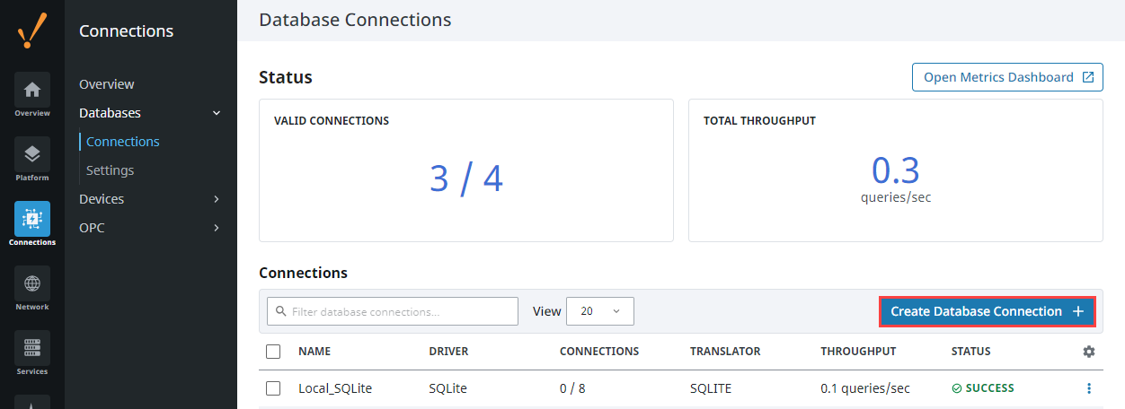

  1. On the Gateway Webpage, go to the Connections section.
  2. Select Databases > Connections.
  3. The Database Connections page is displayed. Click on Create Database Connection +.

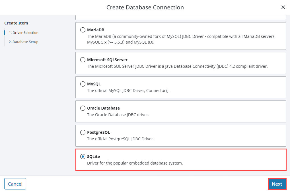

  4. Select the SQLite driver and click Next.

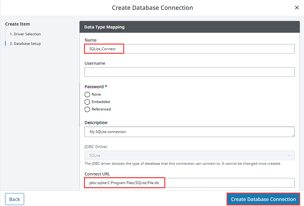

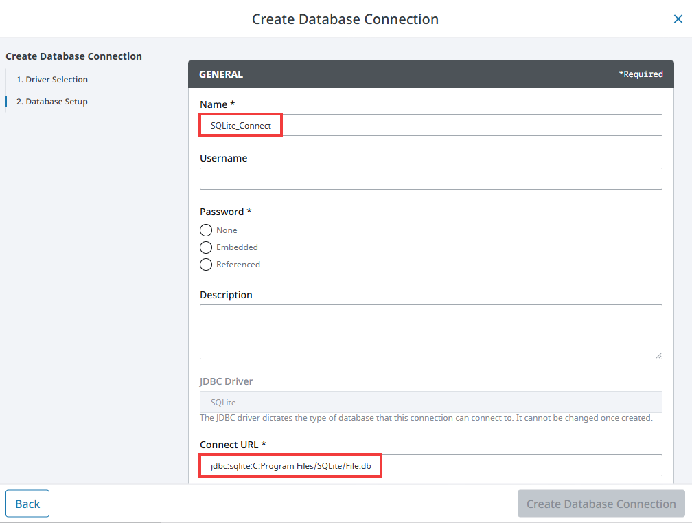

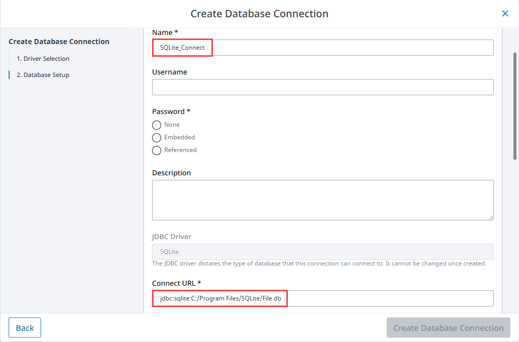

  5. On the Database Setup tab, enter a name for your connection. We used SQLite_Connect.
  6. Next, enter the connect URL for the database. For SQLite this setting must lead to a location on a filesystem. In our example here we used jdbc:sqlite:C:/Program Files/SQLite/File.db. This path ultimately must lead to a local directory, or a locally mapped drive.
  7. Click Create Database Connection.
Your connection is now created and the Database Connections page is displayed showing the Status of your connection as Valid.
