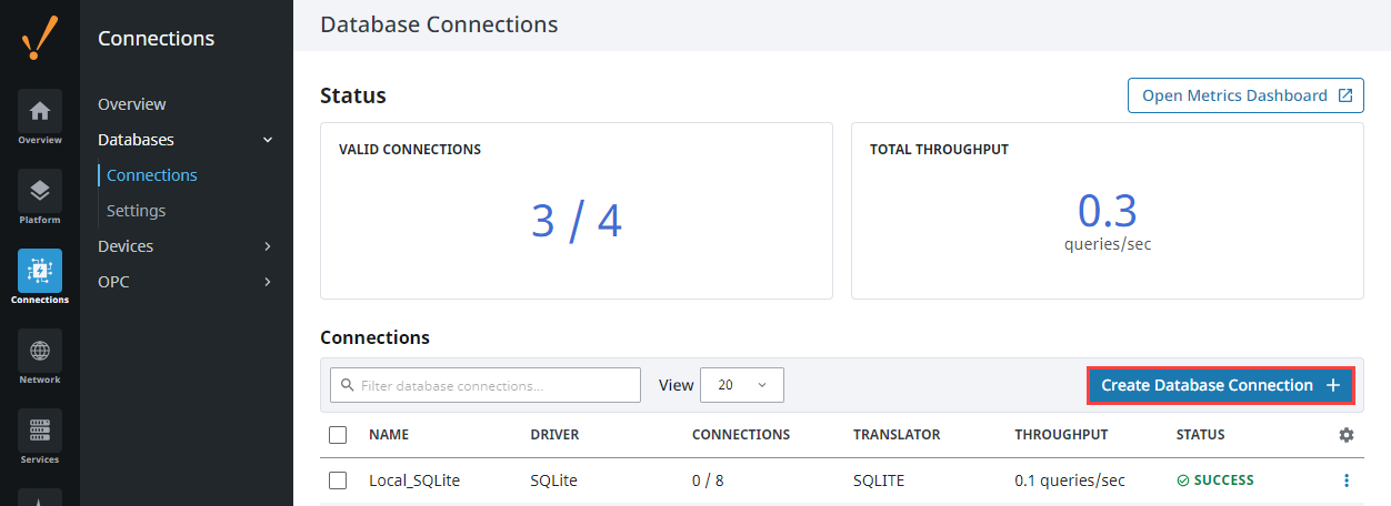

  1. On the Gateway Webpage, go to the Connections section.
  2. Select Databases > Connections.
  3. The Database Connections page is displayed. Click on Create Database Connection +.

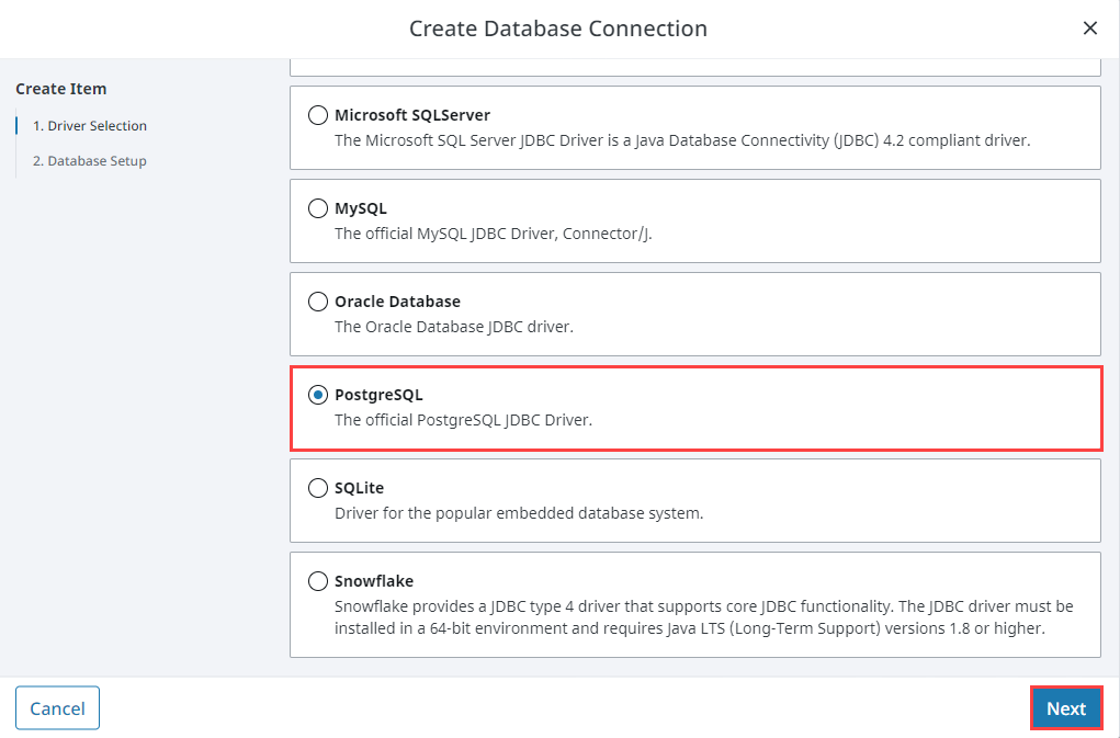

  4. Select the PostgreSQL JDBC Driver and click Next.
