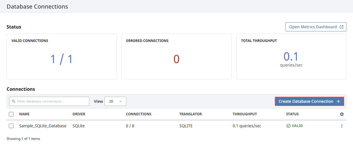

  1. On the Gateway Webpage, go to the Connections section.
  2. Select Databases > Connections.
  3. The Database Connections page is displayed. Click on Create Database Connection +

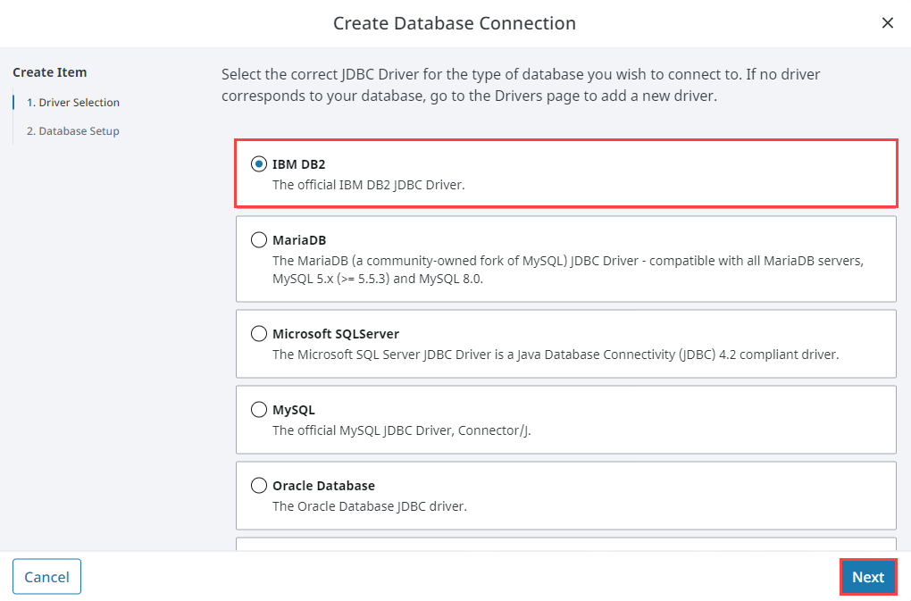

  4. Select the IBM DB2 JDBC Driver from the Driver Selection tab, and click Next.
    note
    For more information, see JDBC Drivers and Translators for instructions on obtaining the requisite JAR file, and then follow the steps for Upgrading a JDBC Driver before continuing with these instructions.

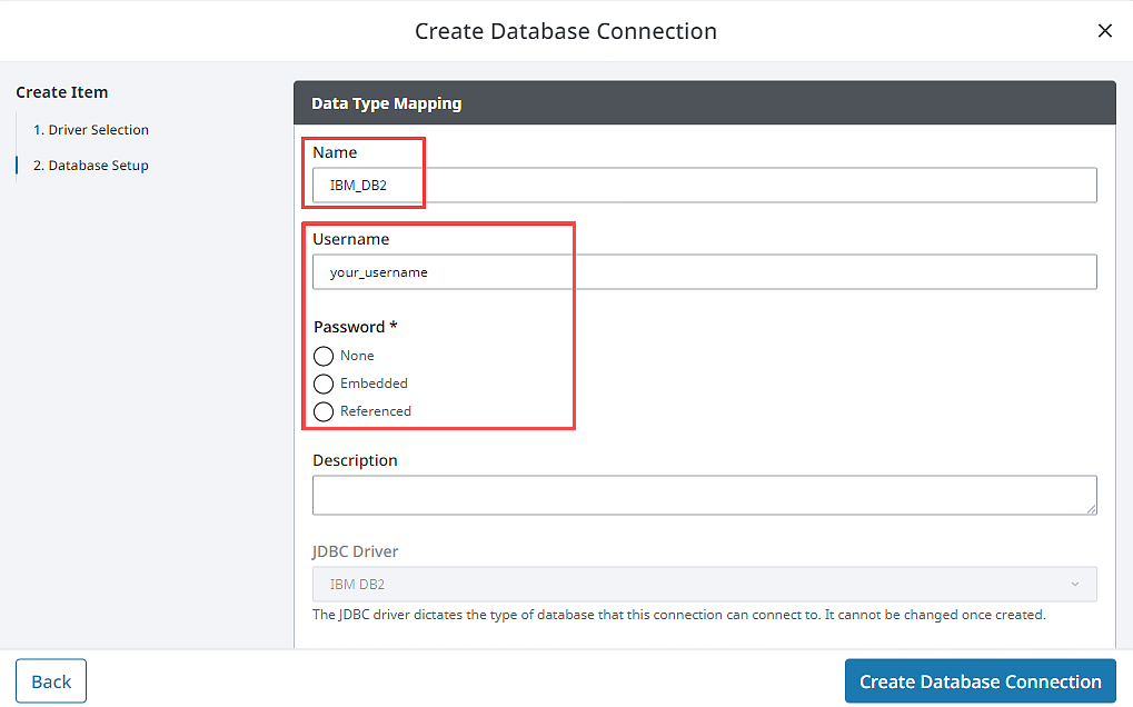

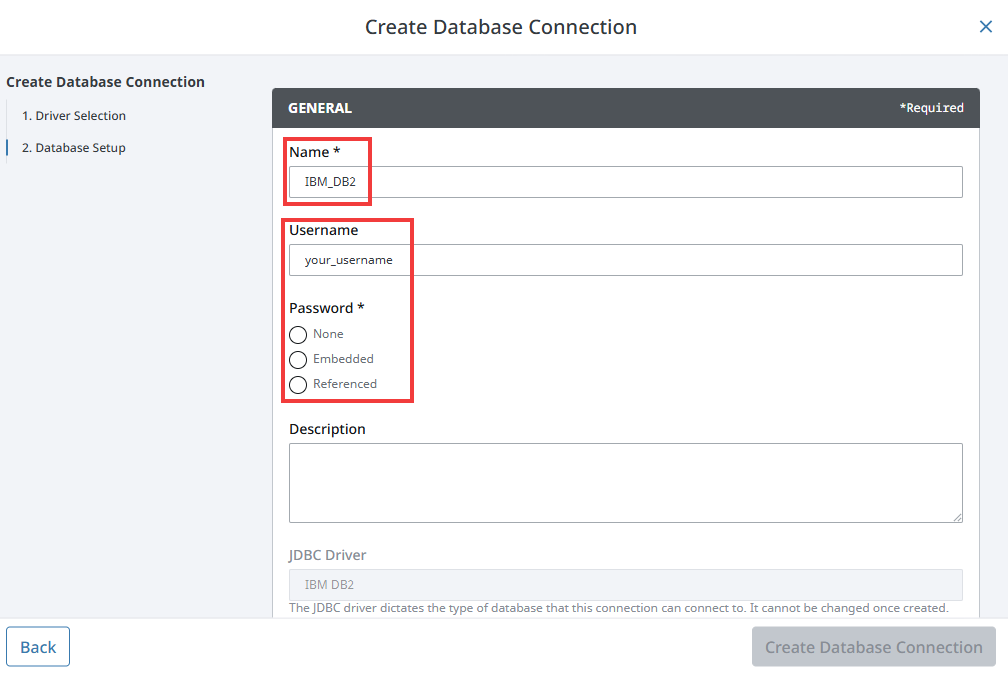

  5. On the Database Setup tab, enter the following information:
    • Name: IBM_DB2
    • Username: your_username
    • Password: Select your password type, and fill in as needed.
    • Connect URL: jdbc:db2://localhost:25000/SAMPLE
