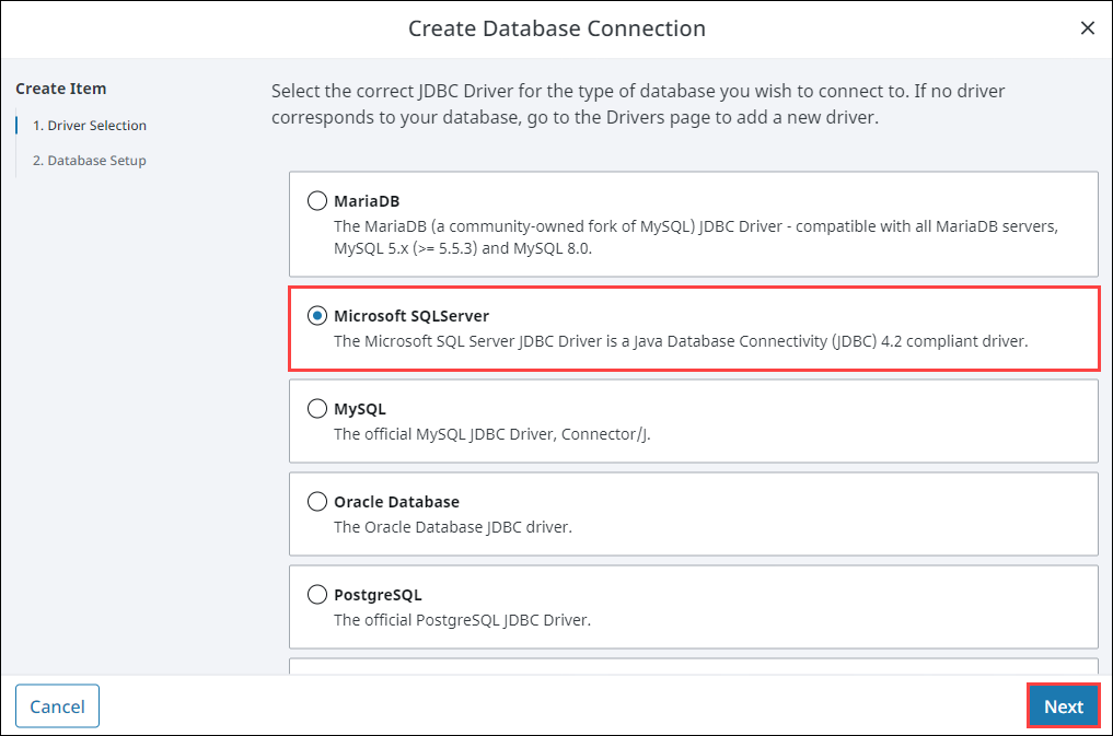

  3. The Database Connections page is displayed. Click on Create Database Connection +
  4. Select Microsoft SQLServer, and click Next.

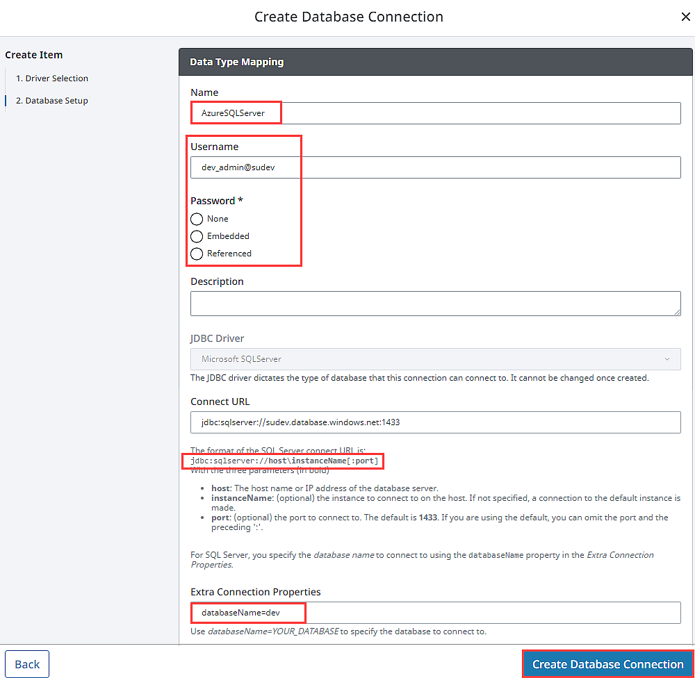

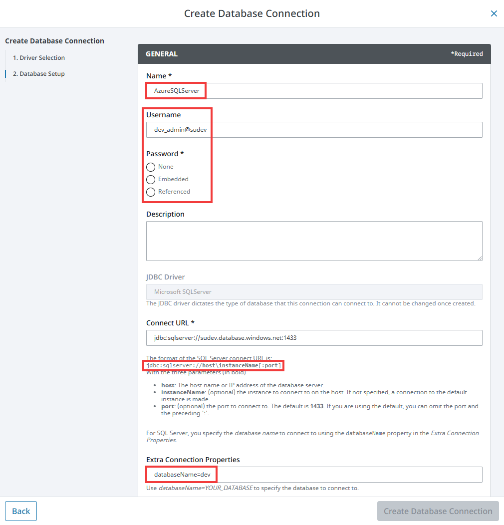

  5. On the Database Connections page, enter the following information:
    • Name: The name of the connection. In this example, we are naming our connection AzureSQLServer.
    • Connect URL: The address that your Azure SQL Server instance is hosted on. In this example, we are using jdbc:sqlserver://sudev.database.windows.net:1433.
    • Username: The username of your database login credentials. In this example, we are using dev_admin@sudev.
    • Password: The password of your database login credentials.
    • Extra Connection Properties (Optional): Any other properties you may need to configure to connect to your Azure SQL Server instance will be listed here, such as the database name and SSL.

  6. At the bottom of the form, click in Create Database Connection.
    Your connection is now created. The Database Connections page is displayed and will show the status of Reconnecting, then Valid.
