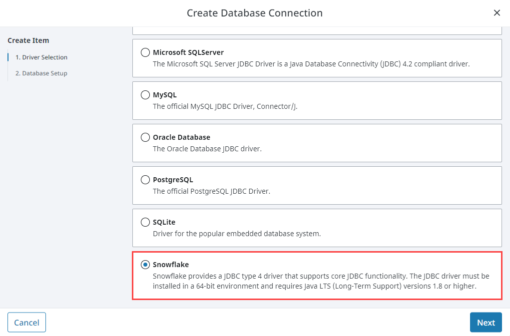

Connect to Snowflake​
  1. On the Gateway Webpage, go to the Connections section.
  2. Select Databases > Connections.
  3. Click Create Database Connection + on the Database Connections page
  4. Select Snowflake and click Next.
  5. Enter a name for your connection.
  6. Enter the the connect URL for the database.
  7. Click Create Database Connection.
Your connection is now created and the Database Connections page is displayed showing the Status of your connection as Valid.
