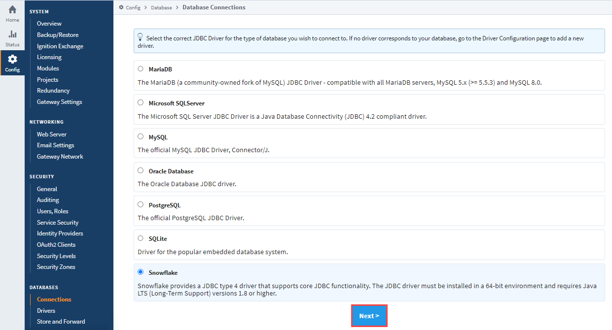

Connect to Snowflake​
  1. On the Gateway Webpage, go to the Config section.
  2. Scroll down to Databases > Connections.
  3. Click Create new Database Connection... on the Database Connections page
  4. Select Snowflake and click Next.
  5. Enter a name for your connection.
  6. Enter the the connect URL for the database.
  7. Click Create New Database Connection.
Your connection is now created and the Database Connections page is displayed showing the Status of your connection as Valid.
