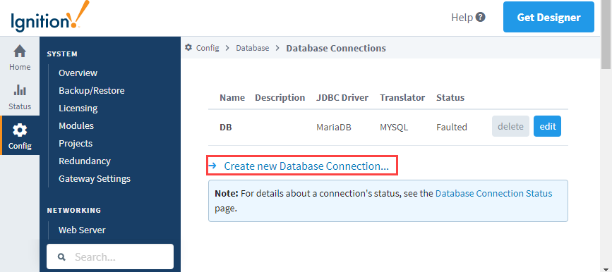

  1. On the Gateway Webpage, go to the Config section.
  2. Scroll down to Databases > Connections.
  3. The Database Connections page is displayed. Click on Create new Database Connection....

  6. Click Create New Database Connection at the bottom of the form.
  7. The Database Connections page is displayed showing the Status of your connection as Valid.
  8. To display the details about the status of your database connection, see the Note on the above window and click on the Database Connection Status link.
