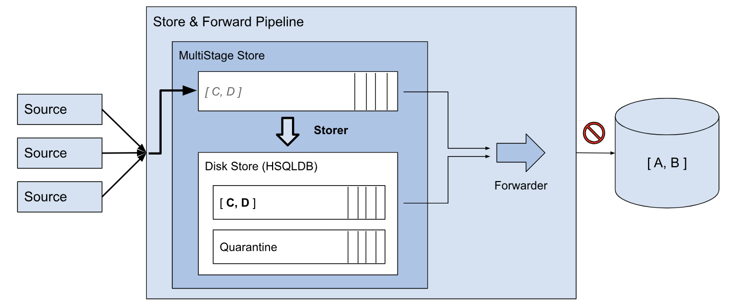

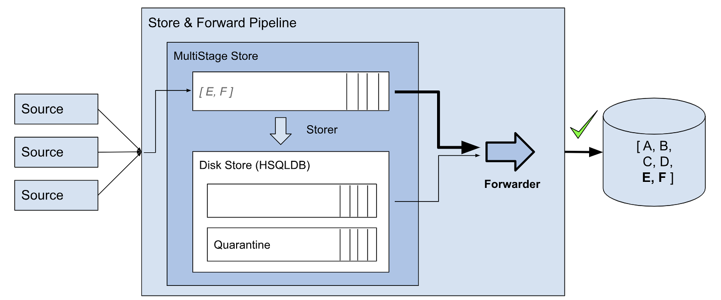

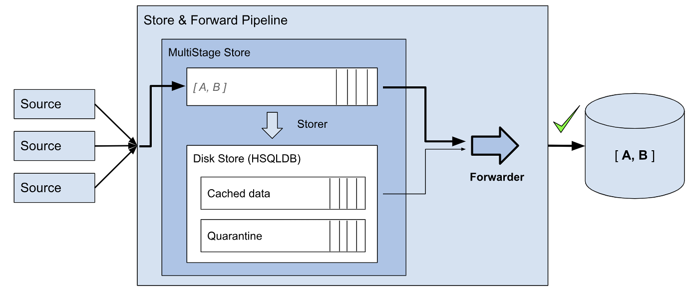

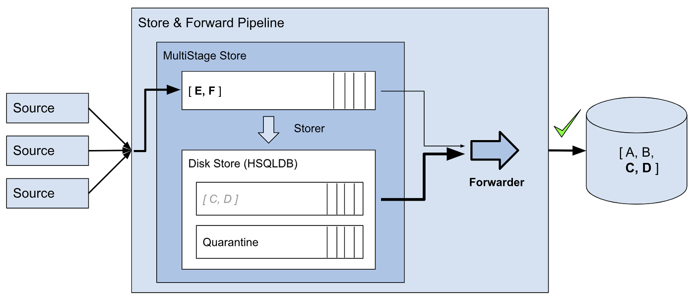

  1. Data A and B moves into the memory buffer, and since no other data is already being processed, it is then forwarded to sink.
  2. Data C and D moves into the memory buffer and is stored to disk cache, while A and B finishes transferring.
  3. Data C and D is now forwarded from disk cache to sink, while data E and F moves into memory buffer.
  4. Data E and F is forwarded directly to sink as the memory store is clear again.
