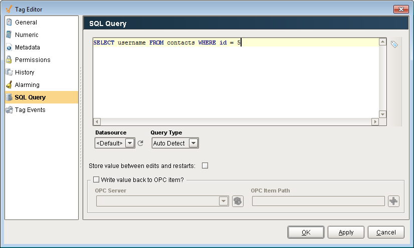

Queries in Tags​
Ignition offers Query Tags, which can run queries and return the result as a Tag value, giving all of the projects in the Gateway access to the same Database values.
