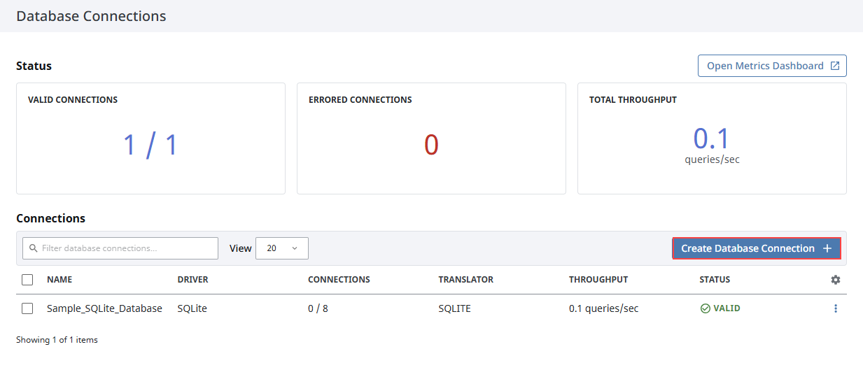

  1. On the Gateway Webpage, go to the Gateway Connections tab. Select the Databases > Connections section.
  2. On at the Database Connections page, click on the Create Database Connection + button at the top of the Connections table.
  3. The next step is to choose a JDBC Driver. Pick the JDBC driver for your database, and click on the Next button.
