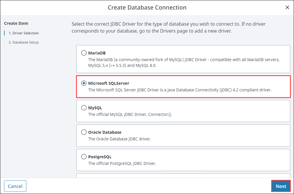

  4. Select the Microsoft SQLServer JDBC Driver, and click Next.

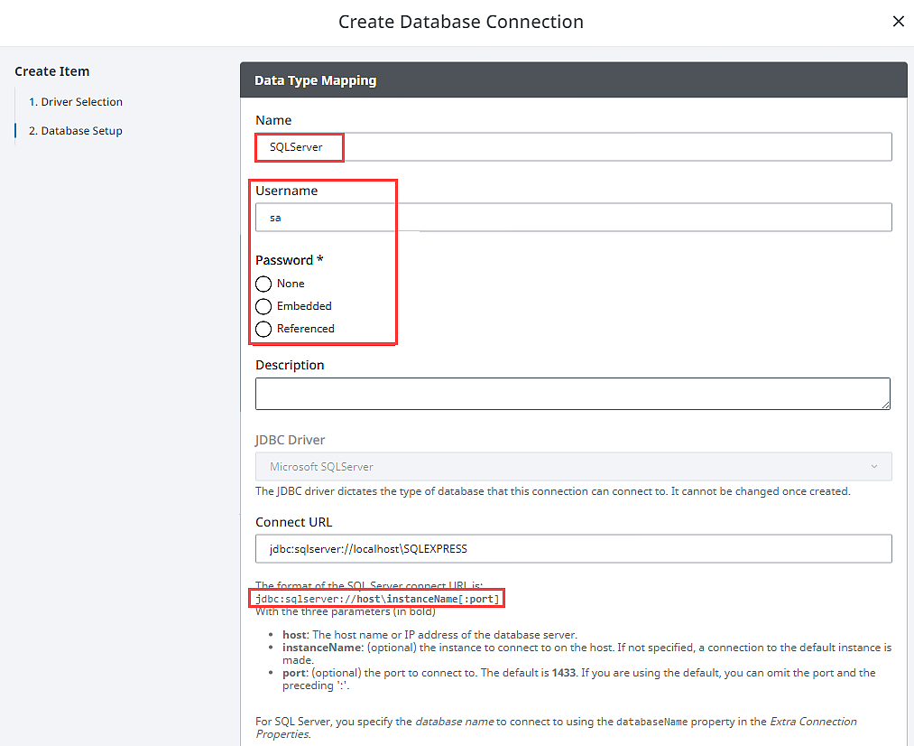

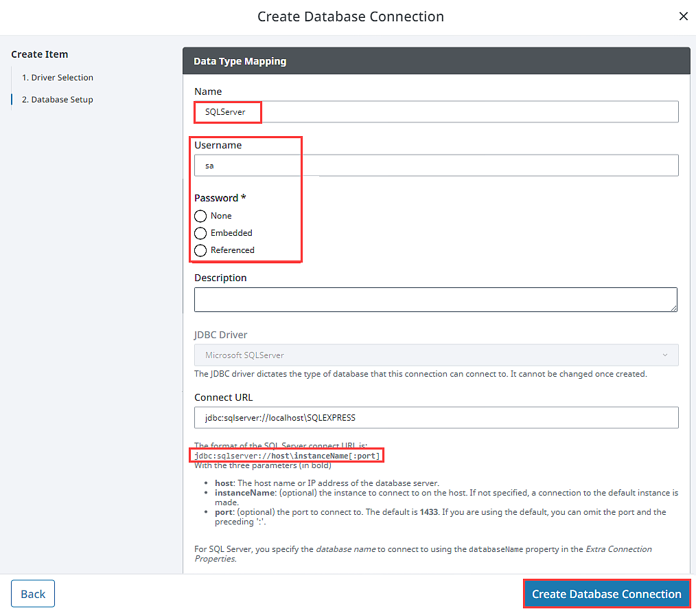

  5. On the Database Connections page, enter the following information:
    • Name: SQLServer
    • Connect URL: jdbc:sqlserver://localhost\SQLEXPRESS
    note
    We are connecting to the express edition of SQL Server using the default instance name. If you have the full SQL Server with default settings, replace SQLEXPRESS with the instance name of your SQL Server installation. Non-express versions of SQL Server tend to use MSSQLSERVER as a default instance name.
    • username: sa
    • password: sqlserver (password is what you entered during the SQL Server installation. For this example, password is sqlserver)
  6. At the bottom of the form, click on Create New Database Connection.

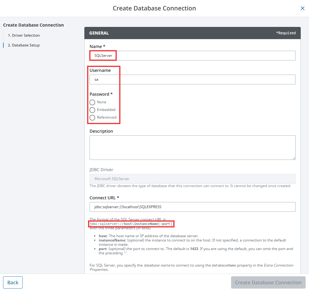

  5. In the New Database Connection window, enter the following information:
    • Name: YourDatabaseConnectionName (no spaces)
    • Connect URL: jdbc:sqlserver://Hostname\InstanceName
      • Hostname is your databases IP address or hostname and InstanceName is your databases instance name, for example:
        • jdbc:sqlserver://localhost\SQLEXPRESS
        • jdbc:sqlserver://10.10.1.5\MSSQLSERVER
  6. Set the username and password to a valid SQL authentication user. For example, sa is the default administrator account you can use.
  7. To add your own user account, open the SQL Server Management Studio and expand the Security > Logins folder. You will see all the current logins including sa and you can add a new login.
    1. To add a new login, right-click on the Logins folder and click New Login.... The Login window is displayed.
    2. Choose the SQL Server authentication mode and type in a Login name and password.
      note
      You will also have to add permissions to your database by mapping db_datareader and db_datawriter to the new user in the User Mapping section of the Login window. If you want Ignition to be able to create tables (ie: for Tag History), you also need to give table creation access such as db_owner.
  8. Go back to the Create Database Connection page in the Gateway, enter the name of your database, for example, in the Extra Connection Properties enter: databaseName=test (replace test with your database name, not the instance name).
  9. Click Create Database Connection. The Database Connection page is displayed showing the Status as Valid after a couple of seconds. If the connection is Faulted, check the Database Connection Status to find out why. Typically, the username/password is incorrect or the user doesn't have the right permissions.

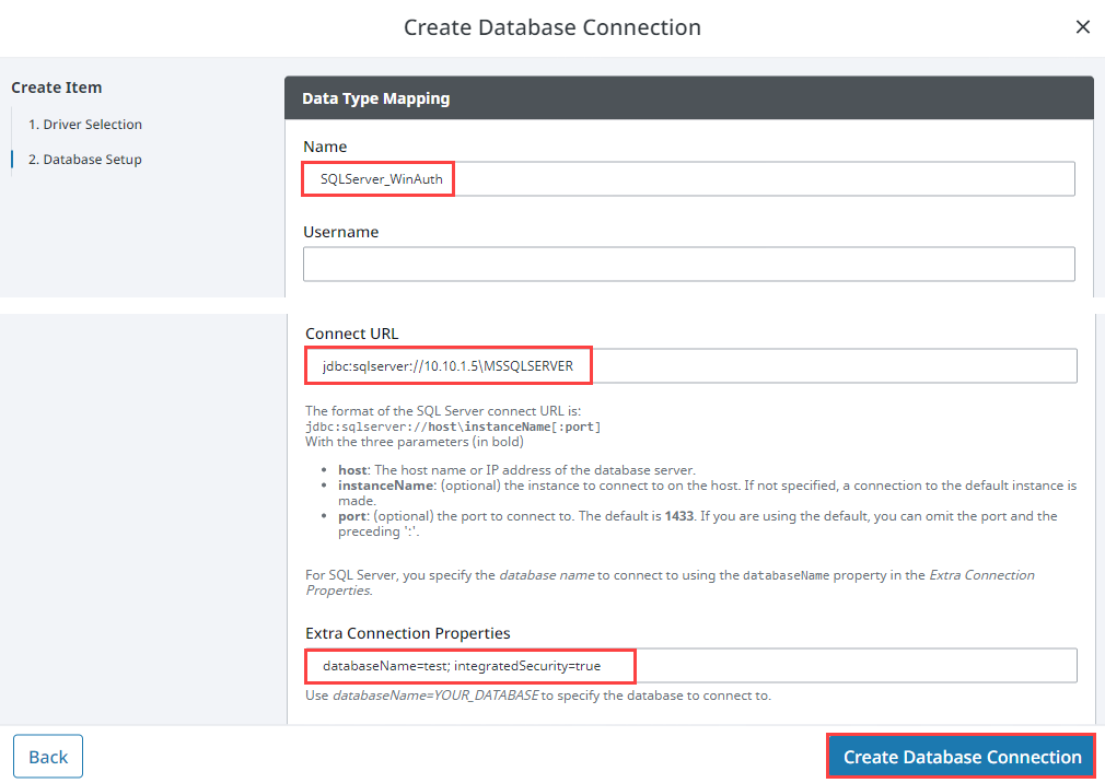

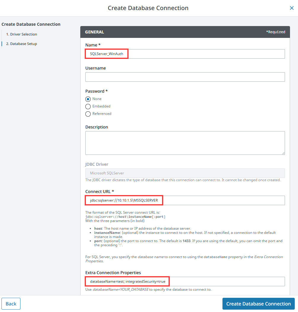

  5. On the New Database Connection page, enter the following information:
    • username: leave blank
    • password: None
    • Extra Connection Properties: databaseName=test; integratedSecurity=true; (replace test with your database name)
  6. Click on Create Database Connection.
The Status should be Valid after a couple of seconds. Again, if the connection is Faulted, check the Database Connection Status to find out why.
