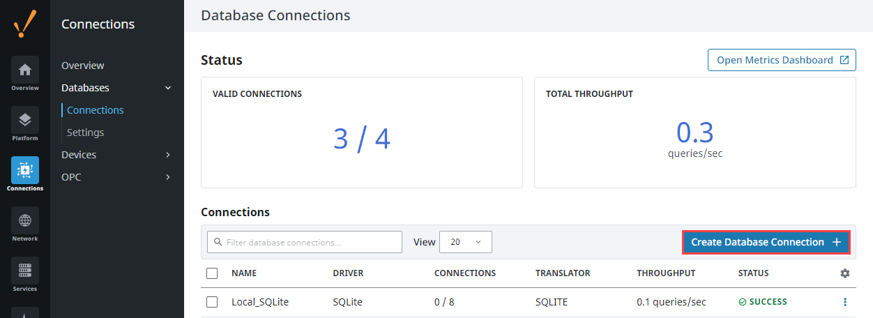

  1. On the Gateway Webpage, go to the Connections section.
  2. Select Databases > Connections.
  3. Click Create Database Connection +.

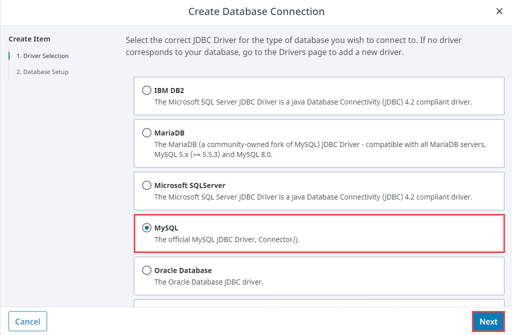

  4. Select the MySQL driver and click Next. You may need to install a JDBC driver for MySQL.
    note
    Alternatively, you may select the MariaDB driver, and use that to connect to MySQL. See the MariaDB Connections to MySQL Databases section above.

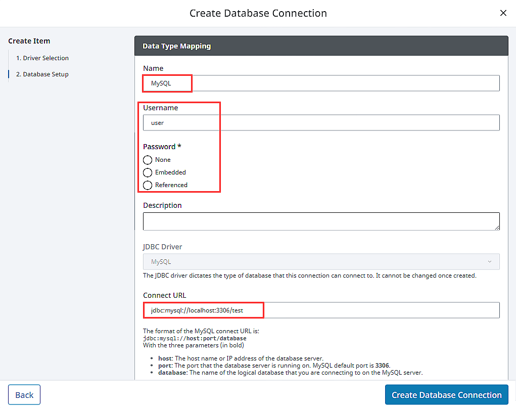

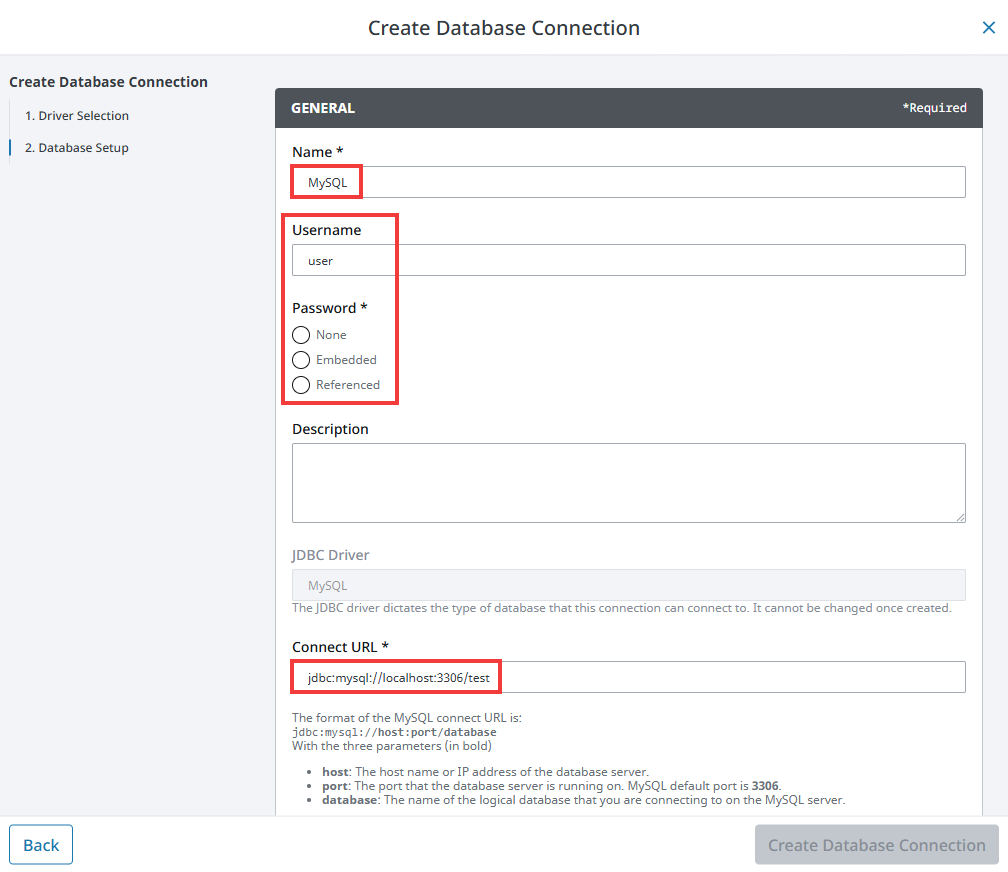

  5. On the New Database Connection page, enter the following information:
    • Name: MySQL (use a meaningful name such as MySQL)
    • Connect URL: jdbc:mysql://localhost:3306/test (By default, MySQL creates an empty database called test)
    As you see in the example above, MySQL uses the following Connect URL format: jdbc:mysqldb://hostaddress:3306/database
    Where hostaddress is the address of the machine with MySQL installed, for example: localhost, 192.168.1.1, db-server, etc. Database specifies the database schema the connection will target. The connection will target one schema (a collection of tables and other objects) in the database.
  6. To configure the connection, Ignition needs credentials to connect to MySQL. The Username and Password fields are where you provide credentials for a user that Ignition will use to authenticate against the database. The user should be able to do the following:
    1. Create and drop tables within the schema
    2. Alter tables within the schema
    3. Insert, update, select, and delete rows from tables in the schema
    4. Create, alter, and execute stored procedures within the schema
  7. After entering a username and password, click on Create Database Connection. Your connection is now created and the Database Connections page is displayed showing the Status of your connection as Valid.
