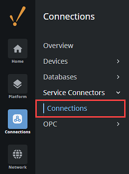

These connections connect to a Kafka cluster, which can then be used for event streams or Kafka system functions. To create a Kafka connection, navigate to the Gateway Webpage's Connections section > Service Connectors > Connections.

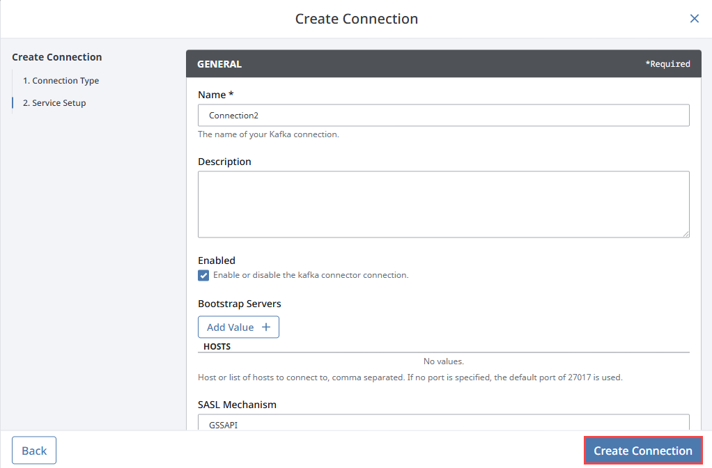

Main Properties​
PropertyDescription
NameThe name of your Kafka connection.
DescriptionA description of your Kafka connection.
EnabledEnable or disable the Kafka connection. Default is enabled.
Bootstrap ServersA list of host and ports (host:port) used for establishing a connection to the Kafka cluster, such as localhost:9092.
SASL MechanismThe SASL mechanism to use for client connections. This can be any mechanism for which a security provider is available. Default is GSSAPI.
Security ProtocolThe security protocol used when communicating with brokers. Default is PLAINTEXT. Options include:
  • PLAINTEXT: Un-authenticated, non-encrypted channel
  • SSL: SSL channel
  • SASL_PLAINTEXT: SASL authenticated, non-encrypted channel
  • SASL_SSL: SASL authenticated, SSL channel
UsernameThe username to use when connecting. This value will be injected into the sasl.jaas.config configuration property.
PasswordThe password to use when connecting. This value will be injected into the sasl.jaas.config configuration property. Options include None, Embedded, or Referenced.
Custom Client PropertiesAny properties you want applied to producer and consumer clients, line separated by key value pairs. When entering multiple key value pairs, you must use the following format:
 key1=value1
key2=value2
Note: If you are using a custom keystore, you will need to define the path to the custom keystore here using the property ssl.truststore.location=<keystore_location>.

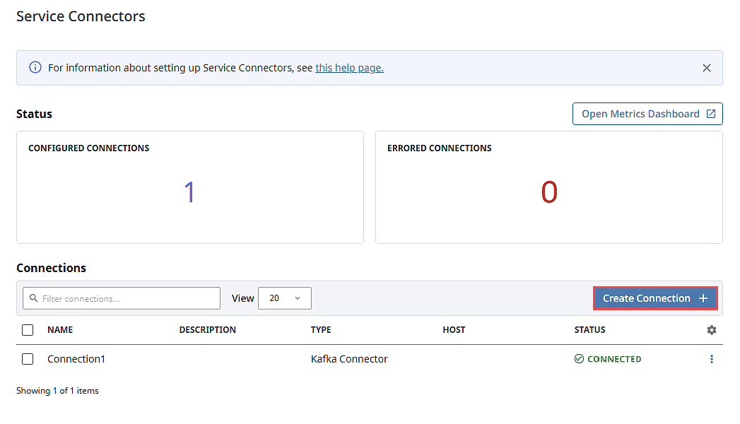

  1. On the Gateway Webpage, navigate to Connections > Service Connectors > Connections.
  2. Click Create Connection +.

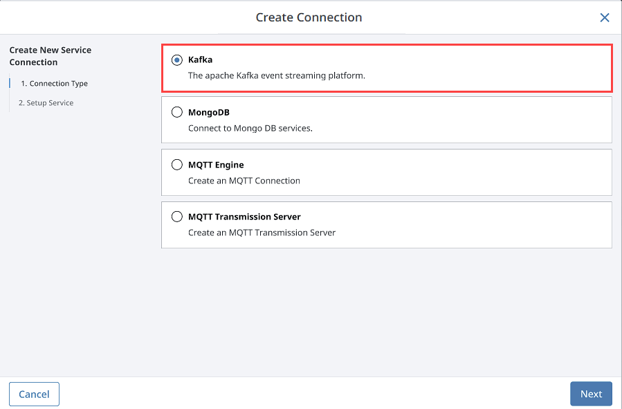

  3. Select Kafka Connector. Click Next.
  4. Fill out the Gateway fields with the appropriate information from your desired Kafka broker, then click Create Connection.
Your Kafka connection is now created. It may take a few seconds for your connection to update to a Valid status.
