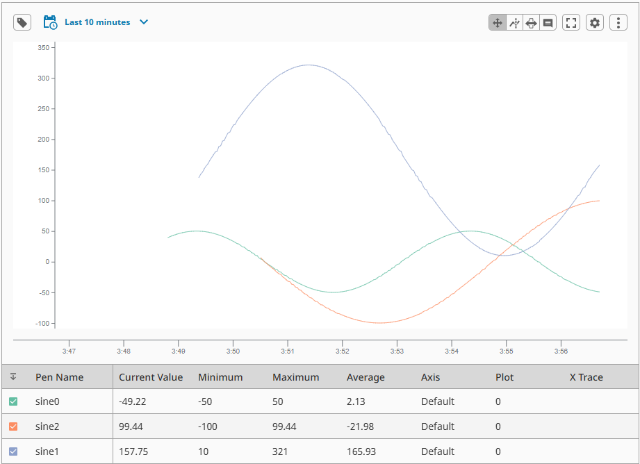

The Power Chart collects and displays data based on the pens that have been configured on the chart. Users can add or remove pens from the chart to change the underlying data. It is fully customizable in its appearance, from labels, colors, line widths, legend, scroll bars, and text styles.
note

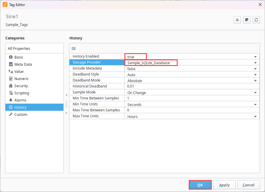

The Power Chart utilizes functionality provided by the Historian Core module, and requires a Historian license to function.
The Power Chart has a responsive design and a mobile-optimized display that is different than the standard display. It has a mobile breakpoint of 750px to fit on mobile devices. The mobile breakpoint is configurable on the responsiveDesignWidth property. The image below shows how the Power Chart renders on a smaller device.
Component Anatomy​
Aside from the chart trending area, the component features Browse Tags, Pen Control, and Chart Settings panels that provide additional functionality.

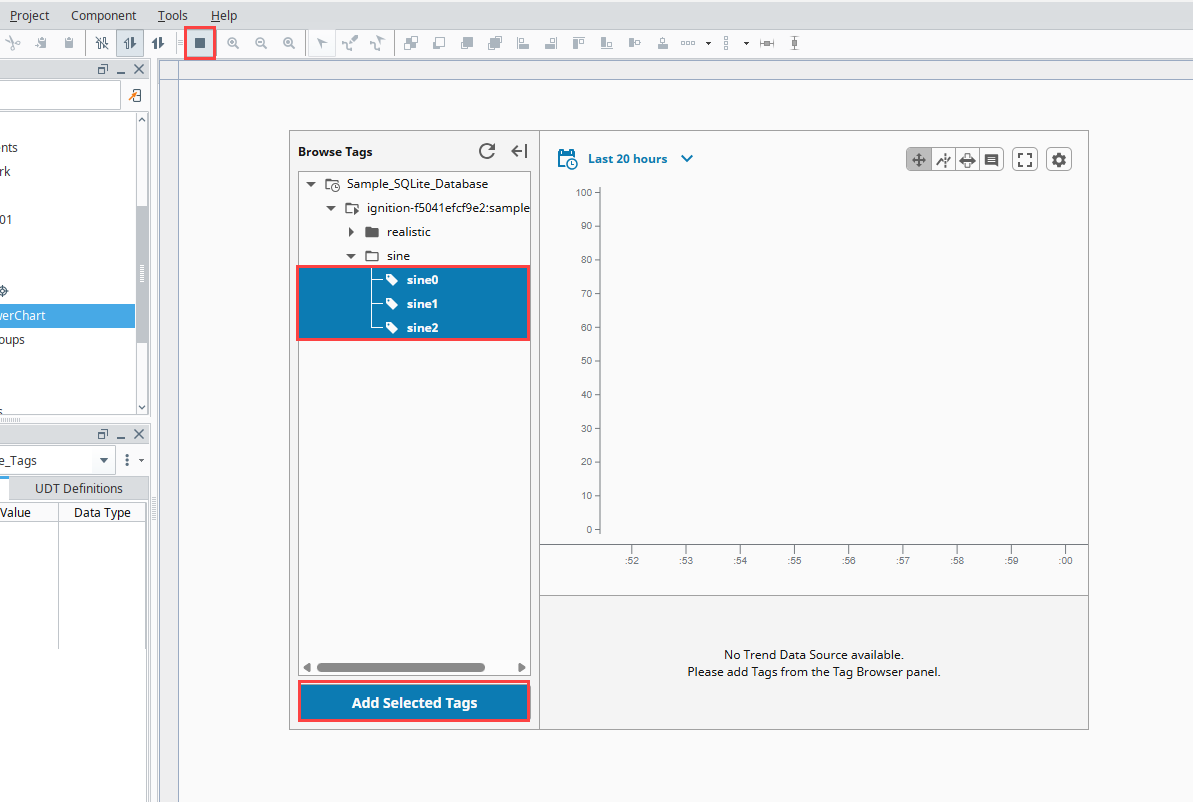

Browse Tags​
The Browse Tags panel allows you to browse for any available historical data, and add it to the chart. It is similar to the Designer's Tag Browser, but this tree reports any records that are accessible from the Historian system, including tables provided by the DB Table Historian Provider. There are two ways to add tags to the chart's display:
  • Select any nodes (entries with the Tag icon), and click Add Selected Tags, which will add a pen to the chart that represents the node that was selected.
  • Drag selected nodes onto the chart. You can select multiple items by using Ctrl-click and you'll see a prompt indicating how many tags are selected.
If there's more than one plot in the chart configuration, you will be prompted to choose the plot to add the pen to.
Pen Control​
This table shows each pen that's currently on the component, offers aggregates based on the chart's current range, and provides quick actions like hiding the pen and changing its color.
The Pen Data display supports numeric locale formatting. Numeric values are automatically formatted based on the Session locale and the axes.dataFormat property.

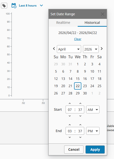

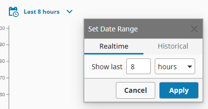

Date Range Selector" "Allows you to set the range on the chart. There are two modes:
  • Realtime: Shows the most recent chart data based on the given timeframe. Useful in cases where you want to display records from now to some amount of time in the past. " "
  • Historical: Allows you to pick at start datetime and end datetime using a popup calendar. " "
  • When the chart is in Historical mode, an additional time axis appears. On this axis, you can narrow down what the chart is showing you to specific points of interest by clicking and dragging the mouse along the axis. " "

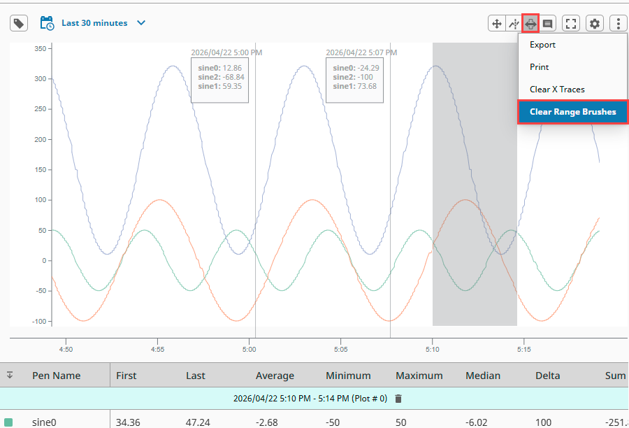

Pan and Zoom" "In this mode you can drag or swipe to pan forward and backward in time. On desktop device, clicking and dragging will pan across the chart. The mouse wheel will zoom. On mobile/touchscreen device, tapping and dragging will pan. The "pinch" and "spread" gestures will zoom.
Zoom reset" "To reset the zoom to default, click the zoom reset icon.

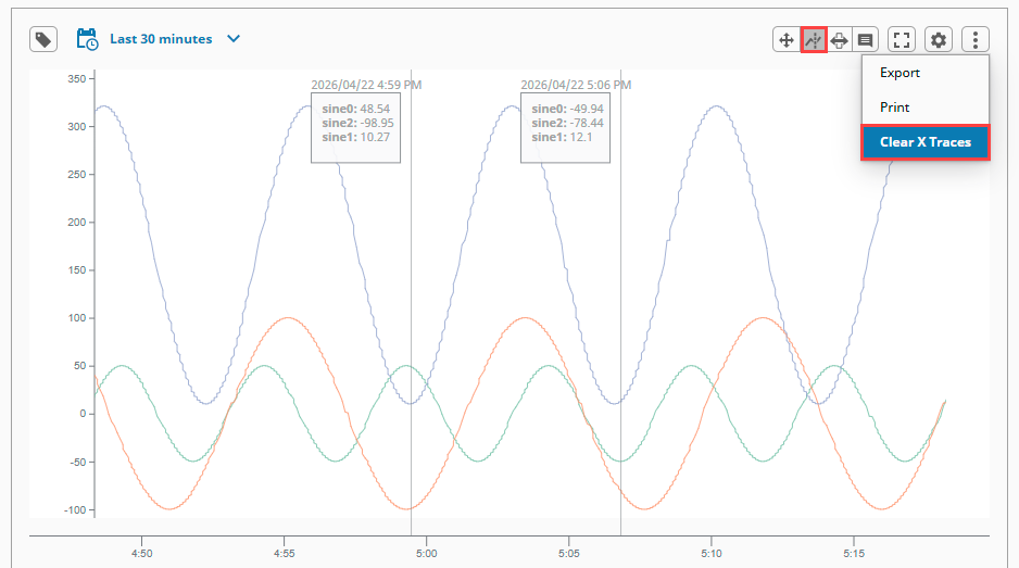

X Trace" "Tap to place a vertical line, which shows an interpolated value for each pen on the plot. To clear the X Trace values, select Clear X Trace from the More Menu. " " The X Trace display now supports numeric locale formatting. Numeric values are automatically formatted based on the Session locale and the xTrace.infoBox.dataFormat property." "
Range Brush" "Allows you to select a range of data on the chart. While a brush is active, the Pen Control Table will show aggregate summaries for the pens over the selected range. Multiple brushes will create multiple aggregation summaries.
Individual selections can be removed by clicking the trashcan icon in the Pen Control Table, or by selecting Clear Range Brushes on the More Menu." "

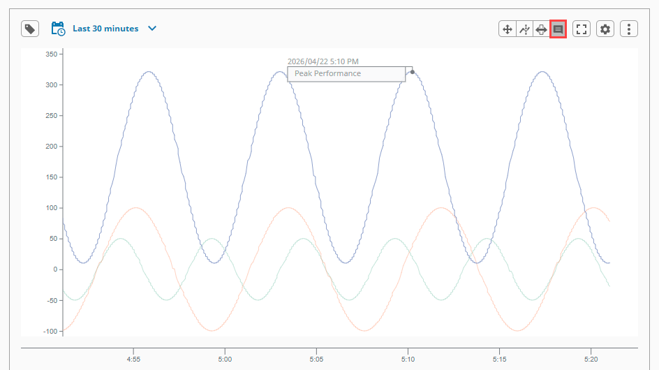

Annotate" "Click near a trend, line, or data point and you'll have the opportunity to add an annotation. The annotation is stored with the Historian system, on the sqlth_annotations table. Annotations can edited by clicking the Edit icon and deleted by clicking the Delete icon, which appear when hovering over the annotation. " "
Full Screen" "Puts the chart into full screen mode.
Settings" "Opens the Chart settings panel, allowing users to modify various aspects of the chart from the Session. There are four tabs: Axes, Pens, Plots, and Columns. Click to see the settings options.
More Menu" "Provides additional contextual options, depending on the current state of the chart. The button to open the More Menu only appears if there is at least one pen on the chart. Click to see the More Menu options.

More Menu​
OptionDescription
ExportTakes the datapoints visible on the various plots, and exports them to a CSV.
PrintOpens print dialog box so user can print the chart.
Clear X TracesClears all X Traces on the chart. Only appears when there are X Traces on the chart.
Clear Range BrushesClears all range brushes on the chart. Only appears when there are brush selections on the chart.

config.visibility.buttons Properties​
NameDescriptionProperty Type
showTagBrowserButtonFlag representing the visible state of the Open Tag Browser and Close Tag Browser buttons.value: boolean
showPanZoomButtonFlag representing the visible state of the Pan/Zoom toggle button.value: boolean
showXTraceButtonFlag representing the visible state of the X Trace toggle button.value: boolean
showRangeBrushButtonFlag representing the visible state of the Range Brush toggle button.value: boolean
showAnnotationButtonFlag representing the visible state of the Annotation toggle button.value: boolean
showFullscreenButtonFlag representing the visible state of the Fullscreen toggle button.value: boolean
showSettingsButtonFlag representing the visible state of the Settings toggle button.value: boolean
showMoreButtonFlag representing the visible state of the Show More toggle button.value: boolean
interaction.mode Properties​
panAndZoomConfiguration settings for the chart in panAndZoom mode.
  • freeRange: When enabled, this setting allows panning and zooming to dictate the time range used for the chart display. Value is boolean.
object
xTraceConfiguration settings for the chart in xTrace mode.
  • values: An array of read-only timestamp values representing the visible x-trace positions.
  • infoBox: Configuration to build the box portion of the x-trace display.
    • visible: Whether or not the box is visible. Value is boolean.
    • showTime: Whether or not the time value above the box is visible. Value is boolean.
    • width: The width of the box. Value is numeric.
    • dataFormat: A numeral.js data format for displaying the data for this axis. See https://numeraljs.com for formats.
      Setting the dataFormat property to an empty string will result in no formatting being applied to the value. Useful in cases where a binding is returning the data in a preformatted state. Value is string.
    • dateFormat: The date format displayed when in historical mode using a MomentJS date string (https://momentjs.com). Value is string.
    • timeFormat: The time format displayed when in historical mode using using a MomentJS time string (https://momentjs.com). Value is string.
    • stroke: A configuration object describing the properties that will be applied to the stroke of the box. Click to see stroke properties.
    • fill: The fill configuration. Click to see fill properties.
    • style: Style for the box. Full menu of style options is available. You can also specify a style class.
  • line: Configuration to build the vertical line portion of the x-trace display.
    • visible: Whether or not the line is visible. Value is boolean.
    • color: The color to apply to the line stroke, if applicable.
    • width: The width to apply to the line stroke, if applicable. Value is numeric.
    • opacity: The opacity to apply to the line stroke, if applicable. Value is numeric.
    • dashArray: The spacing to apply between dashes of the line stroke, if applicable. Value is numeric.
object
rangeBrushConfiguration settings for the chart in rangeBrush mode.
  • values: An array of config objects to build each range brush.
    • start: The start timestamp position. Value is string.
    • end: The end timestamp position. Value is string.
  • active: Configuration to build the active range brush display.
    • color: The color of the active range brush.
    • opacity: The opacity of the active range brush. Value is numeric.
    • style: Style settings for the active range brush. Full menu of style options is available. You can also specify a style class.
  • inactive: Configuration to build the inactive range brush displays.
  • color: The color of the inactive range brush.
  • opacity: The opacity of the inactive range brush. Value is numeric.
  • style: Style settings for the inactive range brush. Full menu of style options is available. You can also specify a style class.
object
annotationConfiguration settings for the chart in annotation mode.
  • infoBox: Configuration to build the box portion of the annotation display.
    • font: A configuration object describing the properties that will be applied to the font. Click to see font properties.
  • line: Configuration to build the connecting line portion of the annotation display.
    • visible Whether or not the line is visible. Value is boolean.
  • dot: Configuration to build the dot portion of the annotation display.
    • visible: Whether or not the dot portion is visible. Value is boolean.
    • color: The color to apply to the dot.
    • radius: The radius of the dot. Value is numeric.
    • opacity: The opacity of the dot. Value is numeric.
    • style: The style settings for the dot. Full menu of style options is available. You can also specify a style class.

For this example, we will be configuring history on three tags and adding them to the Power Chart. These tags are available from the Gateway Quick Start project, and the Historian will be the Sample_SQLite_Database.
  1. Double-click the Sine0 tag from the Tag Browser to open the Tag Editor.
  2. Access the History tab to set History Enabled to true and select Sample_SQLite_Database for the Storage Provider.
  3. Select OK.
  4. Repeat these steps for the Sine1 and Sine2 tags.
  5. Drag and drop a Power Chart onto a view.
  6. Place your Designer in Preview Mode.
  7. Expand the Browse Tags panel.
  8. Expand the Historian Provider dropdown until the Sine tags are displayed.
  9. Select the Sine0, Sine1, and Sine2 tags (using Crtl + click) and click Add Selected Tags.
