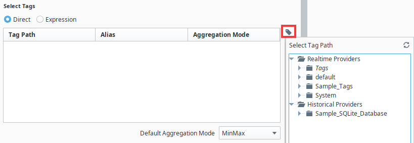

Select TagsAn area to select the tags to trend. Tag paths can be defined directly or using an expression. See Using Dynamic Tag Paths below about Expression mode.
Users may browse for and select tags from both Realtime and Historical Tag Providers.

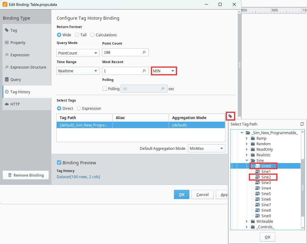

In this example, we'll use a Table component to show the records from some tags that have Tag History enabled.
  1. Drag a Table component onto a view. Select the Table component.
  2. In the Property Editor, click on the Binding icon next to the data property. The Edit Binding screen is displayed.
  3. Select Tag History as the binding type.
  4. In the Time Range section, select and the last 1 minute of data.
  5. Under the Select Tags section, click on the Tag icon. Navigate to the first tag and click OK. Repeat for additional tags. In our example, we chose the Sine0 and Sine2 tags.
  6. Notice the Binding Preview at the bottom of the screen. Click OK to save the Tag History binding.
  7. Back in the view, the Table component now contains a column for the timestamp and one for each tag. Notice how the timestamp does not have a date format.
  8. In order to change the t-stamp values into a date format, in the Property Editor under columns, click Add Array Element....
  9. You'll notice that once the Array Element is added, the other two columns (Sine0 and Sine2) disappeared. We'll add them back in Step 10.
    1. In the field property, enter t_stamp (which is the column name).
    2. For the render property, select date from the dropdown.
    3. Select a dateFormat from the dropdown. In this example, we used the date time format.
  10. Now, let's add the Sine0 and Sine2 columns back into our table by clicking on Add Array Elements... 2 times (refer to the yellow highlights in the image above). There is no need to change any of the Sine0 or Sine2 column properties unless you want to change the default settings or rearrange columns.
    Notice that columns 1 and 2 (Sine0 and Sine2, respectively) are collapsed in this image. To see all the columns properties, expand the columns.
