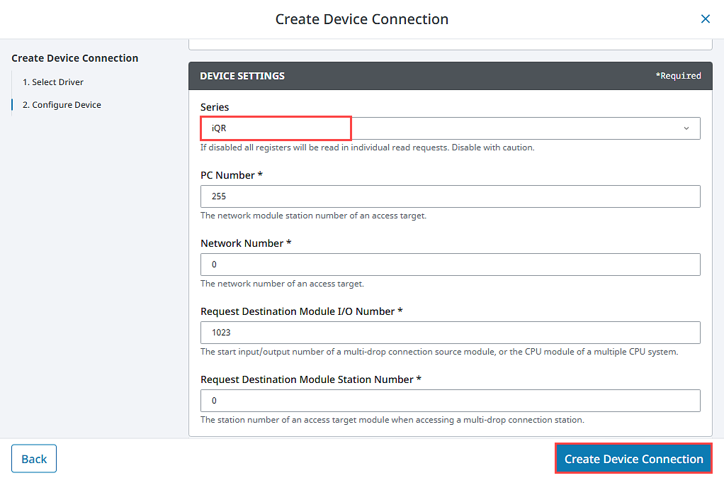

To connect a Mitsubishi Device:
Navigate to Connections > Devices > Connections on the Gateway.
On the Device Connections page, click Create Device Connection.
Select Mitsubishi TCP and click Next.
Fill in the Name field. Entering a description is optional.
Enter the device hostname in the Hostname field.
Enter the device port in the Port field.
Enter the Local Address of the network adapter to connect from if you have multiple network cards and you need to specify the particular network card that has PLC access.
Select the MELSEC series you will be connecting to using the Series dropdown under Device Settings. Options include iQR, iQF, Q, and L.
cautionBe sure to select the correct device type when connecting to avoid causing an error condition on the device.
Leave the default values in the remaining fields.
Click Create New Device.

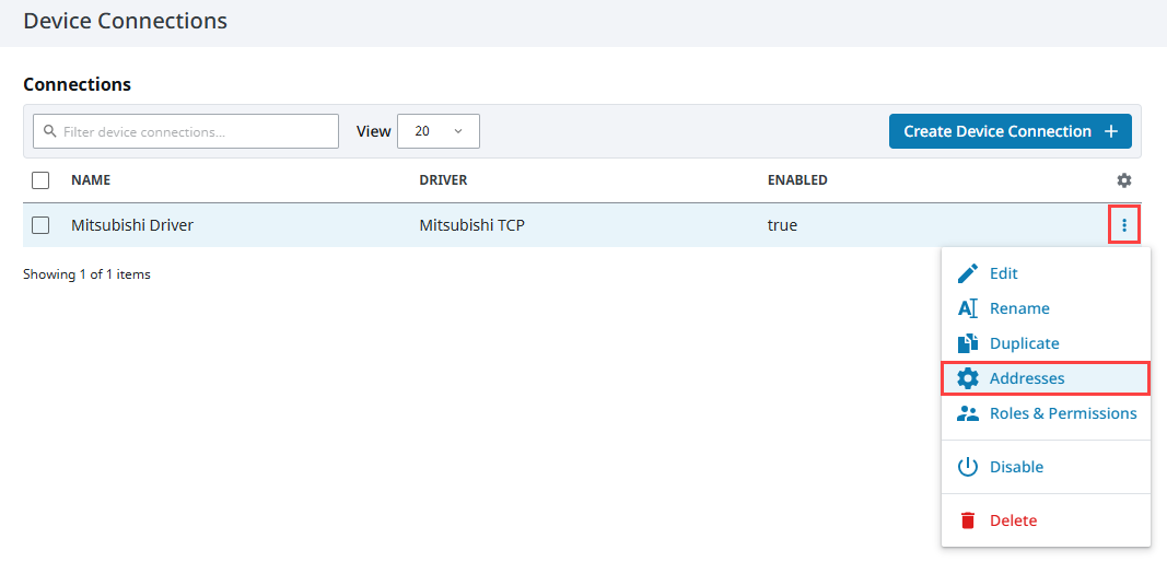

To access the addresses page:
Navigate to the Connections > Devices > Connections.
Expand the three dots menu on your Mitsubishi device and choose Addresses.

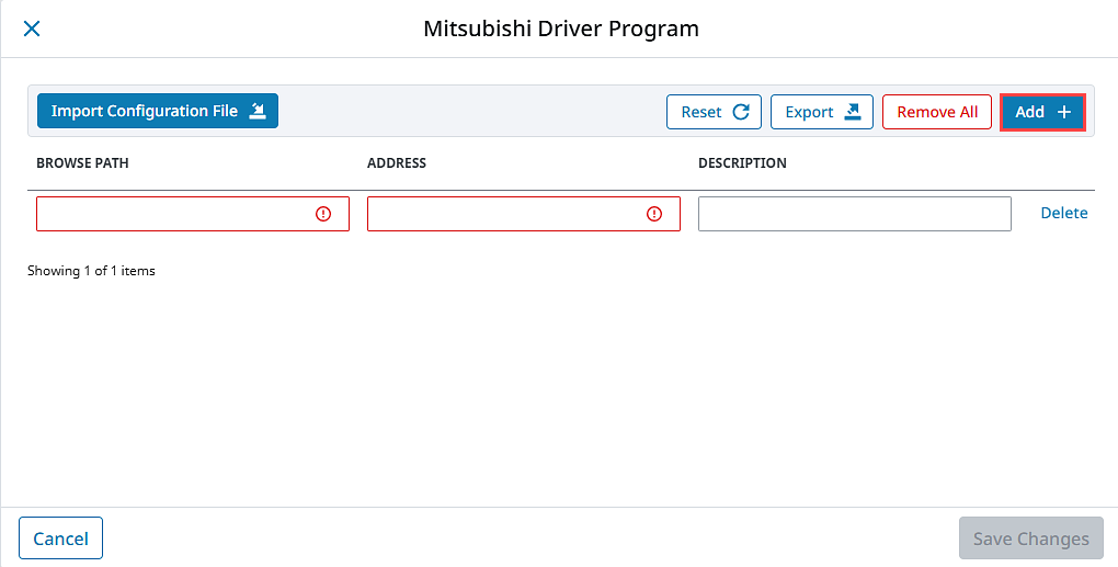

Adding Individual Address Rows
To manually enter addresses:
Click Add + to populate rows for address information.
Enter Browse Path field and Address field information. Enter Description information as desired.
noteAll components are case-insensitive.
Continue adding rows and address information until you’ve added all the addresses you want to be available as tags.
Click Save Changes when you are finished.

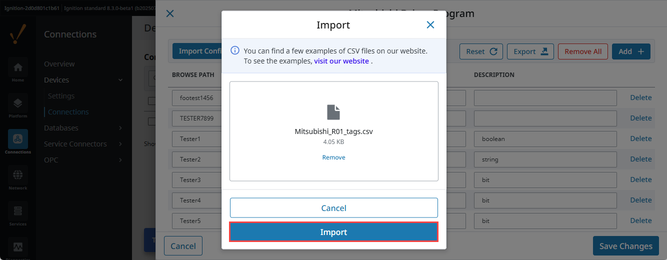

To import a CSV file:
Select Import Configuration File on the Addresses panel.
Drag your CSV file onto the Import popup or select click to upload to locate the CSV file you want to upload and select it to open.
cautionMake sure a comma separates column information, and if your Description column includes commas, use quotes to prevent misinterpretations when uploading.
Click Import.
cautionIf an existing address shares a tag name with an address imported by the CSV file, it will be replaced with the imported address.
Click Save Changes.
To export the address list, use the Export button to download.
