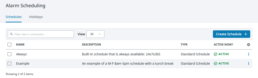

When you first access the Alarming > Scheduling page, you will see an Always and an Example schedule.
  • Always: A built-in schedule that is active 24/7.
  • Example: A pre-existing example schedule consisting of Monday to Friday, 8am to 5pm, with a lunch break.
Click the three dots menu icon and select Edit for a schedule to access the schedule's Edit panel. From the Alarm Scheduling > Schedules tab, you can also see any available descriptions for the alarm schedules, the type of schedules, and if they are currently active under the Active Now column. An alarm will be listed as Inactive when the current day and time don't match the schedule settings, or if Observe Holidays is enabled on a configured holiday. Holidays can be configured on the Alarm Scheduling > Holidays tab, or by using the system.user holiday functions.

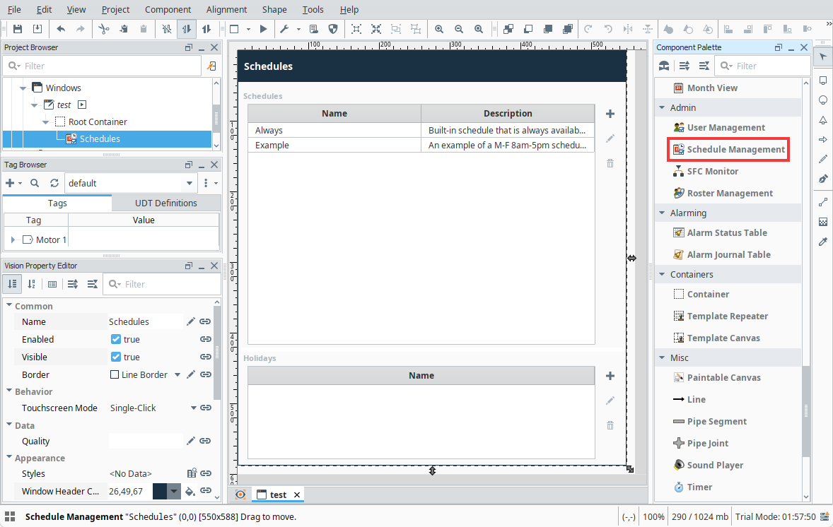

Manage User Schedules from the Vision Client​
There are a few ways to manage user schedules from the Vision Client. The first is to use the Schedule Management component on a window. This component allows you to quickly and easily manage the schedules from the Vision Client.
Vision Client Schedule Management Component
Alternatively, you may instead want to use scripting to manage the schedules. This may offer a more granular control at the click of a button. There are a number of system functions that allow you to create, read, edit, and delete schedules or holidays from a user source using scripting (i.e., system.user.addSchedule, system.user.getHoliday, etc.). To learn what system functions are available for user scheduling and holiday scripting, refer to the system.user functions in the Appendix.
