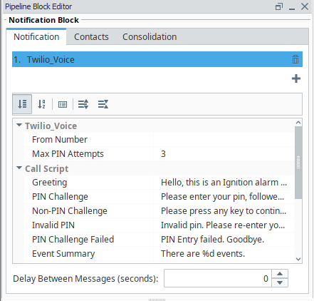

Voice Notification Settings​
SettingDescription
From NumberNumber from which the alarm notification is sent.
Max PIN AttemptsThe maximum number of attempts allowed for a user to correctly enter a PIN when pin validation is enabled.
Call ScriptThe list of messages used by the text-to-speech engine to generate the call message. See the Call Script Options section of the Twilio Voice Notification page for more details.

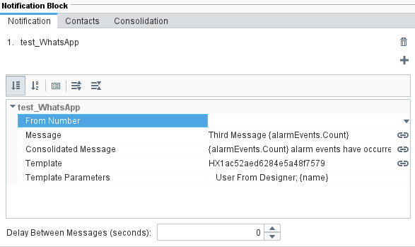

WhatsApp Notification Settings​
SettingDescription
From NumberThe number associated with the Messaging Service used to send WhatsApp messages.
MessageMessage to send. This content will serve as the free-form message. Click the binding  icon to access other alarm properties that can be used for the message.
Consolidated MessageThe message sent when consolidation is turned on, and more than one alarm is being sent. See the Notification Block section for more details.
TemplateThe Template ID of your pre-approved Templates, found in the Twilio Console under Develop > Messaging > Content Template Builder. On Twilio, it is advised to use Utility Templates over Marketing Templates.
Template ParametersOptional parameters to set your template variable values. Each value is keyed by an integer value, which increments per parameter value (i.e., {{1}}, {{2}}, {{3}}).

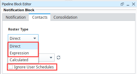

Contacts​
From the Contacts tab, you can specify who you want to send the alarm notification to by specifying what roster type you want to use. There are three different ways to set up a roster.
  • Direct: Set a specific roster to use.
  • Expression: Set up an expression that will determine which roster to use.
  • Calculated: Use scripting to build a roster within the pipeline.
Each has different advantages, so it's important to understand the difference so you can select the method that best fits your needs.

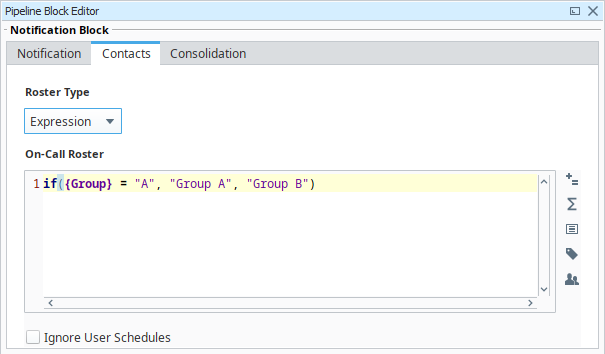

Expression​
The Expression roster type makes it possible to dynamically choose a single, predefined roster from within the pipeline. The expression can make use of Tag values, alarm properties and associated data. The alarm properties are accessible from the Alarm Properties icon located on the right side of the panel. Associated data can be manually entered using the { and } characters. A list of rosters is available from the On-Call Rosters icon.
The above expression checks for associated data named "Group" on the alarm. If the value is equal to "A", the Group A roster is used, otherwise the Group B roster will be notified.

if({Group}= "A","Group A","Group B")
Ignore User Schedules​
This setting allows the notification block to ignore the schedules of any of the users in the roster, notifying users that would normally be "off shift." This setting is available on the Direct and Expression roster types.
caution
Be mindful of your User Source settings when using this feature. Users belonging to User Sources where the Schedule Restricted property is checked means that even though they will received alarm notifications when they are off shift, they will not be able to log in to address any alarms until their assigned schedule is active.
