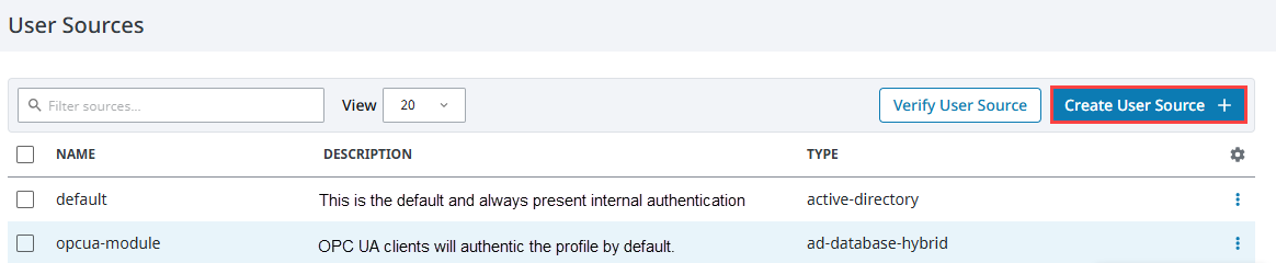

Creating a User Sourceβ
All of the described User Source types can be created by navigating to the Platform > Security > User Sources section of the Gateway. To begin the process, select Create User Source + and choose the User Source type you need. Once you've finished entering the User Source properties, click Create User Source.
The User Source page also includes a Verify User Source option. See the Verify a User on a User Source page for information on how to verify an existing user's profile.

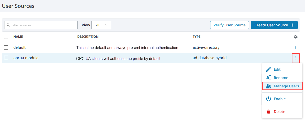

The Default User Sourceβ
When Ignition is installed for the first time, an internal User Source named 'default' is created. You can manage the default User Source by navigating to the Platform > Security > User Sources section of the Gateway.
The Manage Users option under the user source three dots menu dropdown allows you to add new users, modify roles and passwords for existing users, remove users, and add/remove roles from the user source.
When you open the default user source for the first time, you will see the first user that was created at installation. This is the administrator account that has full privileges. If this user source has been modified before, a list of existing users is displayed.

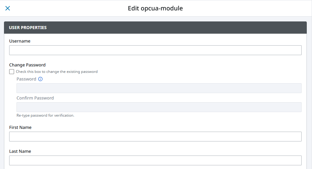

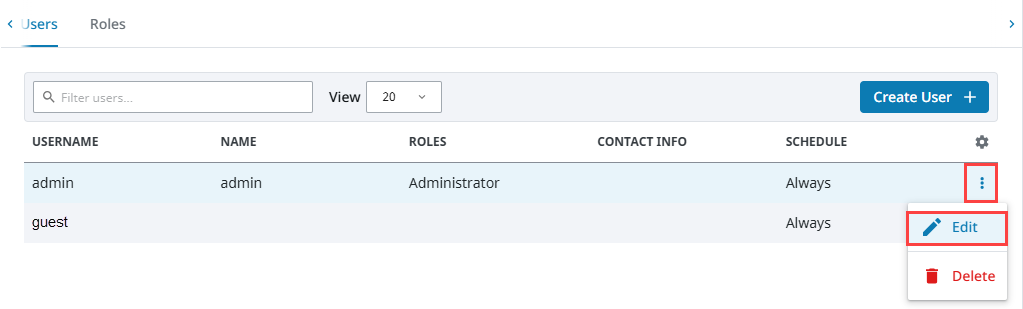

Editing a Userβ
Clicking Edit on the User Source > Manage Users page will access the corresponding Manage Users panel, which allows you to make any necessary changes to that user.
Fill out the fields for that user then click Save Changes.
User Propertiesβ
| Name | Description |
| Username | The name of the user. |
| Change Password? | Check this box to change the existing password. |
| Password | New password. The password policies set for the internal User Source this user belongs to will is listed under the password field for better requirement visibility when creating user passwords. If any password requirement changes are desired, they must be made to the User Source. |
| Password | Re-type password for verification. |
| First Name | First name of the user. |
| Last Name | Last name of the user. |
| Roles | Role(s) assigned to this user. Check the box next to each role you want this user to have. |
| Schedule | Schedule for the user. Choose from a dropdown list of schedules that are already defined. |
| Language | Language to be used for the user. Choose from a dropdown list of languages that are already defined. |
| Notes | Any notes for this user. |
| Badge | A string that represents the value set for the user's badge. |
