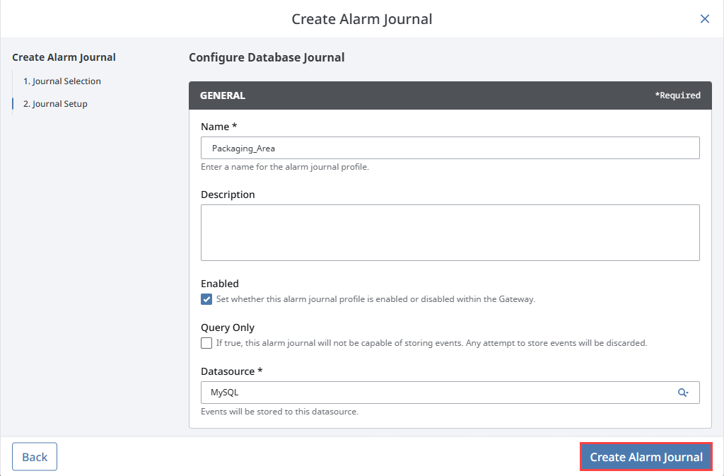

Create an Alarm Journal to Log Events to an External Database​
In Ignition, an Alarm Journal stores historical information about alarms in a database. It can store basic data about alarms that have occurred, such as source and timestamp, along with associated data on the alarm, and the values of the alarm's properties at the time the event occurred.

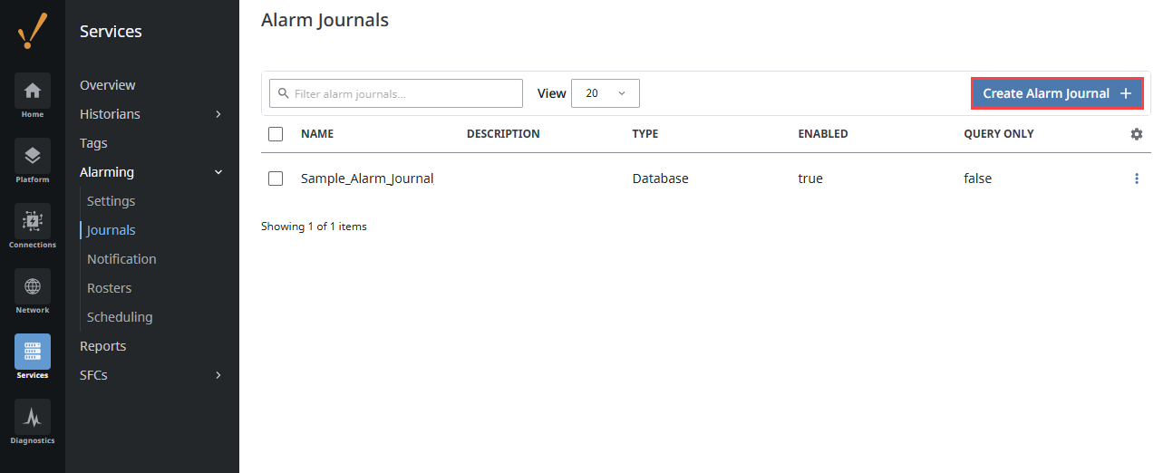

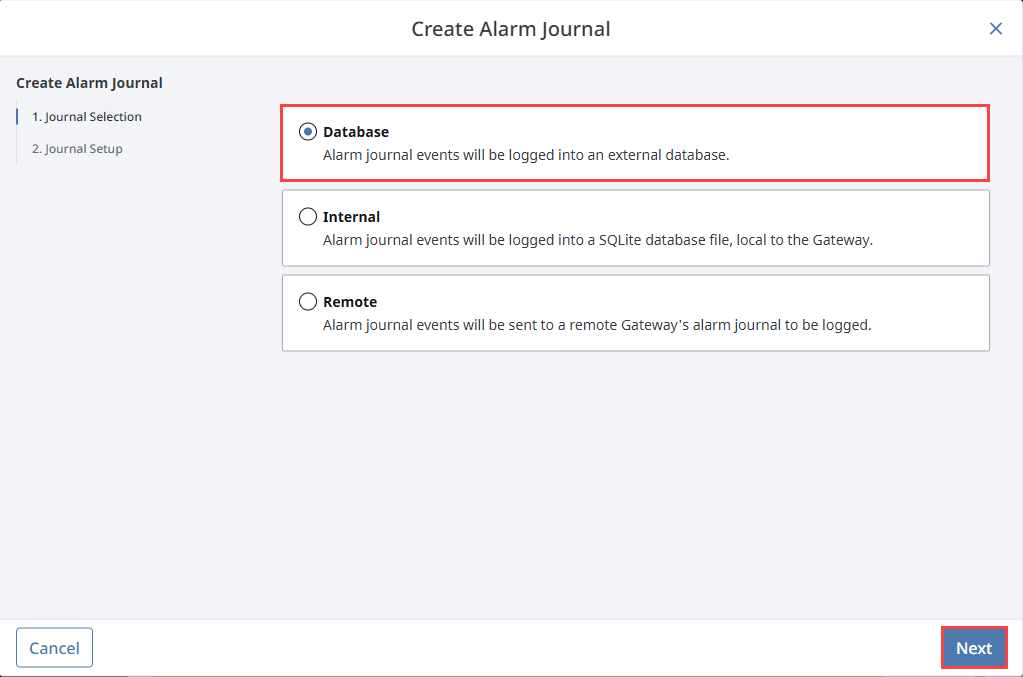

  1. Go to the Services section of the Gateway.
  2. Choose Alarming > Journals from the menu on the left.
  3. Click Create Alarm Journal +. The Create Alarm Journal form will be displayed.

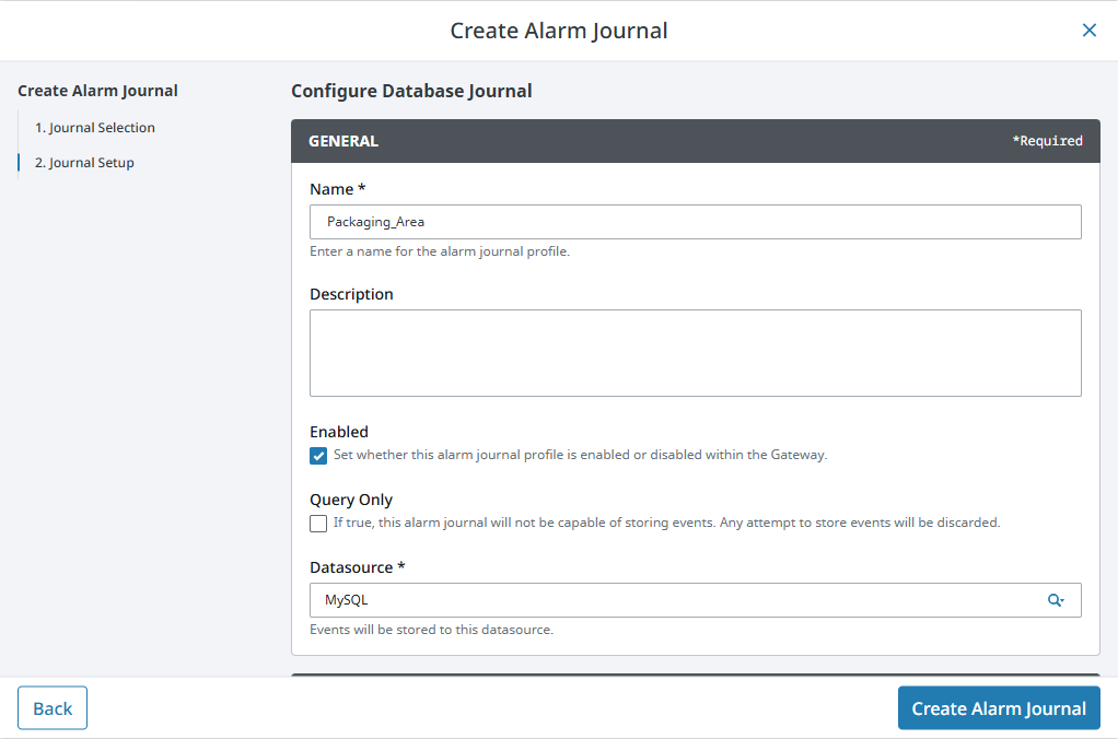

  4. You have the option of logging Alarm Journal events to an external database, logging locally, or sending them to a remote Gateway's Alarm Journal. In this example, select Database, and click Next.
  1. Enter a Name for your Alarm Journal Profile and update other settings as required. Most of the fields have default settings that do not need to be changed. Refer to the journal properties table below for setting descriptions.
  1. Once you are finished, click Create Alarm Journal at the bottom of the form.

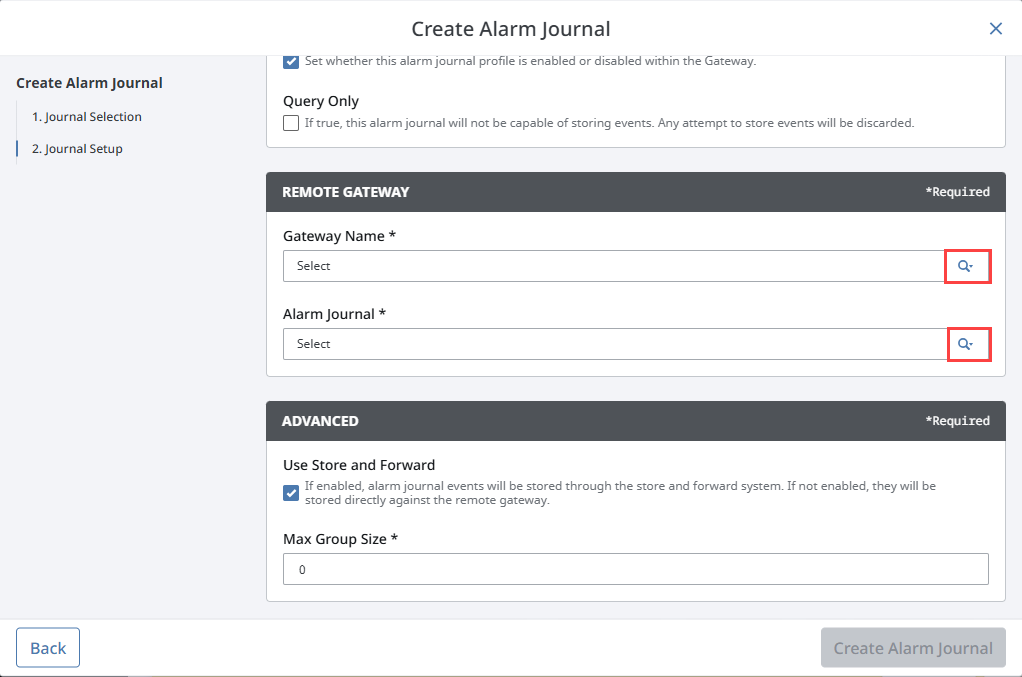

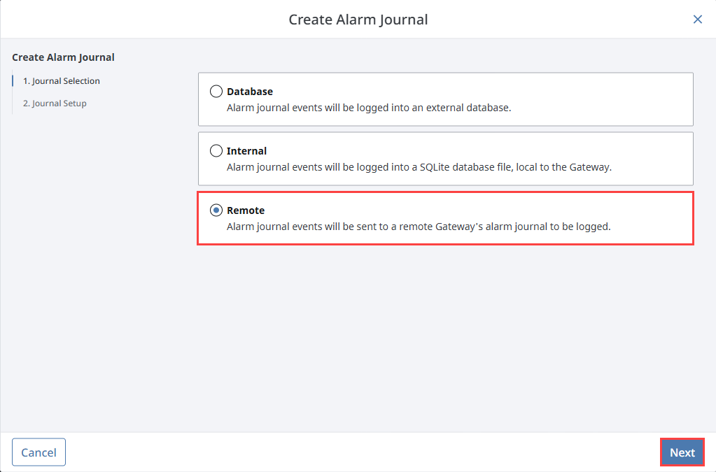

Create a Remote Alarm Journal Profile​
Utilizing the Gateway Network, remote Alarm Journal Profiles allow one Ignition Gateway to send local alarm events to a remote Gateway for journal logging. This type of profile is useful in cases where alarm events need to be recorded by multiple Alarm Journal Profiles. In addition, this type of profile is useful in Hub and Spoke architectures as it allows the hub to record the alarm events from each spoke.
caution
Due to serialization updates, 8.3 Gateways will not be able to store Alarm Journal data to a remote 8.1 Gateway. It is recommended to first upgrade the central server hosting data to 8.3 before upgrading any remote 8.1 Gateways. See the 8.3 Upgrade Guide for more information.
Just like configuring Alarm Journal events to be logged into a database, creating a Remote Alarm Journal Profile is done from the Gateway Services > Alarming > Journals page.
  1. Click Create Alarm Journal +. The Create Alarm Journal form will be displayed.
  2. Select Remote, and click Next.
  1. A list of known Gateways and Alarm Journals will be available through the selection dropdowns. If you don't see a Gateway that you expected to see, check your Gateway Network settings to verify that the connections are valid.
  1. When all settings are configured, click Create Alarm Journal.
You will receive a successful message stating your new Alarm Journal Profile is created.

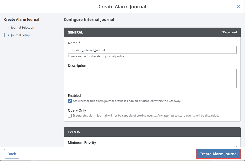

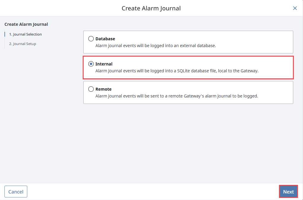

Create an Internal Alarm Journal to Log Events Locally​
Ignition Gateways can also create an Internal Alarm Journal Profile that stores journal entries locally. Go to the Gateway Services > Alarming > Journals page to create an Internal Alarm Journal Profile.
  2. Select Internal to have your alarm journal events logged locally, then click Next.
  1. Enter the name of your Alarm Journal Profile and update any settings as required, then click Create Alarm Journal.
note
It is strongly encouraged to set a Data Pruning value for Internal Alarm Journal Profiles to avoid running out of hard drive space.
You will receive a successful message stating your new Alarm Journal Profile was created.

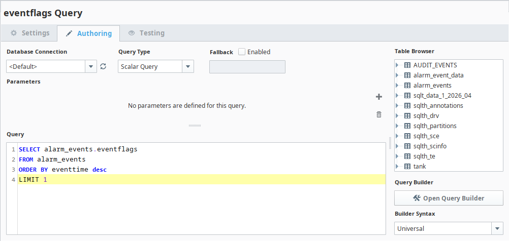

Example - eventflags Property​
The following example helps format the eventflags property's value into a more readable format. The script uses a Named Query to get the most recent alarm's eventflags value and prints the result as a list of strings, corresponding to their bit value. This example assumes you have at least one Alarm Journal alarm event.
Get the most recent eventflags value using a scalar Named Query
SELECT alarm_events.eventflags
FROM alarm_events
ORDER BY eventtime desc
LIMIT 1
eventflags Property Named Query
tip
Notice that we are using a Scalar Query for the Query Type, since errors for the script below may be thrown if the wrong Type is selected.
Use the Named Query in a script to get the eventflags as a string
