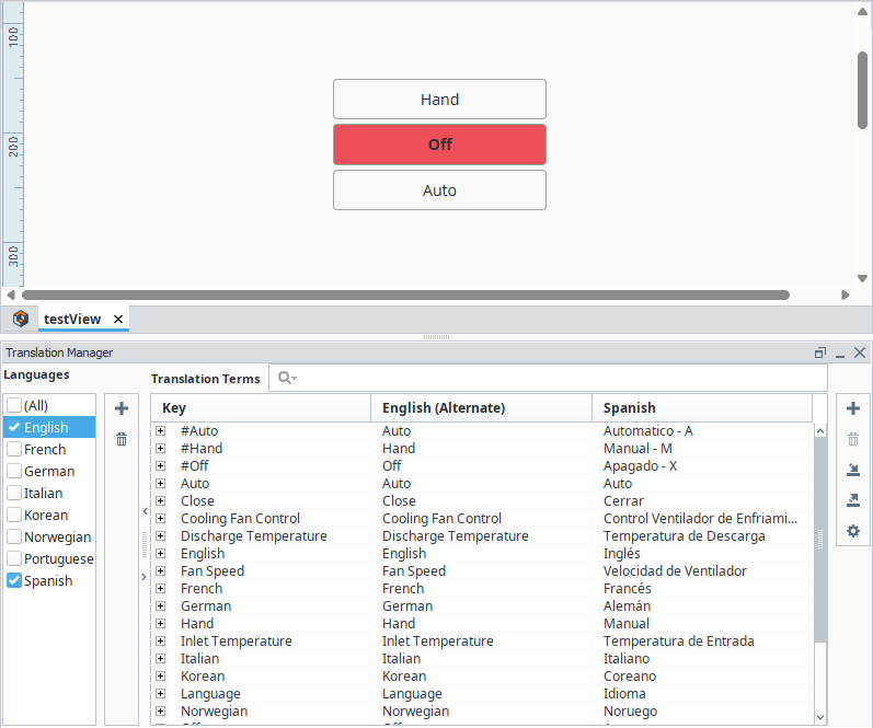

Using common words as keys (such as β€œAuto” or β€œOff”) can sometimes trigger unintended translations if a project term with the same text exists. To avoid this, you can define the values as unique keys by prefixing them with #. This convention applies in both Perspective and Vision, although the configuration steps differ between the two modules.
Perspective​

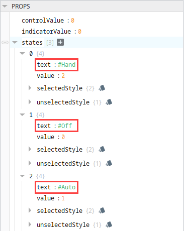

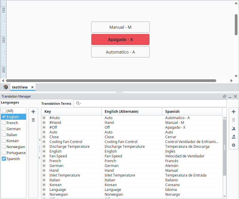

In Perspective, the Multi-State Button component's states, Hand, Off, and Auto are defined in the states[#].text property as #Hand, #Off, and #Auto. Using the prefix ensures these words are treated as keys rather than matching existing project terms.
The keys appear in the Translation Manager, where translations are defined in English and Spanish. When session.props.locale is set to en-US, the button displays the English values.
When session.props.locale is switched to es-US, the button displays the Spanish translations.

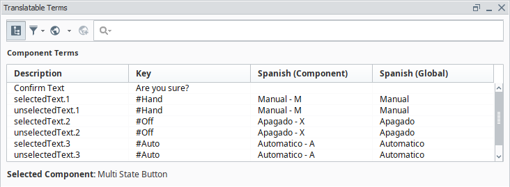

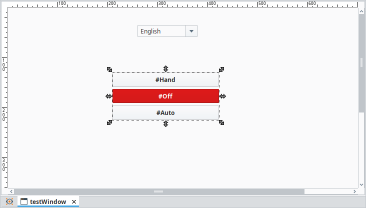

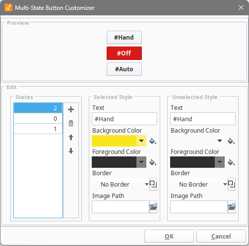

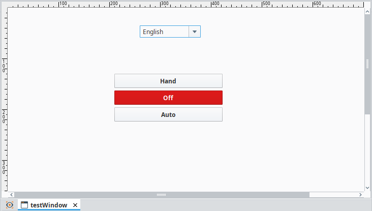

In Vision, the Multi-State Button component's states, Hand, Off, and Auto are defined in the Multi-State Button Customizer as #Hand, #Off, and #Auto. Using the prefix ensures these words are treated as keys rather than matching existing project terms.
The keys appear in the Translatable Terms panel, where translations are defined in both the component and global columns.
In Design Mode, the button displays the untranslated keys.

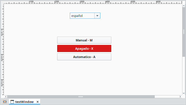

In Preview Mode, the button displays the translated states in English and Spanish.

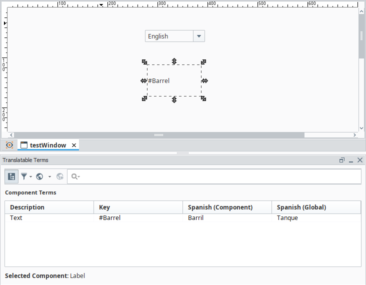

Overriding Vision Components​

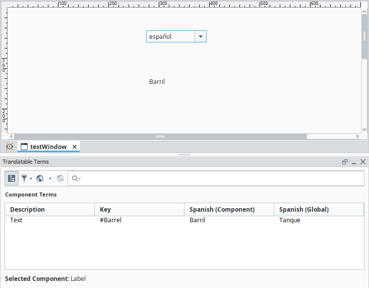

In this example, a Label component was added to the window and its text was set to #Barrel. This created a key in the Translatable Terms panel. The global term translates #Barrel to Tanque, while a component term with the same key translates it to Barril. Because component terms take precedence, the Label displays Barril instead of the project-wide value.
In Design Mode, the Label shows the raw key.
In Preview Mode, the Label displays the component translation, overriding the global term.

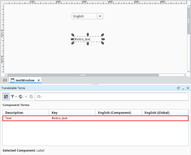

In Vision you can use basic HTML tags to wrap long text values inside components that display text. This allows translations with long sentences or paragraphs to break across multiple lines.

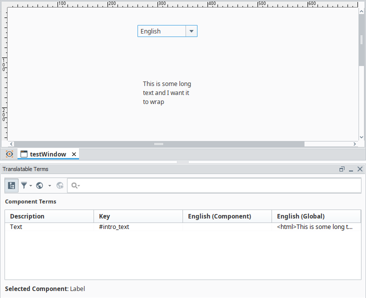

In this example, a Label component is configured with the key #intro_text, and HTML wrapping is used so its text displays neatly in both English and Spanish.
  1. In the Property Editor of a Label component, set the text property to a unique key. In the example below, we use #intro_text.

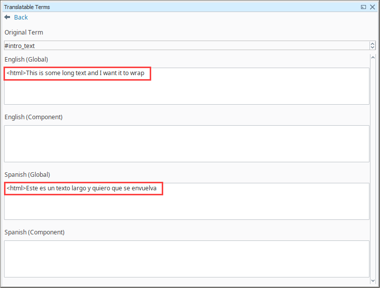

  2. Open the Translatable Terms panel and double-click the term row to add translation values for each language.
    note
    You can open the Translatable Terms panel by right-clicking the component and selecting Translations.
  3. Begin the value with <html> to enable wrapping.
    Translation Values
    # English
    <html>This is some long text and I want it to wrap
    # Spanish
    <html>Este es un texto largo y quiero que se envuelva

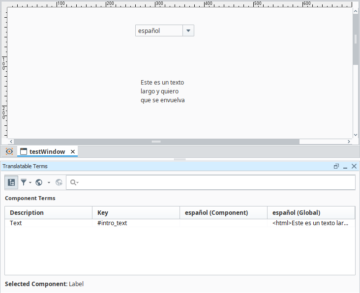

  4. In Preview Mode, the Label displays the text across multiple lines in English and Spanish. If the component is not large enough to fit the text, only part of the wrapped content will be visible.
