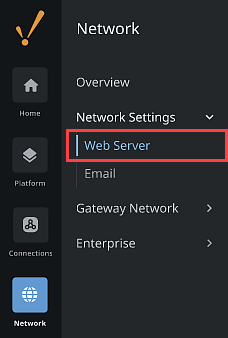

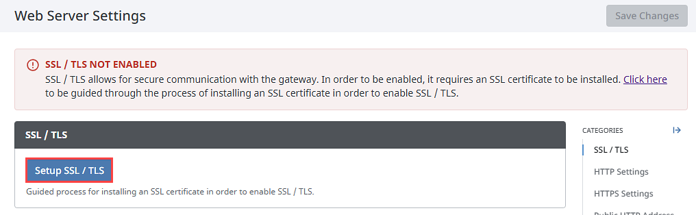

You can access the Web Server Settings page on the Gateway by navigating to Network > Network Settings > Web Server. Before you can use the full page functionality, you'll need to setup SSL/TLS. When completed, you can then export keys, view the details of the SSL certificate, remove the installed SSL certificate, and transition to a CA signed certificate.
SSL TLS Setup

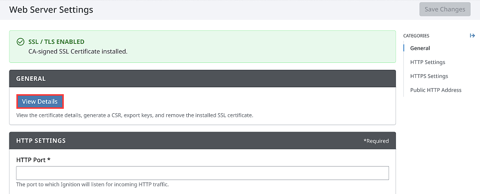

Once you have setup and enabled SSL/TLS, you'll notice the Setup SSL/TLS button changes to a View Details button and the banner at the top of the page changes to state SSL/TLS Enabled.
SSL TLS Settings View Details

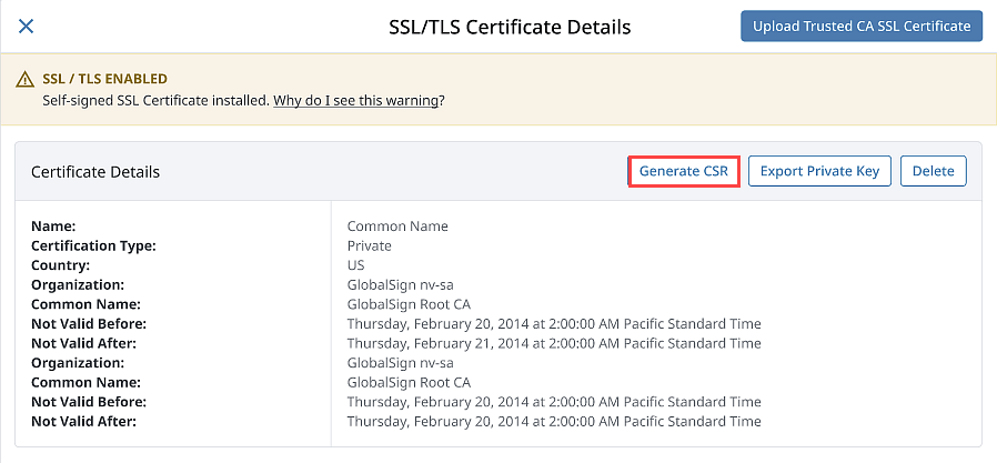

Clicking on View Details will open the Certificate Details panel. In addition to displaying the details of the SSL certificate, you can generate a Certificate Signing Request (CSR) by clicking the Generate CSR button.
SSL TLS Settings Details List
You can also export your private key or delete the certificate itself.
