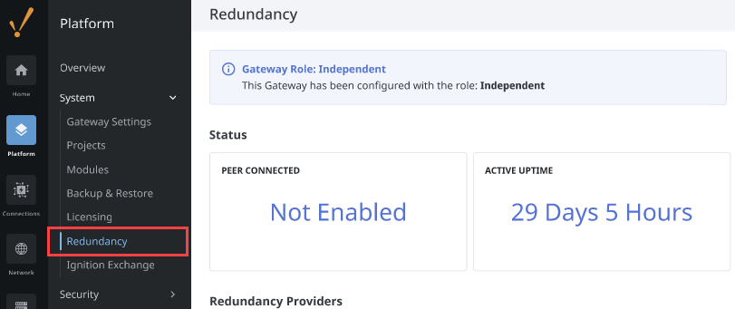

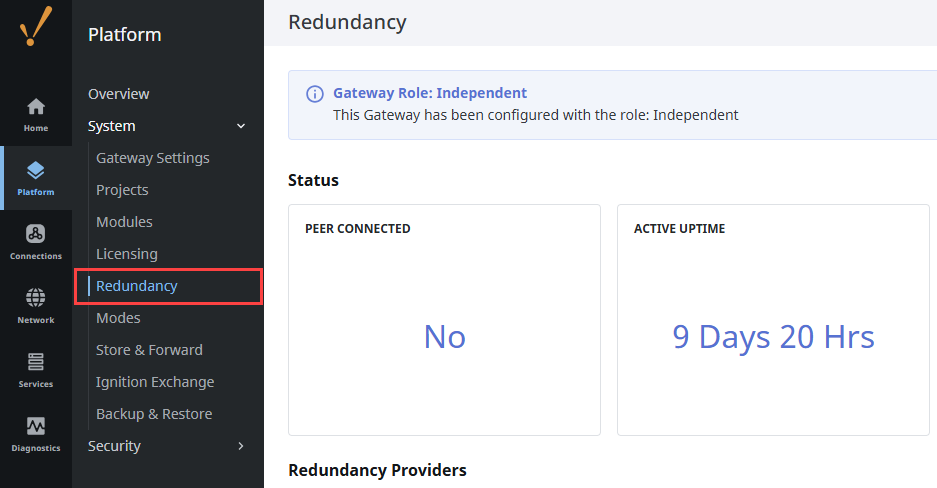

  1. Go to the Platform section of the Master Gateway Webpage.
  2. Select System > Redundancy. The Redundancy page is displayed showing different sections and settings. See the table below for a description of all settings.

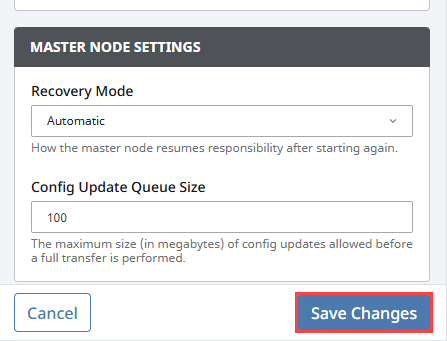

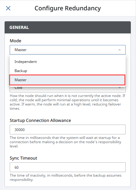

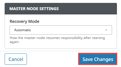

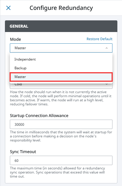

  3. Click Configure Redundancy to change the following settings:
    • Under General settings, set Mode to Master.
    • Optionally, configure any desired settings under Master Node Settings.
  4. Click Save Changes.
  5. Ensure the redundancy mode and state is properly set on the Status banner.

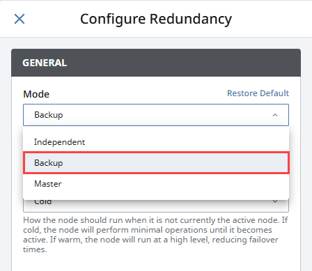

Configure Redundancy On the Backup Gateway​
  1. Go to the Platform section of the Backup Gateway Webpage.
    • Under General settings, set Mode to Backup.
    • Under Backup Node settings, configure the Master Node Address to point to the Master Gateway. The Master Node address is listed as the Local Address on the Master Gateway's Redundancy page under Properties. The Port setting (assuming default configurations) should be 8060 if using SSL, otherwise 8088.
  4. Confirm the redundancy mode and state is properly set on the Status banner.

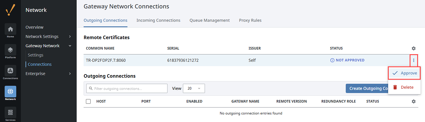

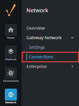

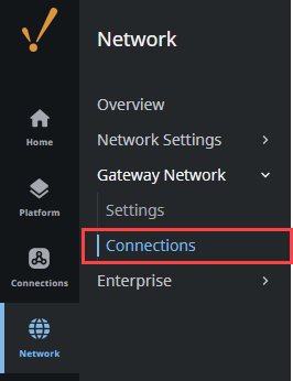

  5. Now, navigate to Network > Gateway Network > Connections. On the Outgoing Connections tab, the Master Gateway certificate will be listed under Remote Certificates.
  6. Expand the three dots menu and select Approve. Select Approve Certificate on the confirmation popup.

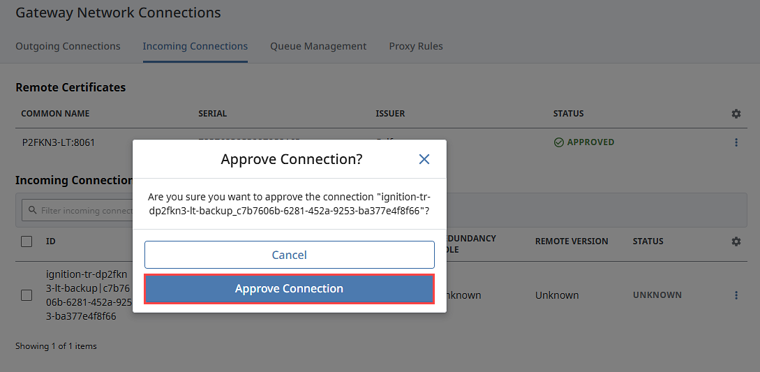

Approve Redundancy On the Master Gateway​
  1. Return to the Master Gateway.
  2. Select Network > Gateway Network > Connections.
  3. Navigate to the Incoming Connections tab. You will now see a new remote certificate from the Backup Gateway.

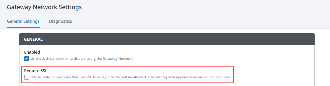

    caution
    If you are not using SSL and your connection isn't displayed, make sure the Require SSL box is unchecked on the Network > Gateway Network > Settings page under the General Settings tab. Clearing the checkmark and returning to the Connections page Incoming Connections tab will now populate your new incoming connection.
  4. Expand the three dots menu. Select Approve. Select Approve Certificate on the confirmation popup.
  5. Your Backup Gateway connection is now listed under under Incoming Connections. Expand the three dots menu and select Approve. Select Approve Connection on the confirmation popup.
  6. To verify the redundancy setup with the Master and the Backup Gateways connected, go the Platform tab of the Gateway Webpages and click on System > Redundancy. The Redundancy pages will show the connected nodes and their current states.

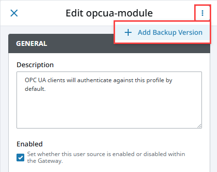

To create a Backup version:
  1. Access the Gateway page that includes the resource requiring different settings.

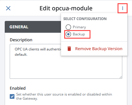

  2. If your resource settings are displayed on the main Gateway page, expand the three dots menu at the top of the page. If the Gateway page lists multiple resources, open the Edit panel for the individual resource and expand the three dots menu at the top of the panel.
  3. Select Add Backup Version.
  4. Select Backup.
  5. Make required setting adjustments.
  6. Click Save Changes.
Keep in mind that any further changes made to a resource once a Backup version is created will need to have the Primary or Backup version selected first. The Primary version will be selected by default.

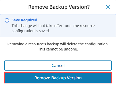

Backup versions can be deleted by expanding the same three dots menu used to create the Backup and selecting Remove Backup Version. When clicked, a popup will appear to confirm the selection with a warning that the change will not take effect until the resource configuration is saved and that deleting the backup cannot be undone.

General Settings​
PropertyDescription
ModeEnable or disable redundancy, and specify this node's role. There should be one master and one backup node per redundant pair. Independent turns off redundancy.
  • Independent - Redundancy is not enabled and this Ignition system runs as an independent node.
  • Master - This is the Master node, who listens for a connection from the Backup node, and is in charge of managing system synchronization.
  • Backup - This is the Backup node, who will connect to the Master and receive system updates.
Standby Activity LevelHow the node should run when it is not currently the Active node.
  • Cold - The system connects to all OPC servers but does not subscribe to Tag values. The Ignition OPC UA server does not communicate with any device, but third party OPC UA servers may still have device connections. This allows the system to standby without putting additional load on the devices and network. Failover takes slightly longer, as Tags must be subscribed and initialized.
  • Warm - The system runs as if it were active, with the exception of logging data or writing to devices, allowing for faster fail-over.
Startup Connection AllowanceThe time in milliseconds that the system will wait at startup for a connection before making a decision on the node's responsibility level. This is used to prevent unnecessary switch over caused by a node starting as active, only to connect and find that the other node is active, resulting in one of the nodes being deactivated. Default is 30000 milliseconds.
Note: It is important to notice that this setting can interfere with the Master Recovery mode:
  • If the Master is active, it will always request the Backup to de-activate.
  • If this setting is low, or 0, the Master will always become active before connecting to the Backup, and thus "manual recovery" will not be possible.
Sync TimeoutThe maximum time in seconds allowed for a redundancy sync operation. Sync operations that exceed this value will time out. Default is 60 seconds

Recovery ModeHow the Master node resumes responsibility after starting again.
  • Automatic - The Master automatically takes back responsibility, and becomes active. The Backup node goes to standby.
  • Manual - The Backup node is allowed to stay active. The Master will become active if the Backup node fails, or if the user requests a switchover from the Gateway configuration page.
