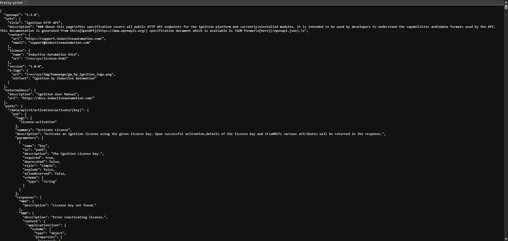

There are two ways to view the web API documentation:
  • Interactive Documentation Page: A browser-based UI for exploring all available endpoints.
  • Raw API JSON Spec: A machine-readable document used for importing into tools or generating client SDKs.

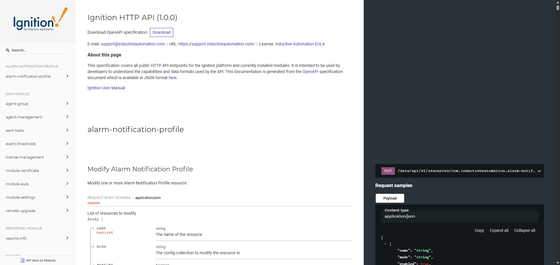

Using the API Documentation Page​
The API documentation is designed to help users:
  • Discover available HTTP endpoints provided by installed modules
  • Understand required parameters, authentication methods, and response formats
  • Integrate with Ignition from third-party tools or services
  • Generate client SDKs using compatible API tools
When browsing the /openapi interface, you can find the required parameters, authentication details, and expected response schemas for each documented route.
Accessing the Documentation​
You can access the API documentation UI from any modern web browser that has network access to the Gateway.
FormatURL Example
Interactive Documentation Pagehttp[s]://<gateway-host>:<port>/openapi
Raw API JSON Specificationhttp[s]://<gateway-host>:<port>/openapi.json
