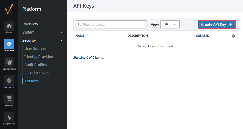

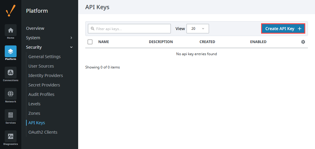

  1. Access your Gateway and navigate to Platform > Security > API Keys.
  2. Select Create API Key +. The Create API Key form will appear.

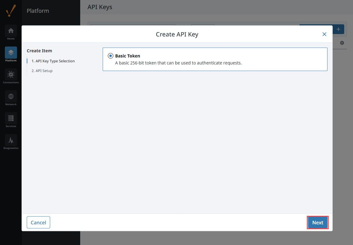

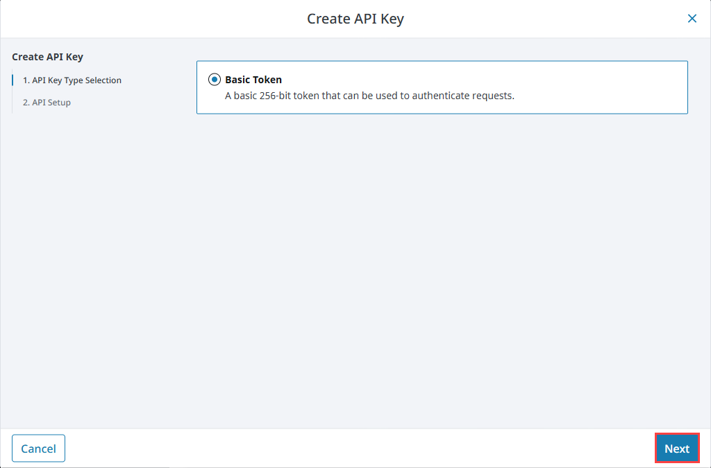

  3. Currently, Basic Token is the only type available. Click Next.

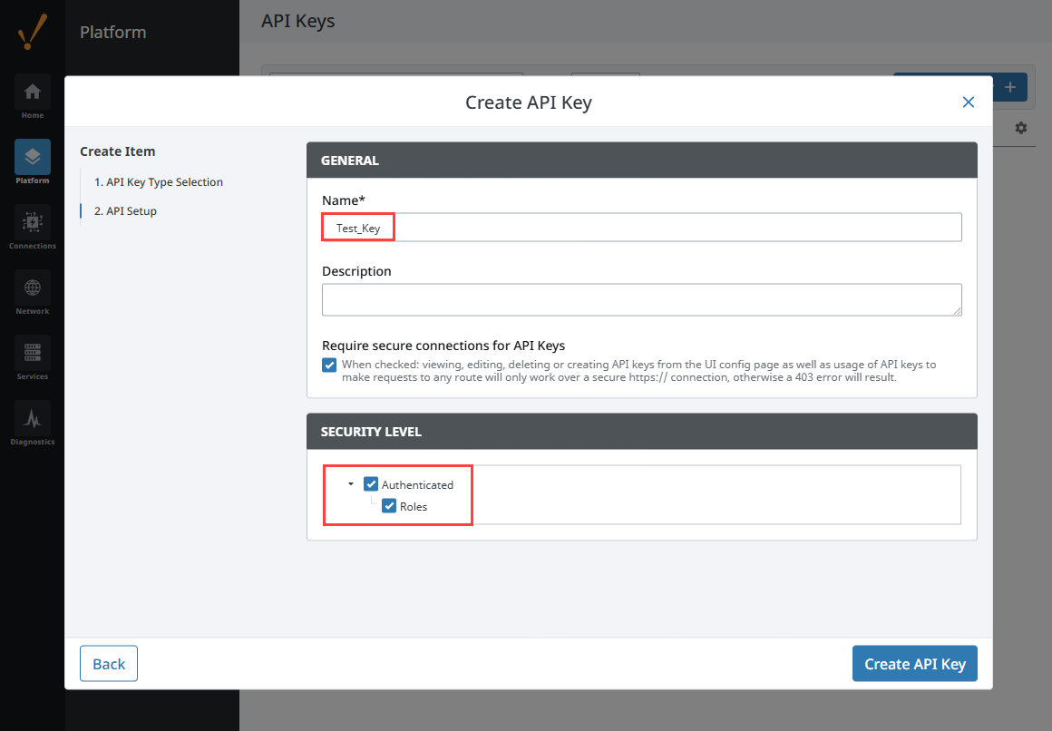

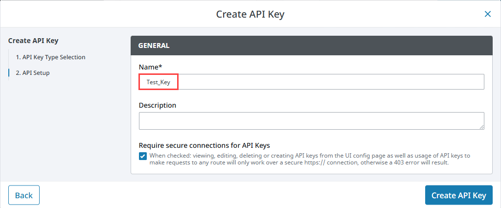

  4. Enter a name for your API Key, and optional description. By default, Require secure connections for API Keys is enabled.
    In this example, the API Key is named Test_Key.

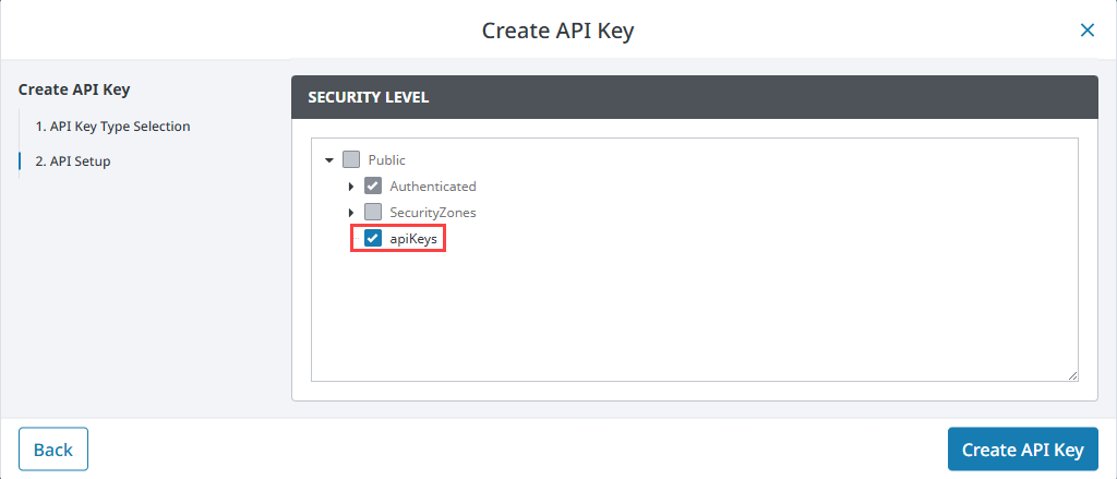

  5. Select security levels for the key. By default, the Authenticated level is selected and cannot be changed. If you need to add more options, they can be created on the Security > Levels page.
    In this example, a new security level named apiKeys was created and selected.
  6. Click Create API Key.

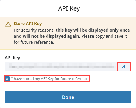

  7. A warning message will appear with your API Key shown. Copy the key and store it securely, then select I have stored my API Key for future reference.
    important
    This is the only opportunity to copy the key and store it securely (i.e., with a reputable password manager or secure vault solution), as it cannot be retrieved again.
  8. Click Done.

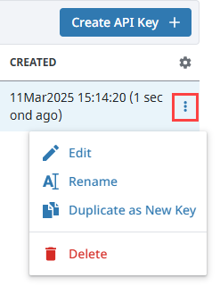

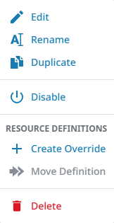

Editing, Renaming, Duplicating, or Deleting​
Open the three dots menu next to a key to choose an action:
MenuAction Descriptions
  • Edit: Modify the key's settings.
  • Rename: Change the key's display name.
  • Duplicate: Copy the key's settings to create a new key.
  • Disable: Temporarily revoke access without deleting the key.
  • Create Override/Move Definition: Manage resource definitions for deployment modes. For details on overriding named resources, see the Resource Definitions section on the Gateway Deployment Modes page.
  • Delete: Permanently remove the key. Deleting an API Key immediately revokes access for any services or applications using it. This action cannot be undone.

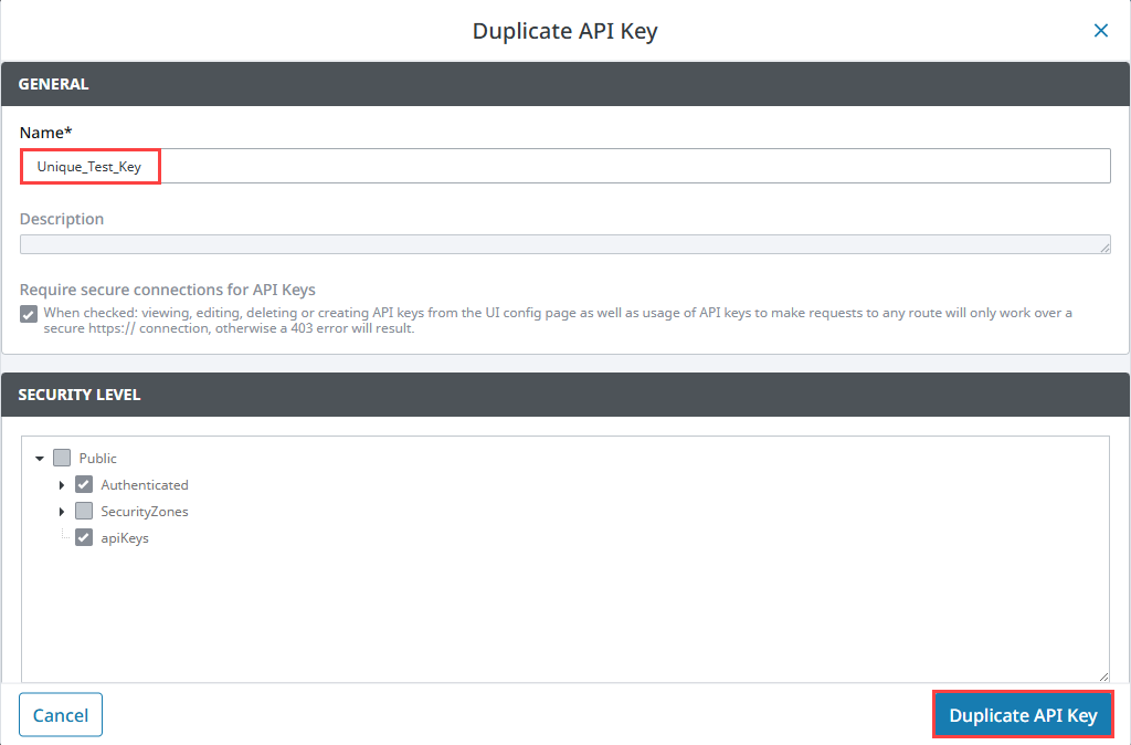

When duplicating, the Duplicate API Key form copies all current settings. Enter a new unique name and click Duplicate API Key.
