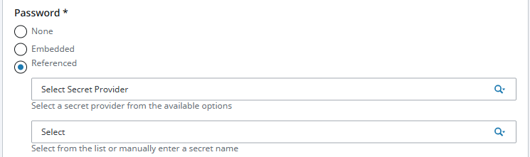

The Secrets Management system replaces standard password and re-type password fields on the Gateway to offer the following three options when creating or editing devices, profiles, and system configurations that require security:
  • None: Confirms no password is needed for the corresponding Gateway system. Although always visible, this option will be grayed out if a secret is required.
  • Embedded: Displays a field to enter a secret. By default the characters will be hidden, but they can be made visible using the SHOW option. An Update Password option will also appear in case the password needs to be changed. This option replaces standard password and re-type password fields. Although secrets are encrypted at rest and hidden by the Gateway UI, the Gateway decrypts all secrets at runtime and privileged Ignition users can obtain access to the decrypted values.
  • Referenced: Displays two new fields for choosing a Secret Provider and secret name for the corresponding Gateway system to reference. Although always visible, this option is only available for configuration when a Secret Provider exists. Like embedded secrets, referenced secrets are encrypted at rest and hidden on the Gateway. They are also decrypted at runtime and can be obtained by priviledged Ignition users.

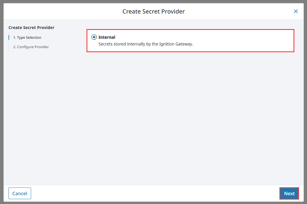

Creating a Secret Provider​
To create a Secret Provider, complete the following steps. This example creates an Internal Secret Provider.

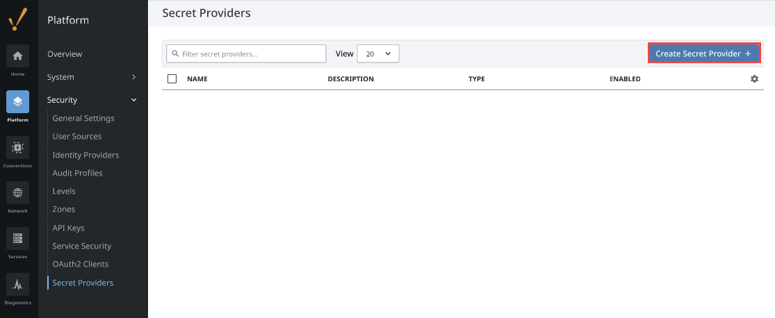

  1. Access your Gateway and navigate to Platform > Security > Secret Provider.

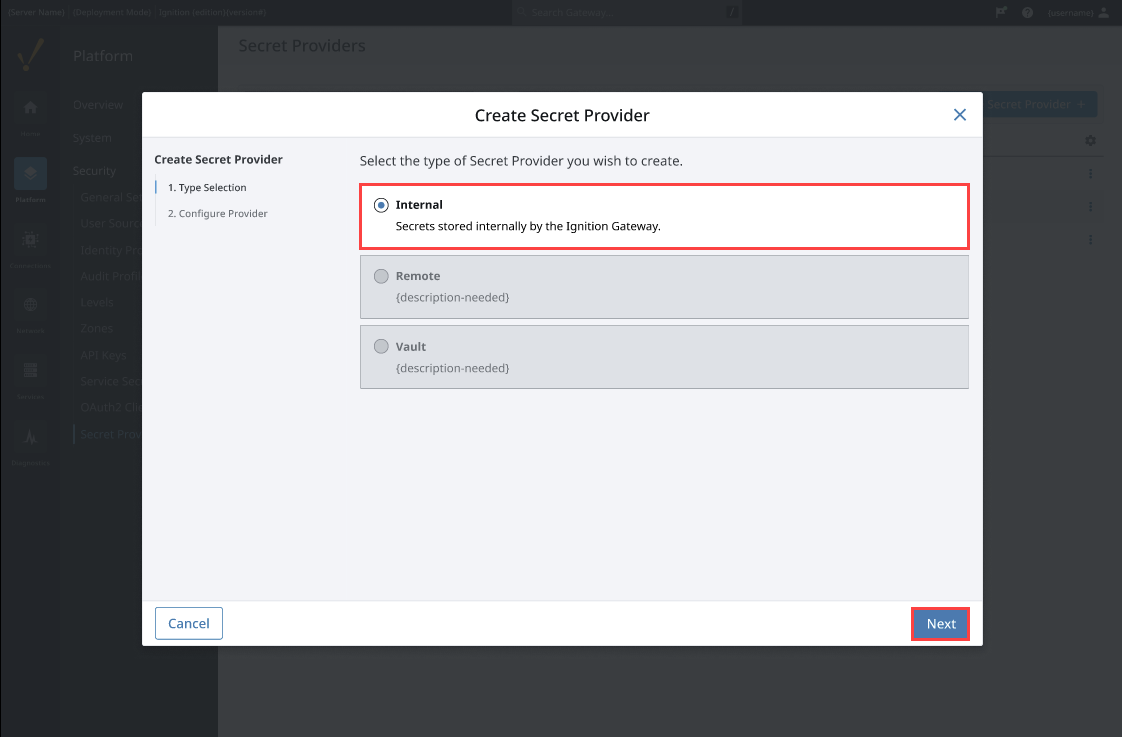

  2. Select Create Secret Provider +. The Create Secret Provider form will appear.
  3. The Create Secret Provider form will appear with Internal selected, click Next.

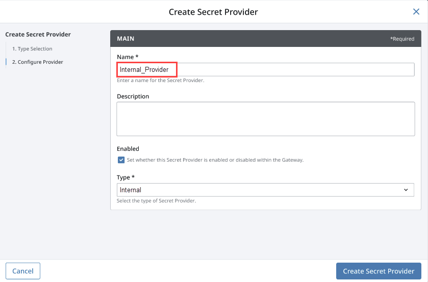

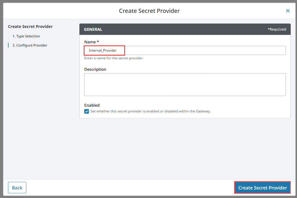

  4. Enter a name for your Secret Provider, and a description as desired. The Secret Provider will be enabled by default. The provider was named Internal_Provider for this example.
  5. Click Create Secret Provider.

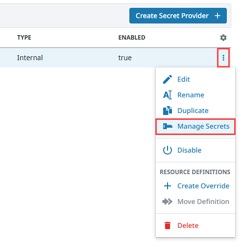

Your Secret Provider will now be displayed on the Secret Providers page where you can expand the three dots menu to make any further configurations relevant to your provider.

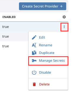

Secrets within a Secret Provider are added and updated on the Manage Secrets panel. Click the three dots menu for the Secret Provider and select Manage Secrets to access the Manage Secrets panel. Note that the Manage Secrets option is only available for Internal Secret Providers as secrets cannot be created with Remote Secret Providers.
From here, you can select Create Secret + to access the Create Secret form. Now, simply enter a name for the secret and the secret value. The Description field is optional. Once added, an encrypted secret value is created. This value cannot be read from the Gateway.
