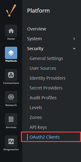

OAuth2 Clients are used by OAuth2 Email Profiles. Additionally, multiple OAuth2 Email Profiles can use the same OAuth2 Client. When configuring an OAuth2 SMTP Email Profile, you can reference the name of your OAuth2 Client to use those properties. To set up or modify OAuth2 Clients, navigate to the OAuth2 Clients section on the Gateway. You can find this section by going to Platform > Security > OAuth2 Clients.

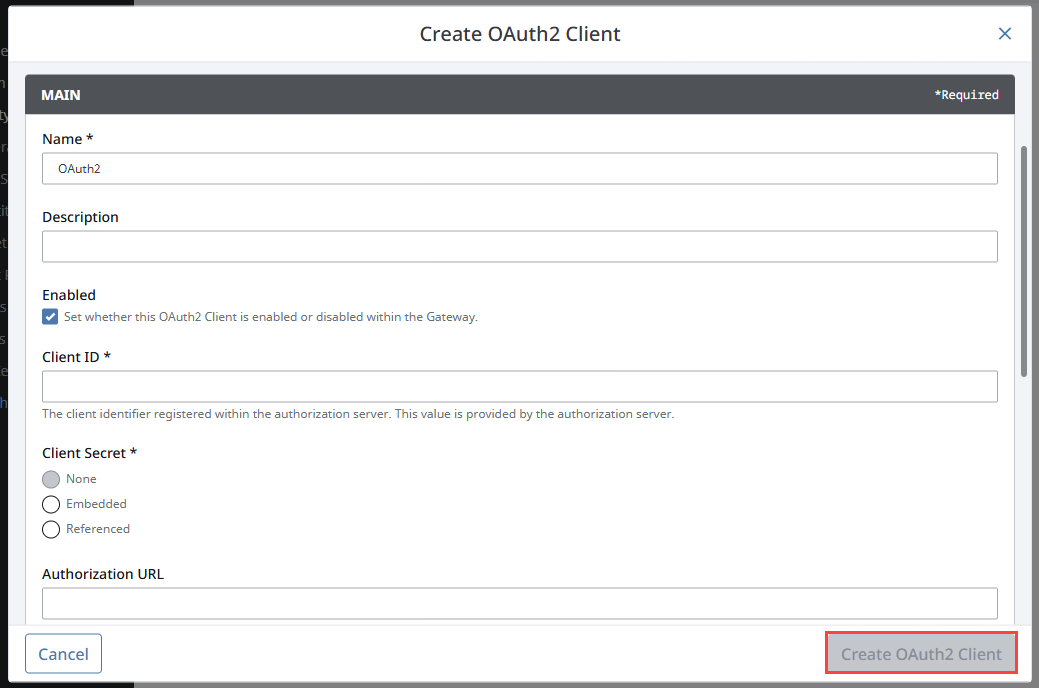

Creating a new OAuth2 Client​

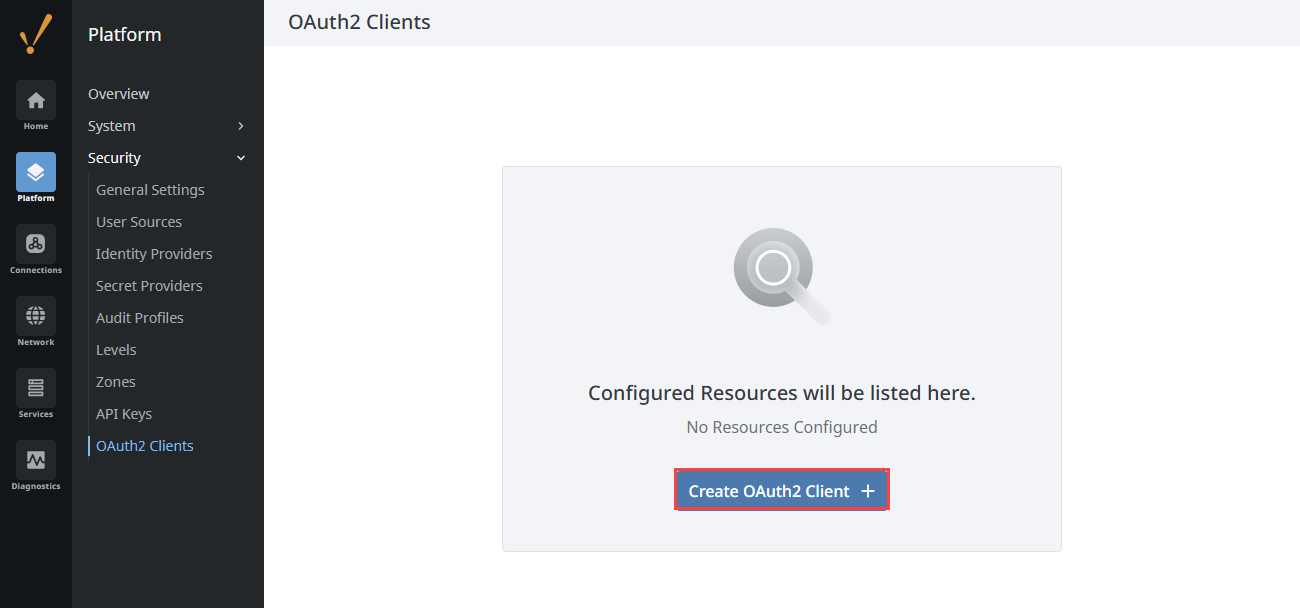

The OAuth2 Clients page is where you can select an existing OAuth2 Client to modify, or create a new OAuth2 Client.
  1. Select Create OAuth2 Client +.
  2. From here, you will be able to configure your OAuth2 Clients by specifying various properties. Fill out the fields on this page.
    Client ID and Client Secret Values
    A Ignition generated URI redirect address for your Ignition server is listed in the information box at the top of the page. In our example it is <http://localhost:8088/data/oauth2/client/{name}/authorize/callback>.
    You need to provide this URI to your IdP (usually this means giving it to your IT department) to add your Ignition server as an application to the IdP. Once done, they can provide you with a Client ID and Client Secret. The Client ID and Client Secret fields are needed for the Ignition Gateway to properly communicate with the IdP.
    If you don't know them yet, you can put in bogus values for now and edit them later once the correct values are provided to you.
  3. Click Create OAuth2 Client once all required fields are filled.

Property NameProperty Description
NameThe name of your OAuth2 Client. This field is important, as redirect URIs will use the name of the OAuth2 Client.
DescriptionA description of your OAuth2 Client. (Optional)
EnabledSets whether this OAuth2 Client is enabled or disabled within the Gateway. Default is enabled.
Client IDThe client identifier registered within the authorization server. This value is provided by the authorization server.
Client SecretThe client secret registered within the authorization server. This value is provided by the authorization server. You can add it directly as an Embedded or select it from the Referenced dropdown if you previously stored it in a Secret Provider.
Authorization URLURL of the authorization server's OAuth 2.0 Authorization Endpoint. (Optional unless using interactive mode or authorization code flow)
Token URLURL of the authorization server's OAuth 2.0 Token Endpoint.

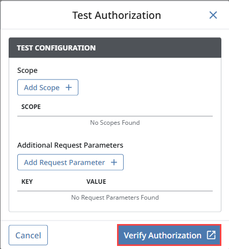

The Test Authorization form allows you to test the integration between the OAuth2 Client configured in Ignition with the OAuth2 Authorization Server. More specifically, it allows you to walk through a test run of the Authorization Code Grant flow. During this process, the authorization server will validate the end user and may prompt the end user to give the Client permissions to perform actions on their behalf, such as sending emails. Once these permissions have been granted, the authorization server will generate an authorization code, which the Client can use to obtain an access token. To see an example of this process work alongside verifying tokens, go to the Verify Authorization and Token Example.
When verifying authorization, you will need to add any scopes you want to test with, along with any additional Request Parameters you want to try. You can find Request Parameters in your authorization server's documentation. Once those fields are filled out, click on Verify Authorization.

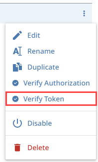

Verify Token​
The Verify Token option is useful in cases where you want to test the authorization code to make sure it successfully gives the Client an access token. It is also useful if you want to test an access token request using a Client Credentials grant, or refreshing an access token using a refresh token. During this process, the Gateway will make an access token request against the authorization server using one of three methods and get a response back. To see an example of this process work alongside verifying authorization, see the Verify Authorization and Token Example.
You can find the Verify Token option on the OAuth2 Clients page by expanding the three dots menu on the far right of the client list.

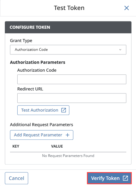

Authorization Code​
If you use an Authorization Code, you will need to enter an Authorization Code, Redirect URL, and any additional Request Parameters. Once you input that information, click Verify Token.

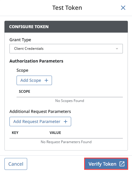

Client Credentials​
If you use Client Credentials, you will need to enter a Scope and any additional Request Parameters. Once you input that information, click Verify Token.

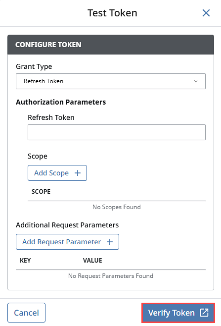

Refresh Token​
If you use a Refresh Token, you will need to enter the Refresh Token, Scope, and any Additional Request Parameters. Once you input that information, click Verify Token.

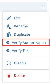

  1. Go to your OAuth2 Clients page on the Gateway. This is located under Platform > Security > OAuth2 Clients.
  2. Set up your OAuth2 Client if you haven't already. For this example, we are using the OAuth2 Client we set up earlier called OAuth2.
  3. Expand the three dots menu and select Verify Authorization. This will bring up the Test Authorization form.

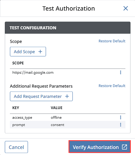

  4. Add any Scopes and Additional Request Parameters for your OAuth2 Client, and then click Verify Authorization.
    note
    The Additional Request Parameters in the example are specific to Google's Authorization Server. They do two things:
    • access_type: Setting this parameter to offline will allow your Client to refresh access tokens while the user is not present at the browser.
    • prompt: Setting this parameter to consent will force the Client to prompt the user for consent.

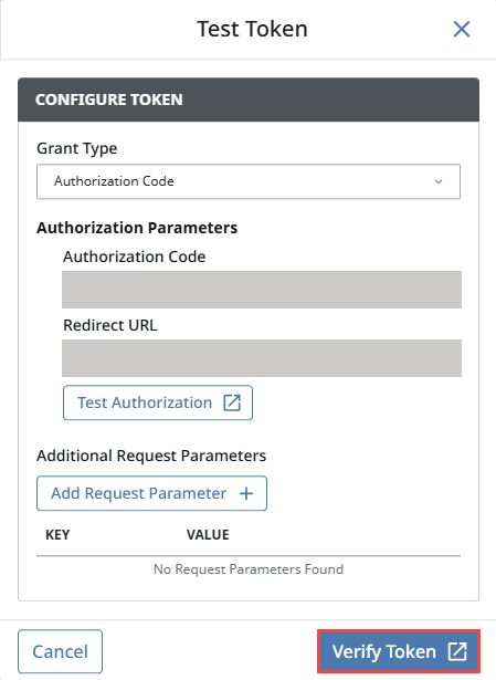

    Besides the main OAuth2 Client page, you can use the Verify Token option on the Authentication Response dialog box to test access tokens. The benefit of testing your token from the Authentication Response dialog box is that some information, such as the Authentication Code and Redirect URL will be filled out.
  7. Click Verify Token on the Authentication Response dialog box. This will bring you to the Test Token form, where some fields will already be filled in.
  8. Click Verify Token to see what the token test results will be.
