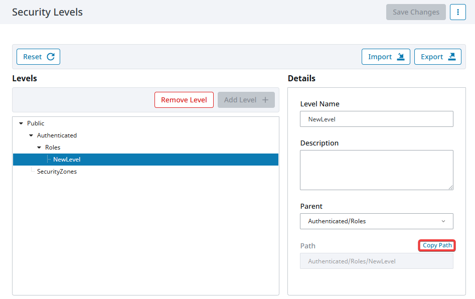

To access Security Levels, go to the Gateway Webpage under the Platform tab, and choose Security > Security Levels. You can copy the selected Security Level Path to your clipboard by clicking Copy Path in the Security Level Details panel.

  1. From the Gateway Webpage Platform tab, click on Security > Security Levels.

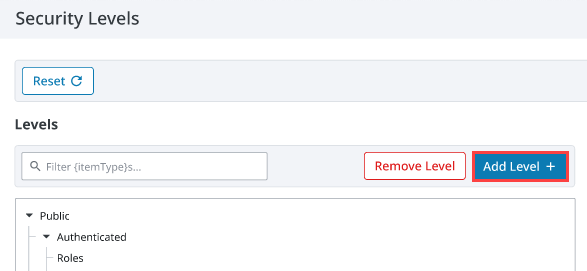

  2. In the Security Level tree, select the level that will be a parent for the new level.
  3. Click the Add Level + button.

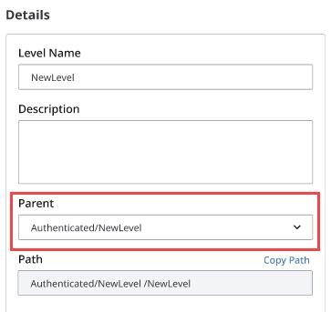

  4. In the Details screen area, enter the Level Name.
    note
    Security Level names within the same parent must be unique.
  5. Add a Description for the new level (optional).
  6. The path for the parent is filled in automatically. Use the Parent dropdown list if you want to change the parent for this new level.
  7. If you make changes to Security Levels, but decide not to save them, you can use the Reset button to return the tree view to its currently saved configuration.
  8. To save the changes, click Save Changes.

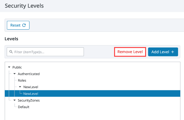

Delete a Security Level​
caution
When you delete a Security Level, all children under that level will also be deleted.
  2. In the Security Level tree, select the level that you want to delete.
  3. Click Remove Level.
  4. In the confirmation box, click Remove to confirm the delete.
  5. To save the changes, click Save Changes.
