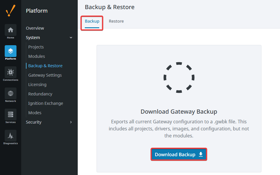

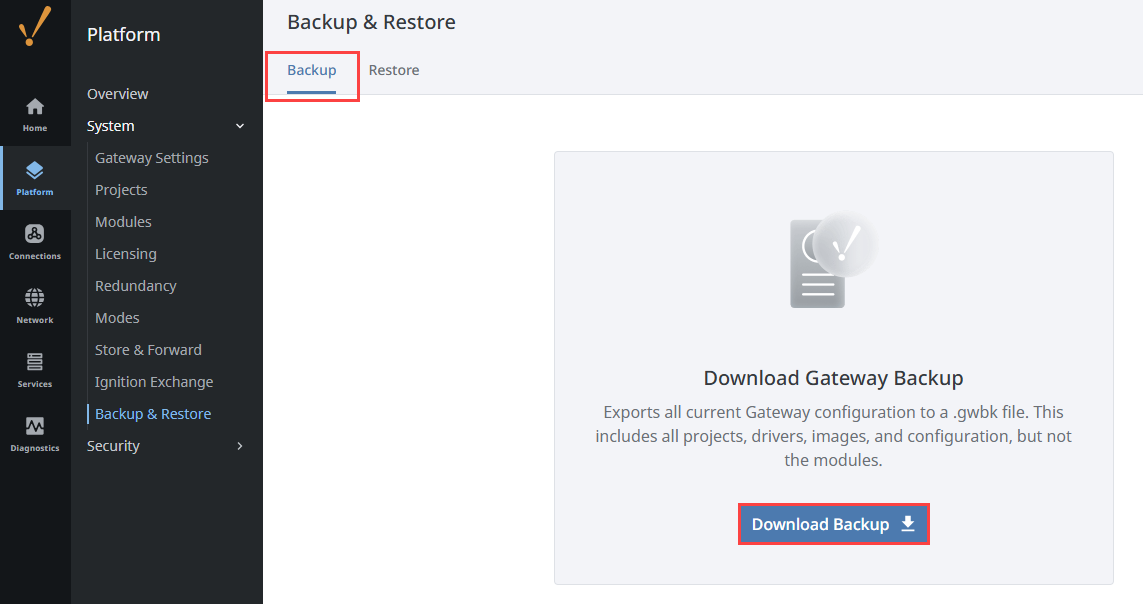

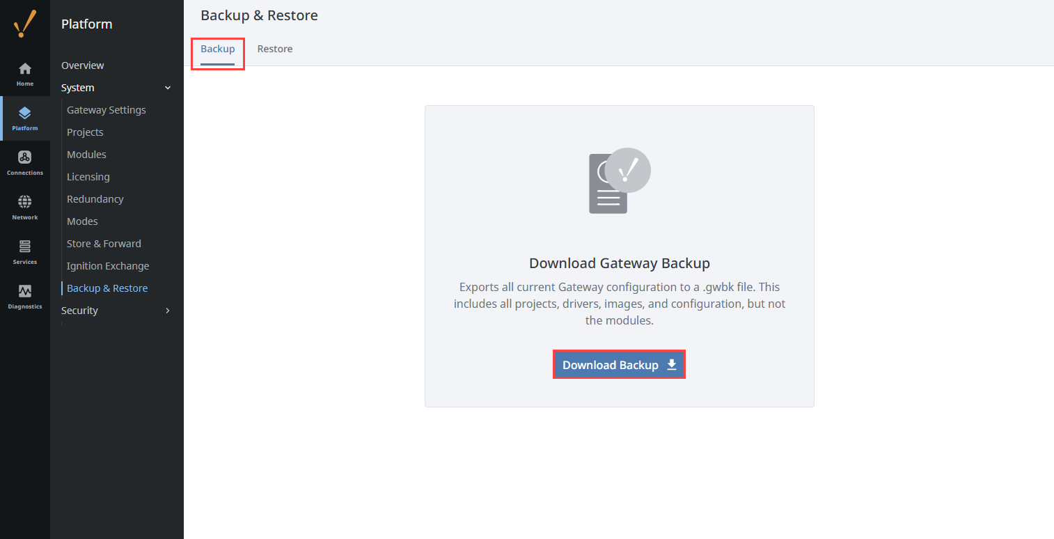

Manually Collecting a Gateway Backup Example​
The easiest way to create a backup of the Gateway is using the Gateway Webpage.
  1. Go to the Platform tab of the Gateway Webpage, and click on System > Backup & Restore.
  2. The System Backup & Restore page will be displayed. Make sure the Backup tab is selected, then click Download Backup.
    Manually Collecting a Gateway Backup Step 2
  3. By default, this downloads a .gwbk file extension to your local file system in your Downloads folder.
    note
    The Gateway Backup default filename will look like GatewayName_Ignition-backup-YYYYMMDD-HHMM.gwbk where YYYYMMDD-HHMM is the timestamp of when it was created.

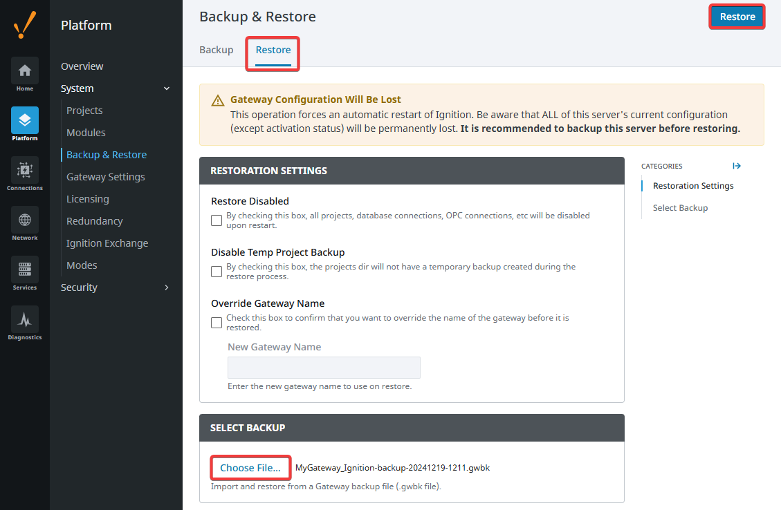

Restoring a Gateway backup is just as easy as backing it up, and it can also be done from the Gateway Webpage.
caution
When you perform a Gateway Restore, ALL of the server's current configuration will be permanently lost. Restoring a Gateway backup overwrites all of the existing settings including your projects. There is no merge option for a Gateway backup. We recommend you always make a backup of the existing server immediately before performing a Gateway Restore.
note
New in 8.3.8
A Gateway backup can also be restored during installation, using the optional Restore from Backup step in the Ignition installer. The selected backup is restored on the first Gateway startup. See Install Ignition for details.

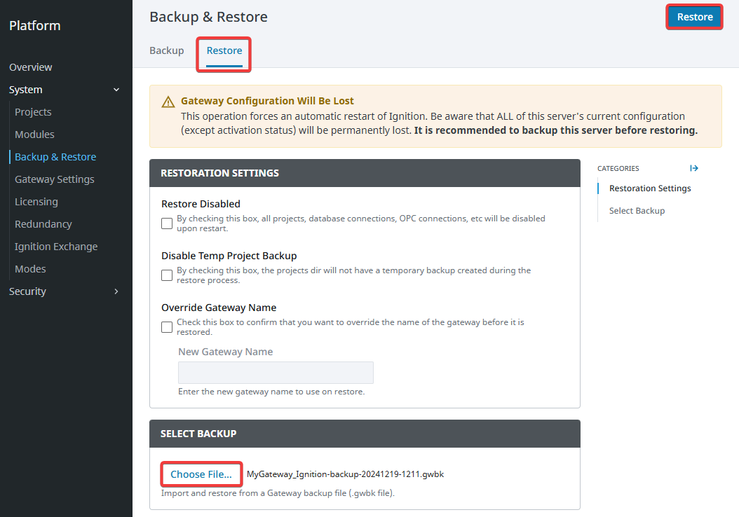

  1. Go to the Platform tab and click on System > Backup & Restore.
  2. The System Backup & Restore screen will be displayed. Click on the Restore tab. Read carefully through the restoration settings, and check the ones you wish to enable.
    note
    If you check the Restore Disabled box, the imported resources will be disabled upon restoration.
  3. Click Choose File, then navigate to your Gateway backup file (*.gwbk). By default, all your Gateway backup files are saved in your Downloads folder unless you select another folder location to choose an existing Gateway Backup file (*.gwbk) to restore.
  4. Choose your Ignition backup file (.gwbk), and click Open.
  5. Click Restore in the top-right of the System Backup & Restore screen. The Gateway stops while restoring the backup file. When restoring is complete, the Gateway restarts itself to apply the restored settings. The Gateway Webpage is refreshed and your projects are loaded and your whole Gateway is restored in less than a minute.
    Gateway Restore Step 5
The following table describes different Gateway restoration settings.
Gateway Restore Settings​
PropertyDescription
Restore DisabledCheckbox for toggling if the Gateway Backup file's contents such as projects, database connections, OPC connections, Tag Providers, etc will be disabled upon restore.
Disable Temp Project BackupCheckbox for toggling if the projects directory will have a temporary backup created during the restore process.
Override Gateway NameCheckbox for toggling if the name of the Gateway should be overridden before the Gateway is restored.
CAUTION: It is not recommended to change the Gateway's System Name after initial Gateway setup. Renaming your Gateway may break critical dependencies, affect data collection, and halt production. To see a list of features dependent on the Gateway name, click here.
New Gateway NameThe name of the new Gateway. Requires "Override Gateway Name" to be enabled.
