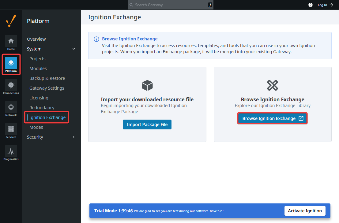

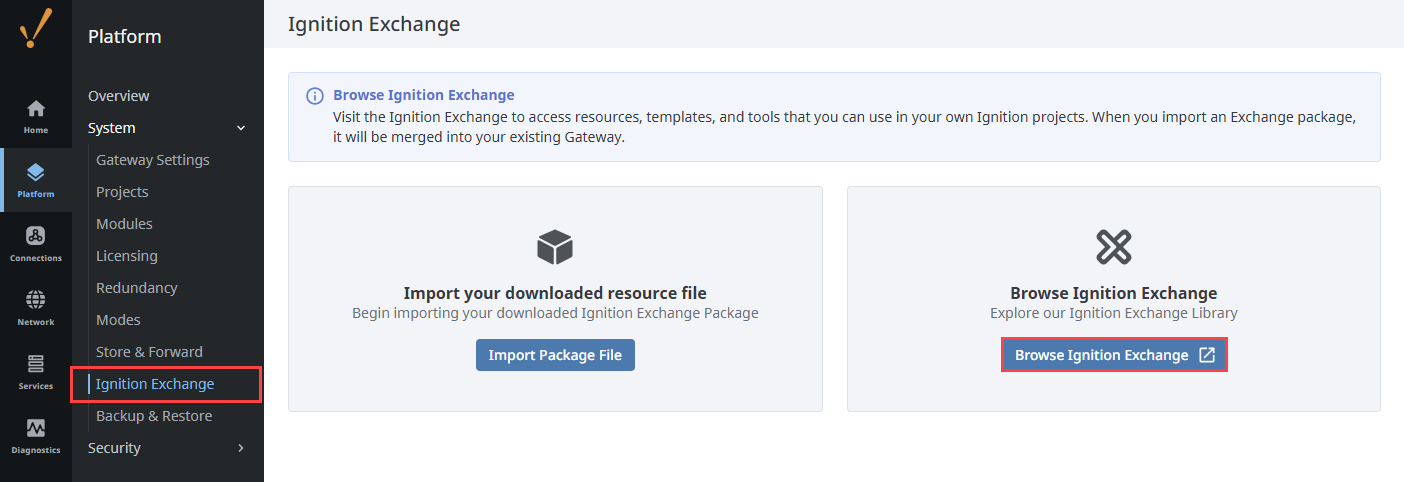

  • Within the Gateway webpage, click on Platform > System > Ignition Exchange. Then click Browse Ignition Exchange.
    Access Exchange Gateway

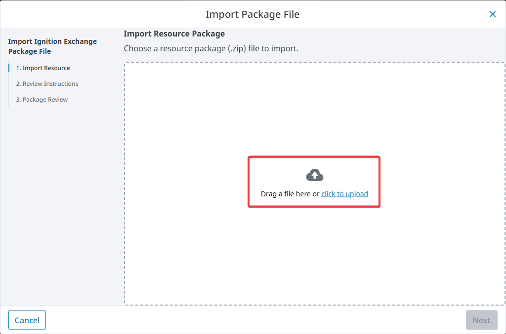

  2. Click on Import Package File.
  3. Drag and drop your resource package file, or click to browse for the file you want to import and click Open.
    Import Ignition Exchange Package from the Gateway Step 3
