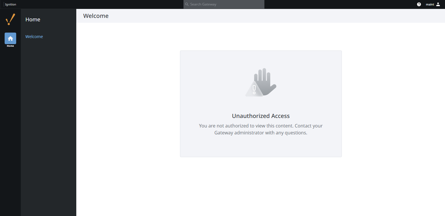

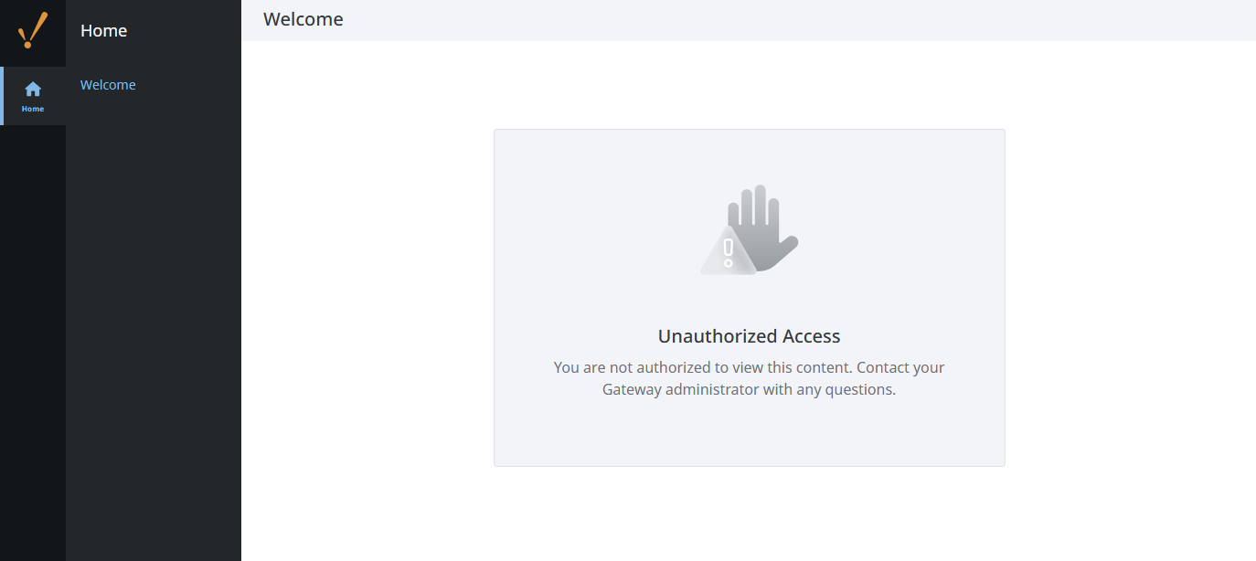

Section Visibility is Based on User Permissions
By default, Home is the only section that can be viewed regardless of login or permission settings, with the exception of the Perspective Sessions and Brand Settings pages. All other sections require a user to be logged into the Gateway with the correct permissions to view all Gateway pages or configure settings on the Gateway. If a user is not logged in or logged in without the proper permissions, a Not Authorized, Page Not Found, or Unauthorized Access message will appear. Gateway Read, Write, and Access permissions can be configured on the Platform > Security > General Settings page.

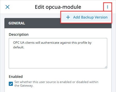

Creating a Backup Version​
Gateway pages and individual resource Edit panels that include Gateway configuration settings will also include a three dots menu in the upper right-hand corner that allows users to add a Backup Version of the settings. This option is available for setting up backup and master node configurations when becoming part of a redundant pair. Refer the Setting Up Redundancy for more information on using this feature.
