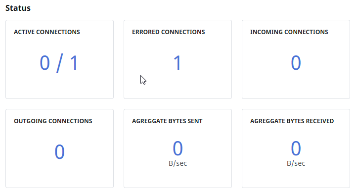

Status​
The top half of the Network Overview page displays aggregate metrics about the Gateway Network connections in your architecture. These metrics include:
  • Number of Active Connections
  • Number of Errored Connections
  • Number of Incoming Connections
  • Number of Outgoing Connections
  • Aggregate of Bytes Sent
  • Aggregate of Bytes Received
Network Status Metrics
