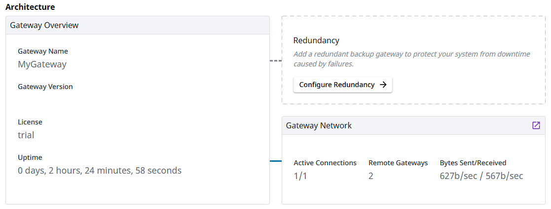

Architecture​
The Architecture segment provides a top down view of your Gateway. You can see your Gateway name, Ignition version, license state, and uptime, as well as similar information with a redundant Gateway, if one is connected. You also get an overview of the Gateway Network including how many active connections there are, and what is the amount of data being transferred between them.

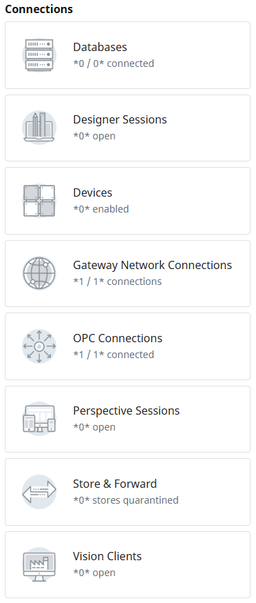

Connections​
The Connections segment shows all of the systems that Ignition is connected to. If any of these have issues, they will be outlined in red. Click on the connection to be taken to the relevant page and view more information about the specified subsystem.

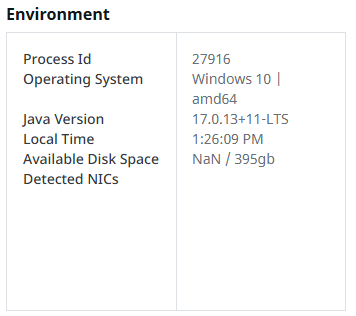

Environment​
The Environment segment provides some basic information about your server such as the Operating System (OS), Java version, available disk space, and IP address of detected network interface cards (NIC).

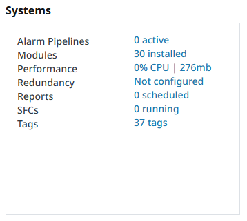

Systems​
The Systems segment summarizes each of Ignition's systems. Here, you can see how many modules you have installed, as well as how many tags are configured in your Gateway, along with a handful of other information. Click on any of the linked system descriptions to find out more information about a particular system.

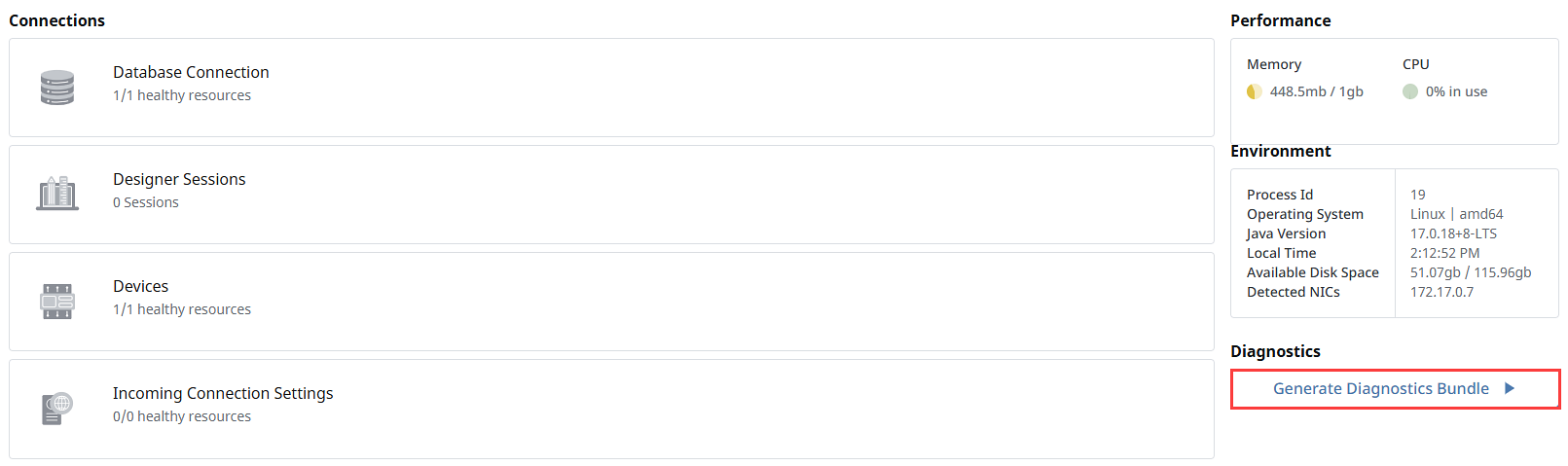

Diagnostics Bundle Export​
The Diagnostics section contains an option to generate and download different sets of diagnostic information at once.
caution
Exporting the Diagnostics Bundle with an increased number of wrapper logs and/or larger-sized wrapper logs may impact Gateway performance or cause the Gateway to restart.
The information included in a Diagnostics Bundle includes:
  • Gateway Information
  • Thread dump
  • Wrapper log file(s)
  • System log IDB
  • Metrics IDB
  • Memory dump
  • Jetty server dump
  • Gateway Network Diagram JSON
Memory Dump Requirements
The memory dump will only be generated if the -Dignition.diagnostic-bundle.enable-memory-dump parameter is set to true, and available disk space is greater than or equal to twice the max heap size. For more information on adding this parameter, see the Gateway and Gateway Network Parameters page.
