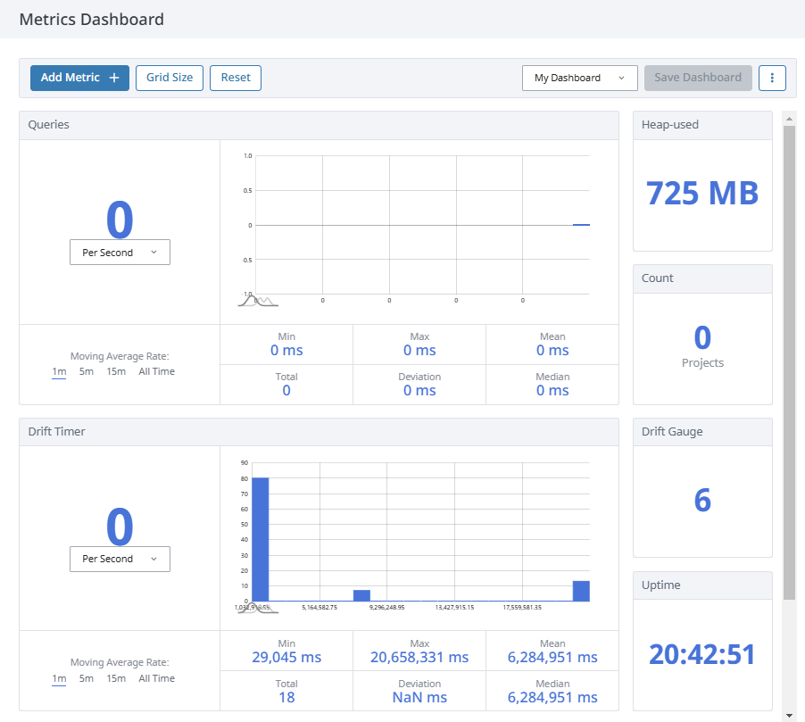

Metrics Dashboard
The Metrics Dashboard allows users to visualize a variety of metrics on their own customizable dashboards. Users may browse and search for any registered metric and add it to a dashboard, expanding the diagnostic capabilities available in the Diagnostics section.
Diagnostics - Metrics Dashboard
info
Some Gateway pages will have an Open Metrics Dashboard option. Clicking on it will take you to a predefined set of metrics related to the Gateway resource page. These metrics are not saved, but you can save them as a new dashboard.

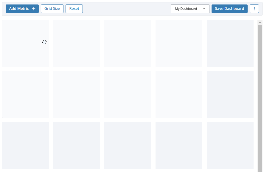

User Interface​
User Interface
The table below describes the Metric Dashboard page's user interface.
AttributeDescription
Add MetricSelect from a list of available metrics to drag and drop onto the dashboard grid.
Grid SizeControl the number of rows and columns on the grid.
ResetClear all metrics tiles from the current dashboard.
Dashboard DropdownSwitch between saved dashboards.
Save DashboardSave the current dashboard as an option. changes, rename a saved dashboard, or delete the current dashboard.
Three Dots Menu Allows users to rename the dashboard, save the current dashboard as new, clear the current dashboard, or delete the current dashboard.
note
You can create multiple dashboards by using the Save as New option in the three dots menu. To switch between them, use the Dashboard Dropdown on the top right of the page.

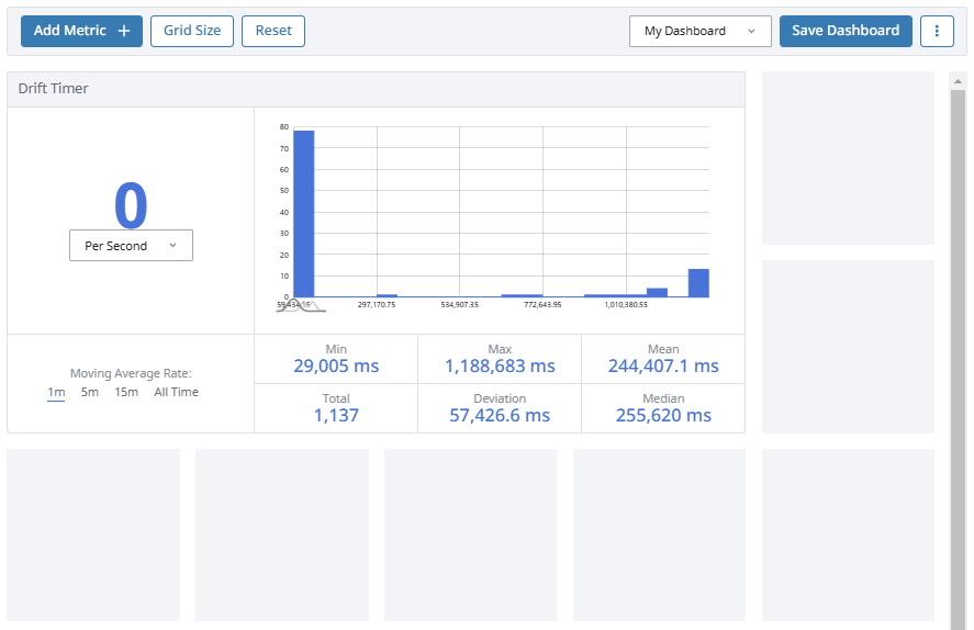

ClockDriftDetector​
MetricDescriptionSizeType
driftGaugeThe most recent clock drift, in milliseconds.1x1Gauge
driftTimerA timer that tracks the distribution of the duration of clock drifts.4x2Timer

  1. Click Add Metric.
  2. Select a metric from the list and click Add.
  3. Hover over the grid to position the metric.
    Adding Metrics to a Dashboard Step 3
  4. Click to snap the metric to the dashboard. To reposition your metric, you can drag and drop it anywhere else on the grid.
    Adding Metrics to a Dashboard Step 4
  5. Click Save Dashboard on the top right when all desired metrics have been placed. If you are saving a new dashboard, you will be prompted to enter a name.
