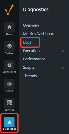

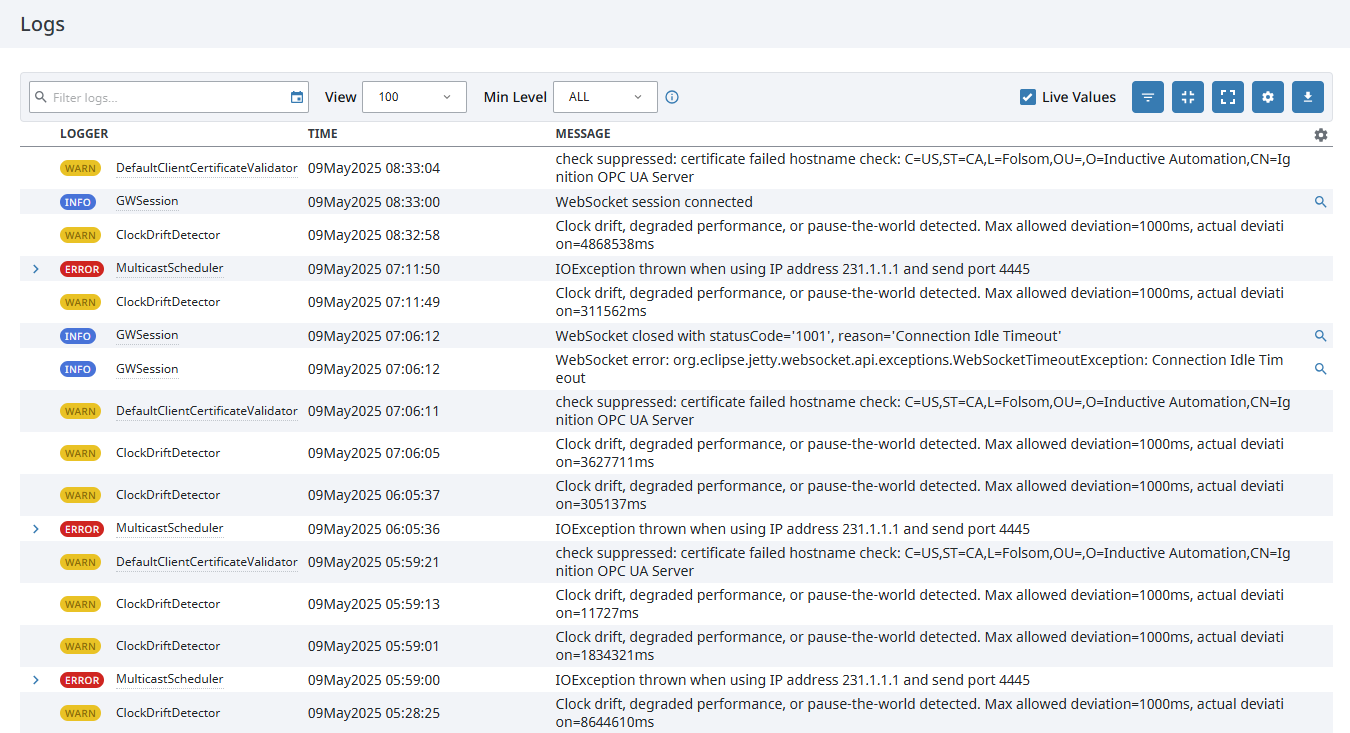

One of the most important troubleshooting tools of the Gateway Webpage is the Logs page. This console shows errors caused by Gateway events like database or device connections, authentication profiles, Alarm Journals and pipelines, and anything else that is Gateway-scoped. You can find logs on the Gateway Webpage under Diagnostics > Logs.
Diagnostics - Logs Section

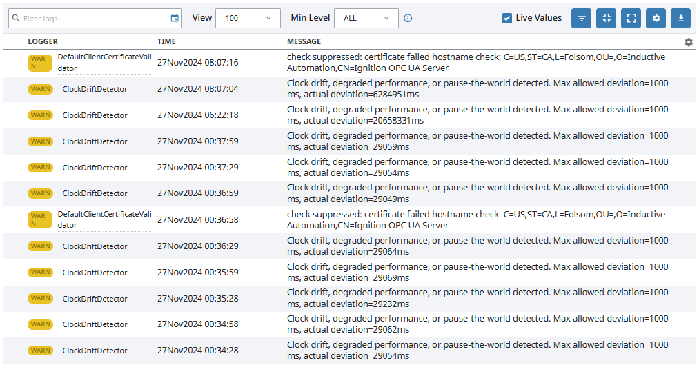

The Gateway Logs also provide a wealth of information about the running state of the Gateway by allowing you to see a live flow of log events in the system.
AttributeDescription
LoggerName of the logger that describes the context of the message.
TimeTime of log.
MessageMessage for the log.
FilterSearch criteria to filter for specific tasks or events. Click the Calendar calendar icon icon to set a filter date and time range. Options are Last Month, Last Week, Last 24 Hours, or Custom.
Min LevelDropdown menu with options: All, Trace, Debug, Info, Warn and Error.
Live ValuesToggle switch to turn live values on or off.

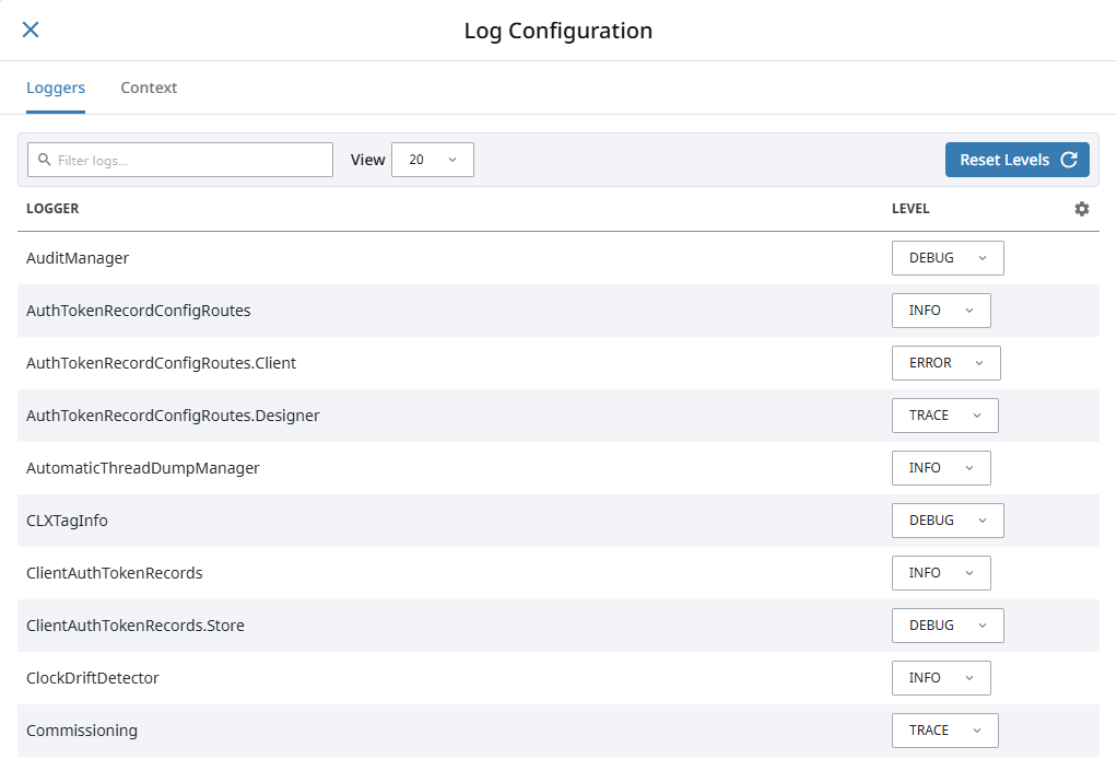

The logs can be filtered by using a search term or by date. For example, you could select the DEBUG or TRACE logging levels, which will cause that specific logger to report more detailed logs, allowing you to better diagnose an issue. Note that if you set a parent logger to a specific level, it will also set all children of that logger to the same level. To change logging levels:
  1. Go to the Gateway's Diagnostics > Logs page and click on the Settings settings icon icon.
  2. Search for the logger name in the Filter box on the Log Configuration popup.
  3. Select the desired logging level from the dropdown to the right of the logger name.

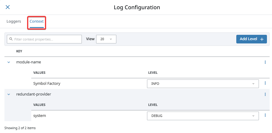

Mapped Diagnostics Context Keys​
Mapped Diagnostic Context (MDC) Keys allow you to quickly set logging levels for all loggers that are related to a specific part of your Gateway. So instead of setting individual loggers to DEBUG, you can use MDC Keys to set a group of loggers to DEBUG all at once.
To use MDC Keys, click the Settings settings icon icon on the Logs page and navigate to the Context tab. This is where all existing MDC Keys will be displayed, and where new ones can be added by specifying Key-Value pairs that match a particular system.

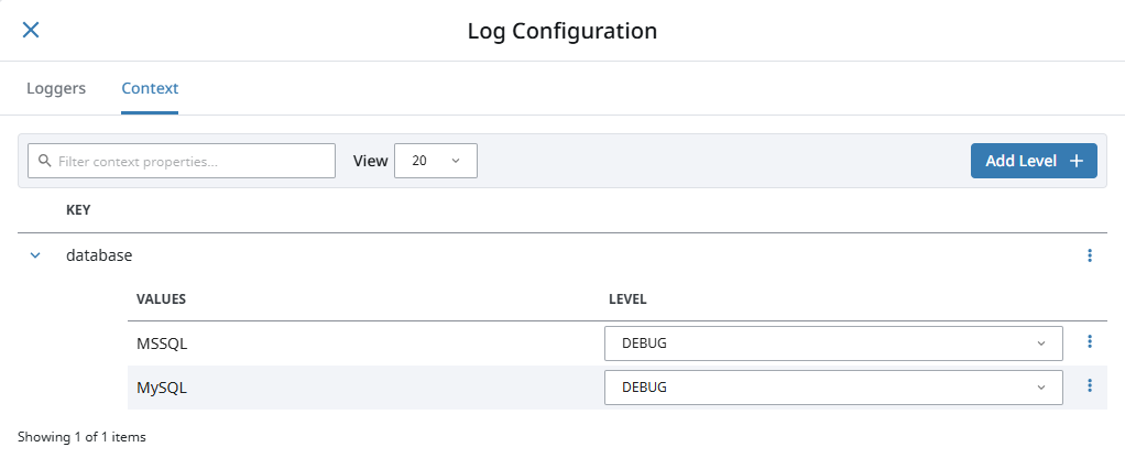

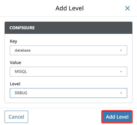

To add an MDC Key:
  1. Click on Add Level +.

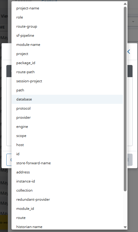

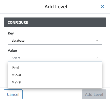

  2. Select the Key field and pick a Key from the available list of Keys for your system.
  3. Select the Value field and choose from the list of values that relate to the selected Key.
  4. Set the appropriate logging level in the Set Level field, typically either DEBUG or TRACE.
  5. Click Add Level.
You can add as many Keys-Value pairs as you would like, even with the same Key. This allows you to quickly set the appropriate loggers to find out more information about the system you are trying to troubleshoot. In our example, we first added our database called MSSQL. Then, using the database Key again, we can add in the database called MySQL.
