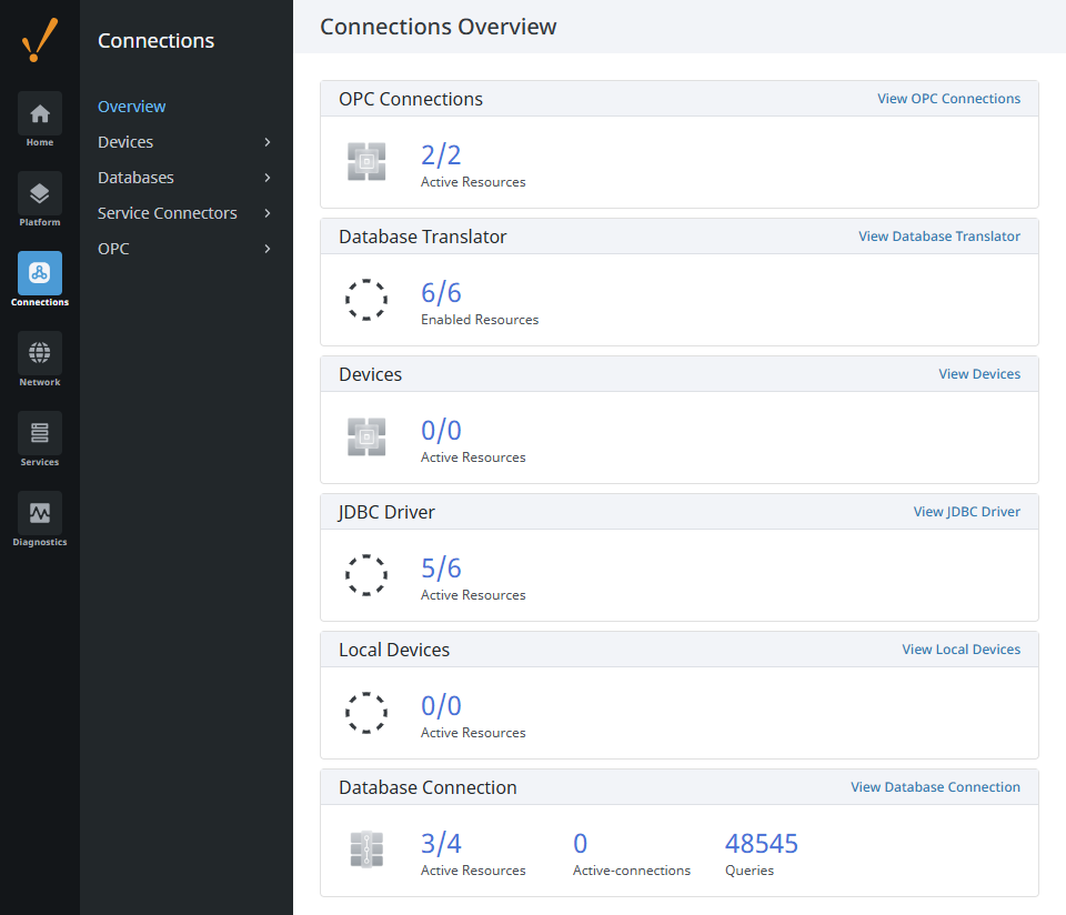

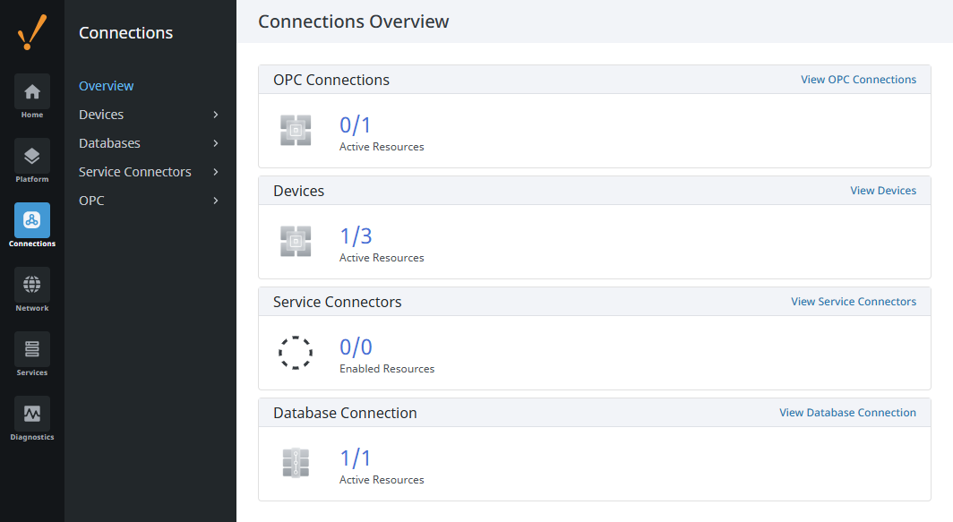

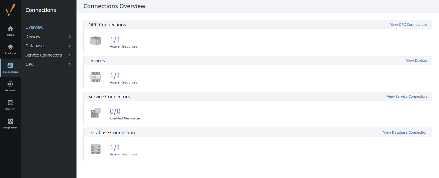

The Connections section of the Gateway contains information regarding Gateway connections to external systems. The list of systems displayed under the Connections section is based on what modules are installed. The Connections section allows you to drill down and open up more specific information to easily find problems with anything connected to the Gateway, and even find crucial information about a faulty connection.
When the Connections section is selected, the Connections Overview page is displayed. This page shows the number of active or enabled resources for the Gateway OPC Connections, Devices, Service Connectors, and Database Connections. Clicking the View link on the right-hand side of each type opens the corresponding page. All connection types can also be accessed from the Connections navigation menu.
Gateway Webpage - Connections Section
