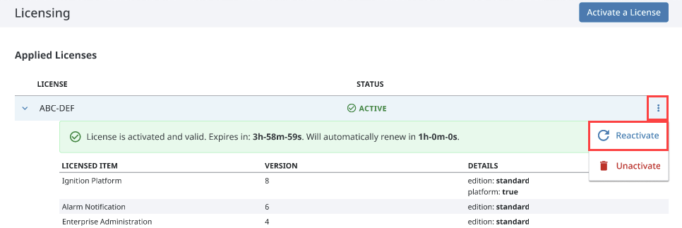

How Do I Fix it?​
In order to fix your License Key, you must contact Inductive Automation. You can reach us by email or by phone and we will walk you through fixing your license. It is usually a very quick procedure that involves you re-activating a license after we fixed your License Key from our end. Once your license key is fixed, expand the three dots menu and select Reactivate.
How Do I Fix it
