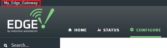

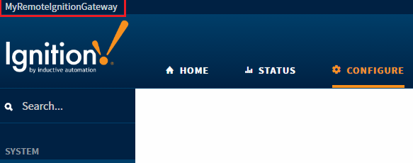

When configuring the connection, note the system name of the remote Ignition Gateway, as you will have to type it in a later step.
If you're uncertain, you can always find the Gateway Name in the upper left corner of the Gateway Web Interface.
System Name in 7.9 for GAN Connections

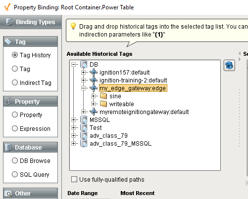

4. View the Synchronized History​
With the history synchronized, Tag History Queries on the remote Ignition Gateway will now be able to retrieve history collected on the Edge Gateway. For example, a Power Table with a Tag History Binding on the Data property could display the synchronized data:
Synchronized History From GAN Display

Once connected, note the system name of the Edge Gateway, as you will need to select it from a list in the next step. If you're uncertain, the system name can always be found in the upper left corner of Gateway Web Interface:
System Name in 7.9 for Edge GAN Connections
