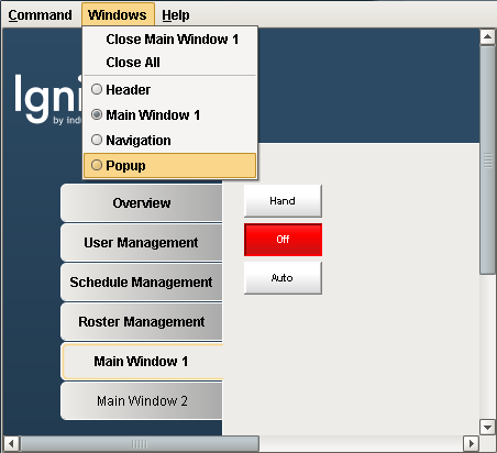

You can locate all of the currently opened windows in a Client from the Windows menu command. It is important to note, this list shows you the Title of each of the windows, not the name or path of the window.

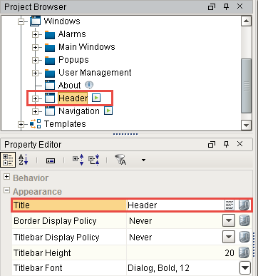

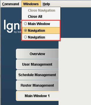

By default, Ignition assigns the Title property the same name as the window type you're creating (i.e., Main Window, Docked Window, and Popup Window). If you notice that you have two windows with the same name in the Window Menu dropdown list, go to Property Editor and change the Title from the window type to whatever you want to call your window (i.e., Main Window 1, Main Window 2, etc.), making sure the Titles are unique.

If your project has multiple windows with the same Title (i.e., both docked windows are called 'Navigation'), you can correct the duplicate Title in the Designer. Open one of the windows and go to the Property Editor, and change the Title property. Once again make sure the Title names are unique.
